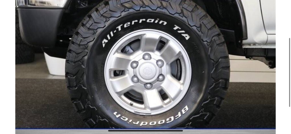

Are these 15 inch or 16 inch? Can’t remember

    15 I believe

    15x7 iirc

    Both.
    they’re offered in 15 & 16 inch

    I did. I havent daily driven my Tacoma in quite a few years, I cant remember if they are 15 or 16 inch.
    And, I am still wondering about the 32's on the 15 or 16's on stock suspension.

    Thanks Ace. I dont believe mine are 16's

    Thanks buddy. 98% sure that they are 15's.

    @Blakeus Maximus you need to specify what you think/desire 32’s to be.
    “Skinny” or “pizza cutter” 32’s (255/75r17) fit in my 2003 after taking a heat gun to the inner fender liner and flattening the rib near the cab pinch weld.
    your wheel size doesn’t matter if it’s the 15 or 16” wheel as they are both 7” wide.
    the tire matters in your equation.

    @JasonLee. I am aware if I run the 32's that Ill need to do some trimming and manipulate the pinch weld. Im not looking for skinny, and Im assuming your reference to "pizza cutters" mean a more aggressive look and an overall a more aggressive tire. So, I guess thats what Im looking for.
    Im just trying to game plan is all. My truck is currently under the knife..

    This is true, but I think the 15" version only came on Tacomas and the 16" version only came on 4Runners.
    Conversely, Tacomas only came with the 15" version and 4Runners only came with the 16" version.
    Ergo, if they're the original wheels on that truck, I'm pretty sure they're 15".

    They are definitely the original wheels to the truck.

    They were original to 2000 and a few years earlier. They're 15". 2001 started 16s with the 5-star type. I have both years and wheels.
