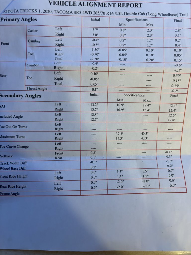

    20240410_185434.jpg How do these look? It is driving straight but giving me some vibes around 55 mph. I just got new tires 265/70 R16. No lift. I think I just need the wheel Balance tweaked.

    Man, I hope you didn't pay for that alignment because they didn't do anything. All the numbers are the same, before and after. And what jumps out immediately are the caster numbers. They should either be equal left and right or slightly lower on the driver's side - by slightly I mean a .3-.5 degree differential, but you've got a 1.3 degree difference and it's the wrong way. That truck should be pulling noticeably to the right.
    Unless your adjustment cams are frozen and cannot be adjusted, and if they were you should have been notified, the proper way to do this would be to max out the positive caster on the passenger side, which on a stock, non-lifted truck should be somewhere around +2.8 to +3.0 degrees and whatever that number ends up being, and it doesn't really matter if it's a couple of tenths one way or the other, and then the driver's side would ideally be, say +2.5 to +2.7. Remember that the vehicle will always want to pull toward the lower caster side. The camber and toe look fine.
    I would have the alignment issues addressed, and not by the place you went to and re-balance the tires and see what happens.

    Thank you so much for the response! Thankfully, the "alignment" was free with the tires. Sure I got a great deal on the tires but I could tell the place was short staffed and very busy. I am not surprised that they half-assed the alignment.
    I will see if I can get in to a more reputable alignment shop ASAP.
    Thank you again! That is great info!

    Well, if it was free then you got your money's worth, but jeez, they didn't do anything. Did they even put it on the rack? I'm surprised they had the balls to actually give you the printout but maybe not since most don't know how to read and/or interpret them. Another example of why just having all the numbers in the green is not a good result.

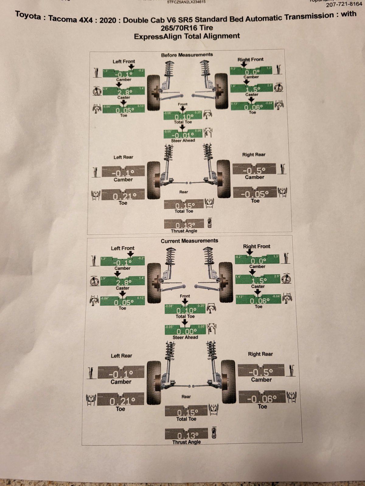

    How’s this for alignment? From the front kind of looks off. Trd sport premium on 3” lift with 255/80/17 tires.

    Amazing for a 3" lift to get that much caster. I'd be thrilled. Do you have aftermarket upper arms?

    Yes I have spc adjustable control arms.
