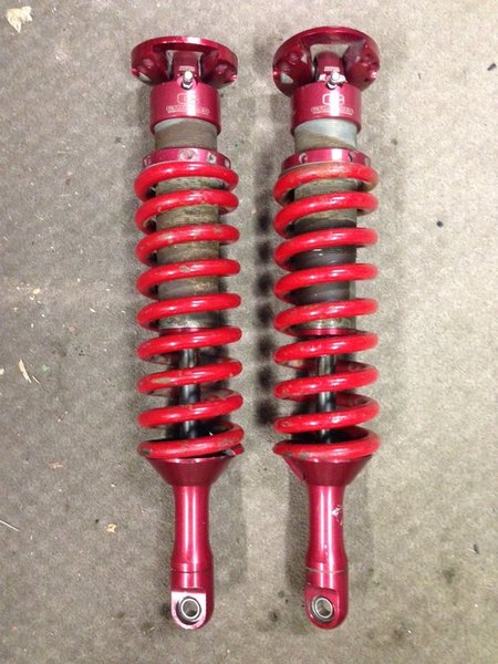

    I helped a buddy of mine take some old coilovers off of his truck last year and he said he had a 2009. He ended up giving them to me and I sold them on here to another member. Recently I had to buy these back from the guy I sold them to because he tried to install them on his 2006 and they wouldn't fit. He said he called Camburg and they said these were for a 1st gen. He had them rebuilt by DC Shock Services, so I had to pay him for that. I am looking to resell these, but want to make sure they fit a 1st gen before I list them.
    Thoughts?

    Those are definitely not for a first gen. These are first gen Camburgs...
    Sounds like the guy didn't know what he was doing when installing them. They should have fit his second genimage.jpg

    Ya they are definitely for a second gen.

    The guy who bought them does know they go in a certain way right? Large spacer goes to the rear....?

    Hi, I'm the guy that bought them. I actually ended up taking them to a shop and having them try to install them since I ran into problems on my install and needed it done soon. They called a me while I was on vacation and said they couldn't get them to fit. Mentioned that the slots on the top didn't fit the bolt pattern on the strut mounts at all. So I sent a picture of them to Camburg and they (Carlos) said they were definitely 1st gen.

    The only think I can think of, is someone might have re built the upper uni ball and replaced the top mount with a first gen mount. The actually body of the shock though is definitely for a second gen. I'd call Camburg and ask them for replacement top mount plate for a second gen.
    The one that's on there now looks identical to mine. Which is a first gen

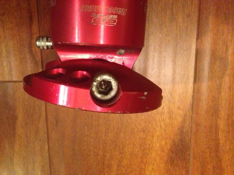

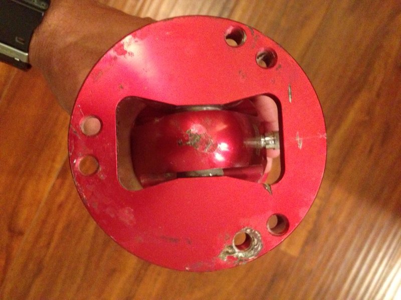

    Here are pictures of the top plate. Camburg said the only difference between the first and second gen coilovers is the valving, which is untrue because the bottom shock mounts are different.
    Thoughts?

    Uh why is there so many holes in the top cap? Looks second gen to me

    Could be mounting holes for Tundra's.
    On my Dirt Logics, which are essentially Camburgs which are essentially all Sway A Way's I had to mount the schreader valve facing inward as that is they way the holes would line up. You could take the top plate off and rotate it, but thats a pain in the ass. NOW the lower mount is for the 2nd gen. You can, however replace that with a shorter one from Sway A Way. You just heat up the lower mount with a MAP gas torch and unbolt.

    That's 100% a first gen top cap. It's definitely been switched

    As far as the pictures you posted here .... the shock body looks to be a 2005-15 Tacoma since it has the long rod end on it. You didn't email us that pic. The top mount appears to be the a 96-04 and 00-06 Tundra top mount since it has 2 bolt patterns machined into it. That's how sway-away made those top mounts, same part fits 2 trucks. It's hard to give exact specs from pics since you have no way to verify true dimensions.
    I would email or call Eric at Sway-Away since they have blue prints on all that stuff, they've made revisions throughout the years on those parts. Have no clue how old these are.
    eric@swayaway.com
    Did shock re-builder install wrong or other customers mounting plates back on the shocks after they were fully taken apart and rebuilt?
    If none of those bolt holes lined up in any orientation/rotation than it's not the right one and would have never fit any 05-14 models.
    Make sense?
