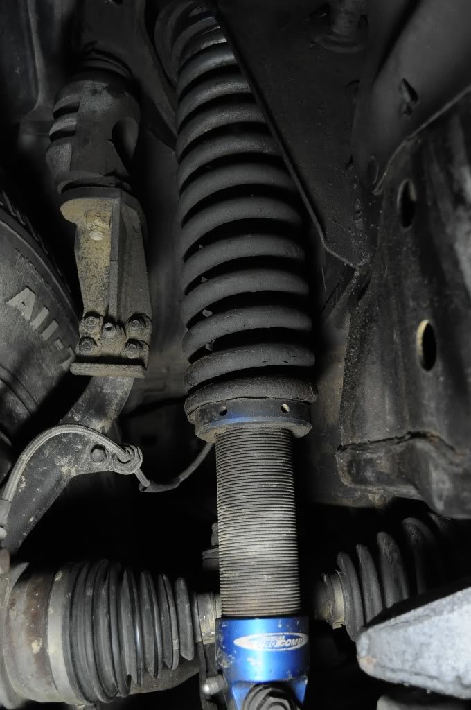

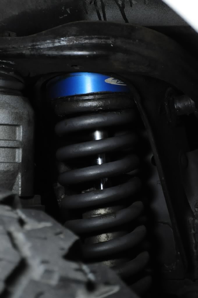

    I bought my Takito super cheap off craigslists and im wondering if these coilovers are good.
    I also wanted to know if my truck has a body lift or Suspension lifted
    Thanks ya

    Looks like a procomp stage 2 drop bracket suspension lift.

    Cant say about the CO's but they look like their leaking.
    Also, Im thinking you have all suspension lift and no body.

    I don't know, I might be wrong but they look really greasy/oily. If they are leaking, it would be the seal where the shaft goes into the shock body, I think.

    LOL Oohh maybe because i put a lot wd40 cause Takito was sqeaking like a loud bitch,
    but it wasnt the COs

    yep, looks like a Pro Comp drop bracket lift...
    the coilovers are ok... you might want to get them recharged or even rebuilt... assuming they can be rebuilt...

    Where can i get them recharged? I took all the air/nitro out ;) i dont why :eek:

    oh damn, you emptied them?
    a lot of 4x4 shops can recharge them for you...
    i think there was a thread recently about so cal shops to recharge shocks at....

    I would take an air compressor to them for now until you get them recharged. They will start leaking internally and externally if you drive to long with out having some air in them.
