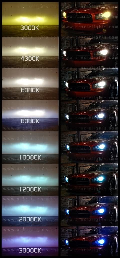

    6000k and 8000k are simply the color rating, and the lights get less bright beyond 5000k, so 8000k will actually have less light on the road than 6000k, which will have less light on the road as 5000k HID bulbs. see below for a k (kelvin) scale.
    if you want something just a little better than stock, check out some phillips xtreme power bulbs. ran them for a few years. slightly bluer and brighter...and you wont get all the crappy glare from the PNP kits from slimchubby, DDM, etc...

    First plug and play HIDs are illegal. If that does not dissuade you we can move on.
    8K is less bright than 6K optimum brightness is at 4300-4700K. 5K is 10% less output. 6K is 33% reduction in output. 8K is even less... it gets exponentially worse as K temperature rises. Also glare is increased in haze, fog, or rain above 5K.
    Projector headlamp bulbs like a DS2 are significantly higher output from the start, even for the same color temp vs say an H1 or H3 Xenon bulb. 8K plug and plays are just not a real good idea. You get suboptimal (and illegal) beam pattern distribution and significantly lowered output over a propper 4700K projector that has all OEM parts and is not illegal.
    The only reason 6K+ lamps exists is because people see the artifact of projectrs where the light is refracted and some of the color spectrum is lost on the edge. This leaves a blue to purple line at the top of the cut off. It is a purely negative aspect of HID projectors that is inherant to the design. If manufacturers could eliminate it they would. This causes people at the edge of the beam to see it as a blueish or purplish headlight color. The light itself is the propper 4700K as that is what is brightest and makes the most sense from a viewing perspective of the driver. Its just the bad ege that is purple. People often try to make this ege more blue and larger, reducing the area of quality light that can be used at the edge of the headlights range. A reall silly and backwards idea from a utility perspective.
    So you get ignorant people trying to look like projector assemblies by making the whole beam a blueish color. Not only is this counter to producing the most usable light they are in fact trying to reproduce the NEGATIVE inherant color shift line produced by an HID projector. Its a pure poser and ignorance thing when people get 6K+ colored lamps.
    The Tacoma does not have an especially good beam pattern distribution when using illegal HID kits in the halogen reflector assembly. Its not especially horrible either as far as those things go. The reason the beam pattern is never perfect is becasue the light source never matches the halogen filament in size, shape, etc. so the reflectors are not at the propper angle. Its like putting on someone elses glasses... you just cannot see perfectly unless the glasses (reflector) are matched to your eyesight (the bulb or lightsource).
    Id suggest a projector retrofit and 4700K bulbs. You get the most light, you get the best beam pattern, and its not easy to prove its illegal like a plug and play KIT. Its also the most expensive option unfortunately.
