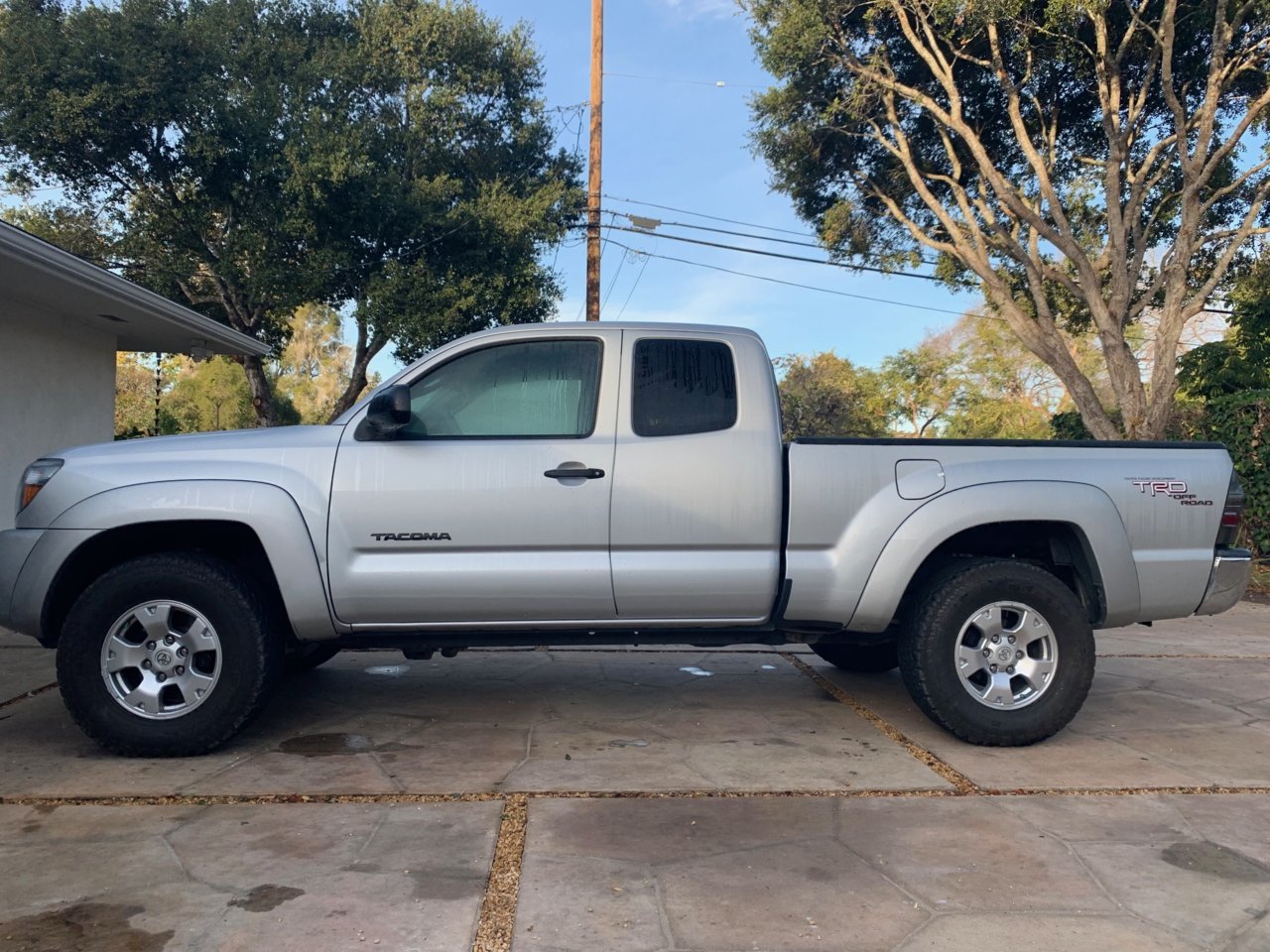

    Thanks everyone for the feedback, definitely helped clarify how the leafs should look on these trucks.
    I finally got the front billys done, decided the leafs were fine based on the feedback. They're not quite on the overloads yet. Fronts set to 1.75 with stock TRD coils, and I ended up high in the front. Come at me BRO! lol. Now I need to decide if I want to do AAL and get a 1" rake, or just find 0.5" blocks. Worried about blocks though if the leafs are already a bit worn, but would 0.5" really stress them too much?
    Ride Height Before After
    Front Driver: 20 1/8 22 1/4 (+2 1/8)
    Front Pass: 20 3/8 22 1/2 (+2 1/8)
    Rear Driver: 21 3/4 21 3/4 (+0)
    Rear Pass: 22 1/4 22 1/4 (+0)
    So the front sits 0.5" higher drivers side, and 0.25" passenger side.

    I have the bilsteins on with 2in lift front and a 1 inch block + 2 inch aal. Aal is the way to go gives you more load capacity if you ever haul anything heavy

    Right on, I haul camping/fishing gear often, every now and then a scoop of gravel or compost or whatever. I think that's the way to go. Which AAL did you get?

    Got a set of aal off of installed em and gave me 2inchs of lift. Their reasonably priced too 77.50 for the set. sideshttps://wheelersoffroad.com/wheeler-s-off-road-2-lift-add-a-leaf-set-for-2005-toyota-tacoma.html

    Will a 1.5 or 2" AAL added to the TSB be too much for the rear 5100's?

    Bilsteins are made for up to 2.5in of lift and I have 3in with no problems, it actually rides better with the lift honestly
