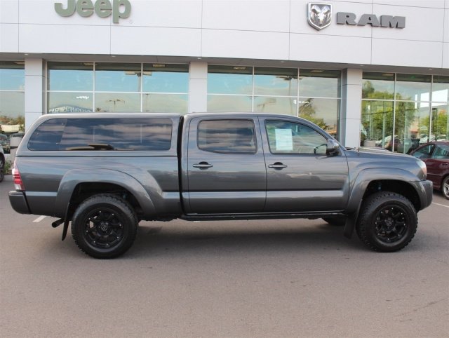

    On my first ever tank of gas in my 09 dclb trd sport. just hit the 1/4 tank left line and ive gone 210 miles. i assume ill get anywhere from 250-280 out of this tank which puts me around 13 mpg. Question is on my truck specifically with the shell and 265/70/17 bfg ta ko's and 17x9 rims, are these things hurting my mileage?
    I came from a crew cab silverado 4x4 and was getting 12.9 mpg doing the exact same route im doing with the tacoma.
    How many miles are you guys getting out of your tank?

    Hi, I have the same size wheels and a shell on my 4 door TRD Sport 4x4. I average 17.0 MPG with all around driving....keeping rpm's under 2,000 rpm at all times. I find that my fuel mileage really goes south if I go over 65 mph.
    I took about a 1.5 mpg hit installing a shell and the 265/70/17 wheels.
    For total tank mileage, I normally see my low fuel light come on at about 280-300 miles. You have 3 gallons of reserve....I always allow 30 miles past the moment the low fuel light comes on.
    A typical tank for me is about 320 miles before I fill up....and yes, I have an OBDII reader and have done quite a bit of research to pinpoint what my truck is capable of as far as fuel. If you ever really need to get mileage out of her just slow to 55mph and you can get 50 miles past the low fuel light.

    Shell is more weight, so more effort from the engine to get you up to speed, so yes, it's hurting your MPG's
    The more aggressive the tire the more rolling resistance and the more effort from the engine, so yes, they're hurting your MPG's.
    But, 13 seems excessively low. I never averaged lower than 17 with Duratracs on my '10 AC 4x4, but without a cap.
    But, the difference with these trucks and shift points is huge. If you're light on the gas & let the engine shift around 1300 RPM's or less you can get 2-3 mpg's more than if you let it rev to 2000

    1) Do the math. Quit guessing. It's not hard.
    2) Don't reach any conclusions until you've run a few tanks and averaged them together.
    3) If the diameter of the tire is larger than OE, your effective gearing is changed. Your speedo reads lower than you are driving, your odo registers lower distance. Making your math wrong. Figure out the correction factor and see #1.
    4) If the wheel/tire package is heavier than stock, yes, it hurts. Unsprung wt is the worst, as it affects acceleration, braking and handling. If there is more footprint on the ground that's more rolling resistance.
    5) Any weight, including yours, gear and topper, negatively impacts MPG and a host of other things.
    6) If you bought the vehicle for MPG, well, that's what other choices are for.
