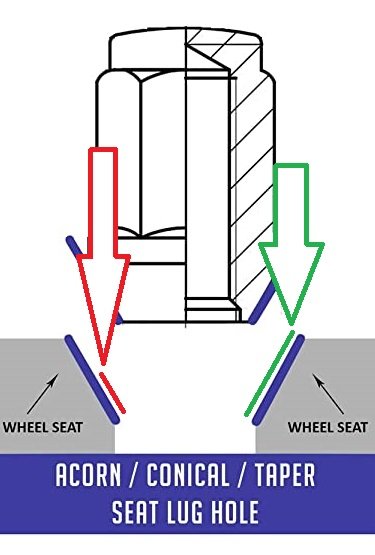

    I have attached a picture for illustrative purposes;
    My worry is that my original lugs (represented by the green on the right) have full contact with the seating area while the new lugs (represented by the red on the left) will only contact half, if that, of the seating area.

    My point was your spline-drive lugnut still has a much broader tapered area than the OEM shank lugnuts, so you'll be fine.

    I understood your concern...
    Basically, full or half engagement of the lug seat.
    In general;
    Regular taper are for steel wheels.
    Bulge taper are for aluminum wheels which usually have a wider/deeper seating area.
    You have a tuner/spline lug nut with regular taper.
    Another concern would be how the your new interface might affect clamping force.
    Of applied torque;
    50% is used to overcome nut-to-wheel friction
    40% is used to overcome thread friction
    10% is actual clamping force.
