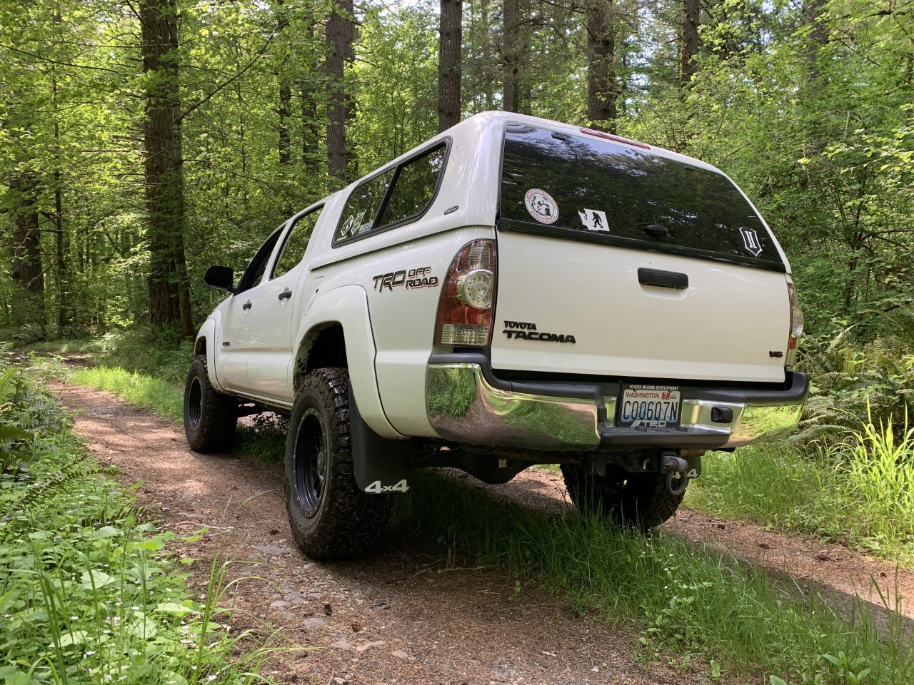

    I have had them on with my Icon Alphas for 3 years or so with no issues.
    You should be fine.
