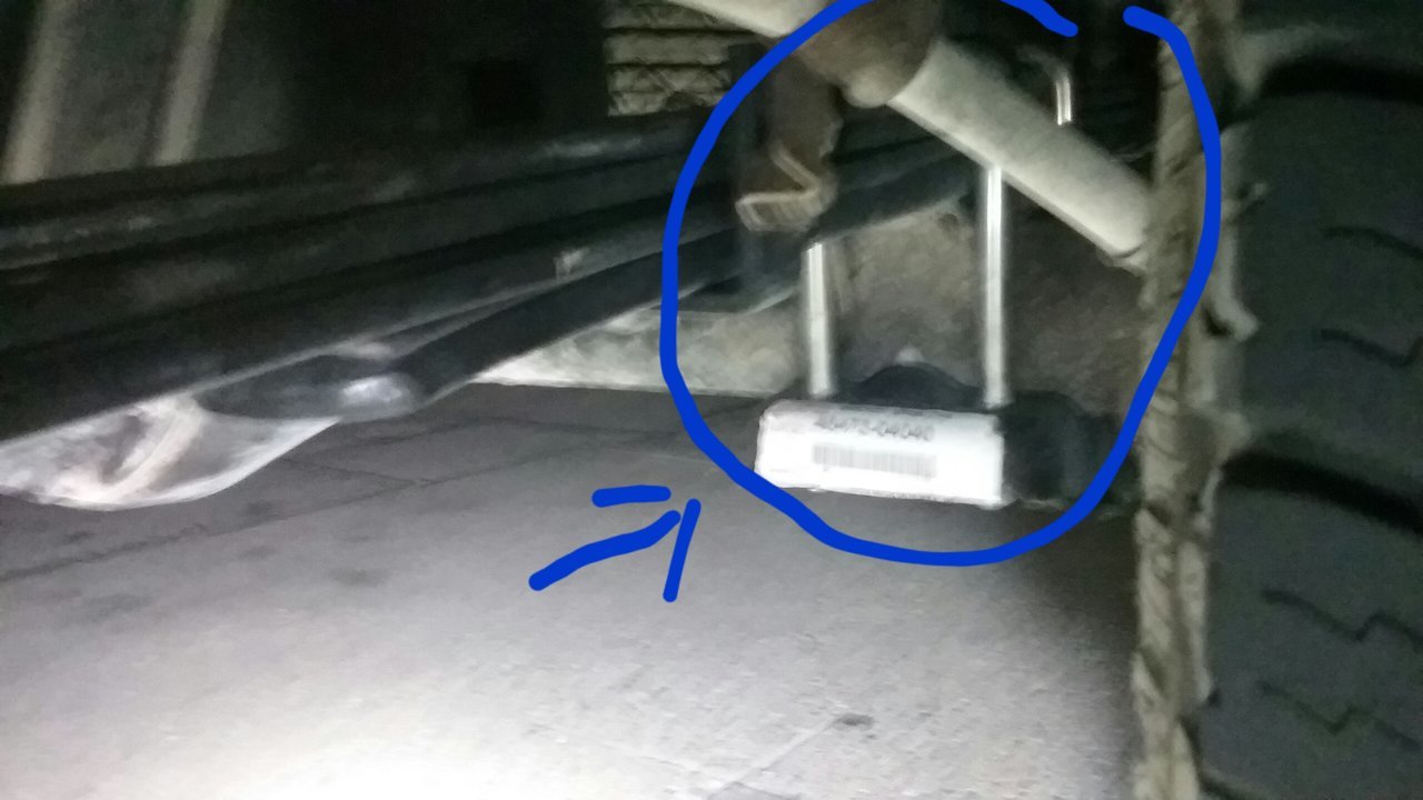

    I look at the leaf springs and see these on my truck, I don't know if they are supposed to be there or not. I'm not that car savvy , but never saw anything like this before. They are called bracket stabilizers?
    Are they supposed to be there, or did I get seriously screwed.? Could these being left on cause any damage to my truck ?

    That looks like a spacer block to me. Do you have a lift on the truck?

    Normal. Might want to check the torque on the ubolts though.

    Those are definitely just U bolts and the bracket that holds them to the axle.
    Drain plug, check your oil level, top it off

    Throw a torque wrench on them, 80ish

    No harm in being concerned. From top down you have your bump stop, the leaf pack, shiny silver guys are the u-bolts, and at the bottom is the mount plate.
    Make sure the 4 nuts at the bottom (on each side of the truck) are tight. 80 ft lbs.
    Check the level of your oil, top it off, and be on your way. Just avoid that dealer if possible.

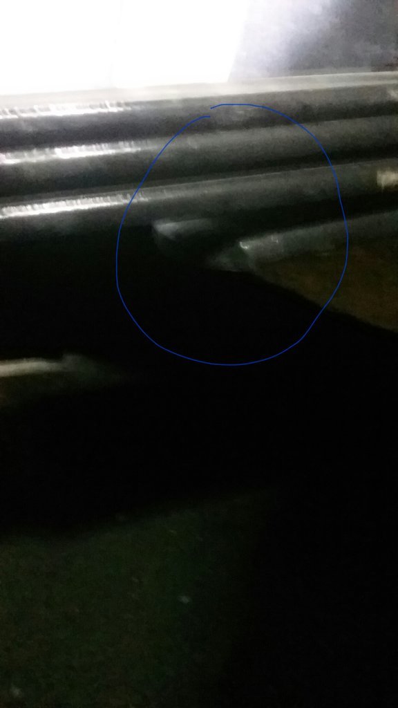

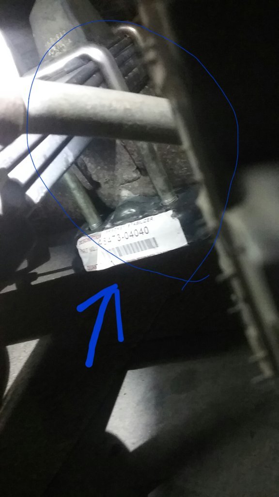

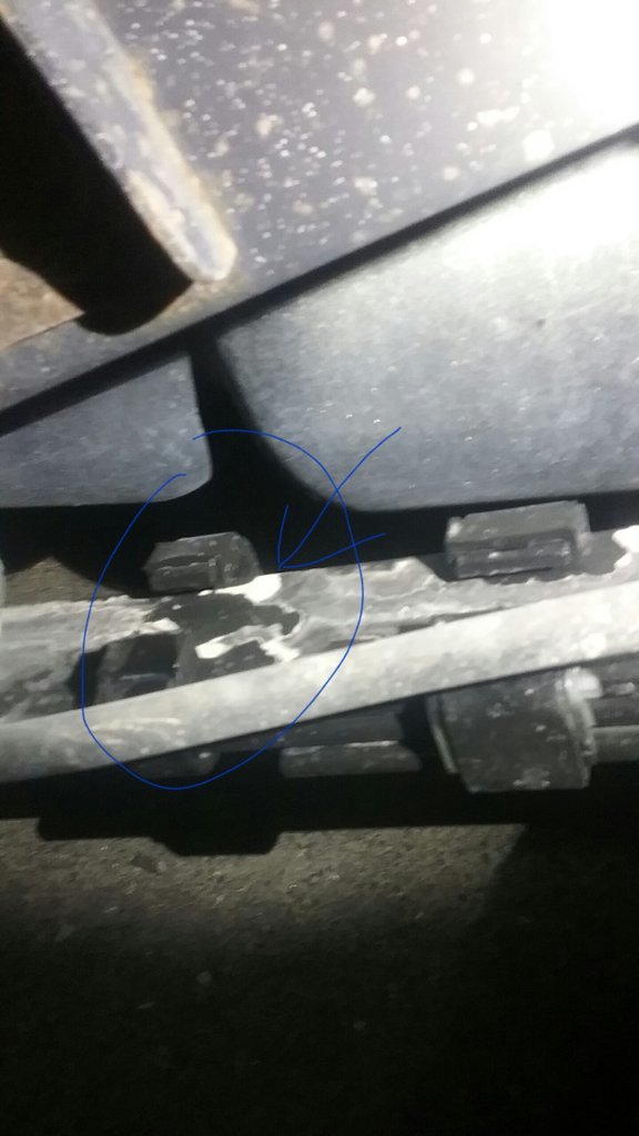

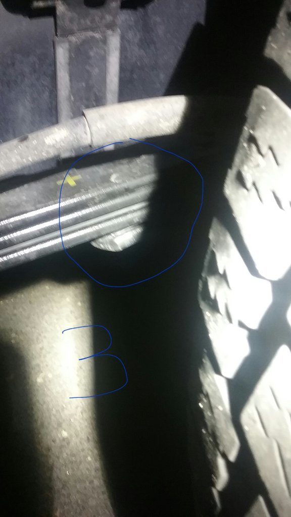

    There is also about a half inch gap in both of these spaces..
    Is this also normal ?
    Also, on picture three where there is the half inch veritcle gap.. there also appears to be some horizontal off set between the leaf springs. Would that possibly be caused by being driven with the brackets loose?
    Sorry for low quality pictures

    You're fine.

    It all looks perfectly normal.
