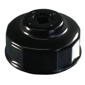

    Curious, do you guys suggest any specific tool to change the oil filter? How do you guys go about changing the filter? I just crawl under my truck and its a royal PITA. I would prefer to use a cheap affordable tool.
    Do you all just crawl under your Trucks, or do you lift it up somehow to give yourself some work space?

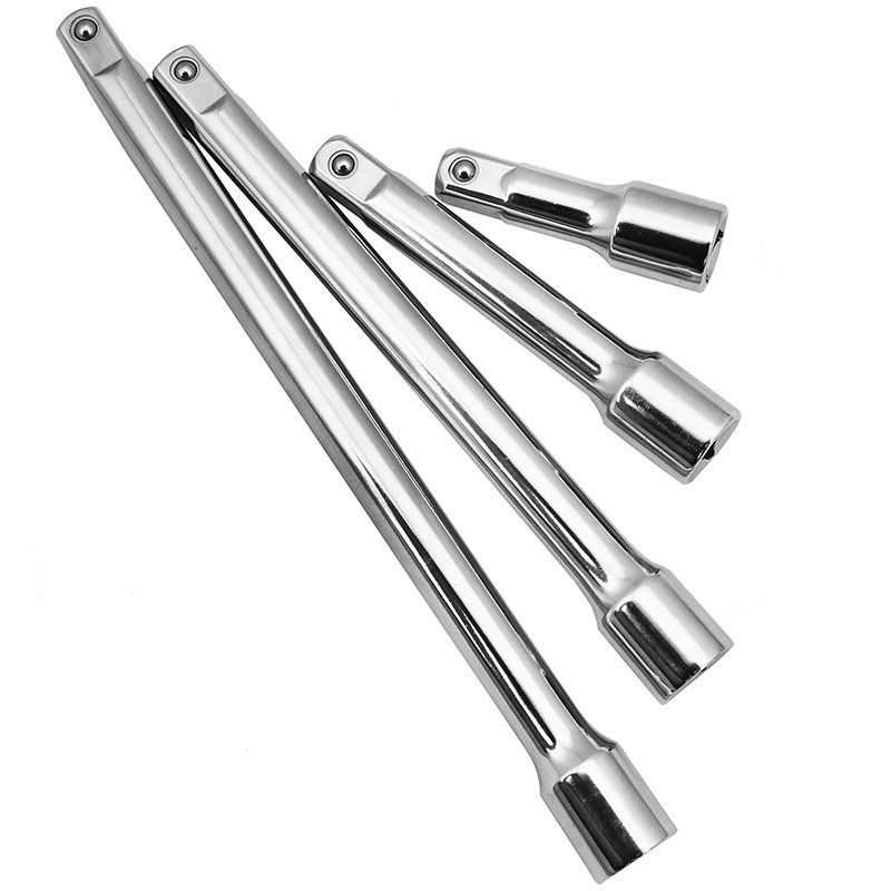

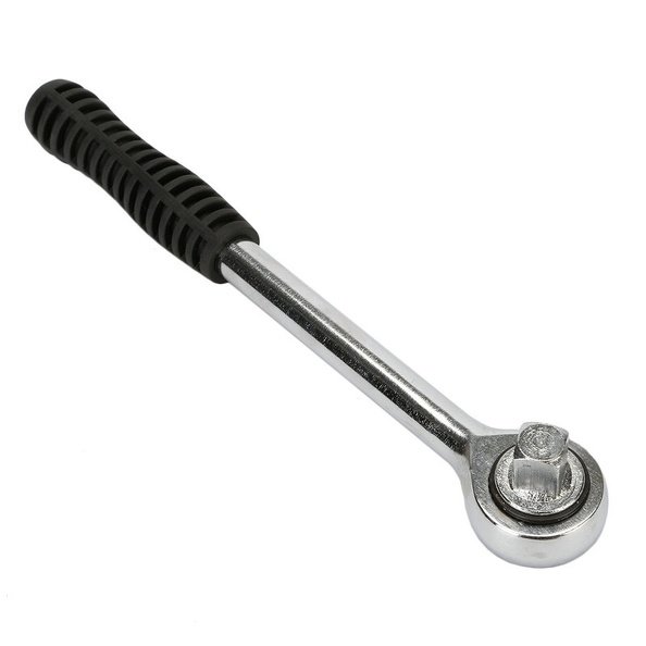

    My 2008 Tacoma is a V6 (4.0 engine) and the oil filter is very easy to change out and install quickly, without all the mess. Reason being it's location in right on top, in front of the engine within short reach.
    But my daughters 2012 Tacoma is 4 cylinder (2.7 engine) and yes the oil filter is stuck up under the engine (why Toyota designed it this way is ?)
    When changing the oil on her Tacoma, just crawl under and after I remove the oil pan drain plug (to drain the old oil) then I first loosen up the oil filter slightly (use two extensions one long & one mid size and of course the proper size oil filter tool) so that I can remove it with my hand. Use a plastic store bag and with my hand covered (using the plastic bag) I slowly unscrew and remove the oil filter. If oil drips or leaks out (and it will) at least the plastic bag will catch most of it. Slowly bring the oil filter down (don't invert it cause you'll have oil every where) then dispose of it.
    Once all the oil is out of the oil pan and your ready to re-install the oil drain plug, take the new oil filter with you and once your under your truck install both. Don't over tighten the oil drain plug or the oil filter, just snug enough.
    Here's a quick tip, before you start changing the oil, flatten down a card board box to put underneath the engine when changing the oil. Do this so to protect your driveway's concrete.
