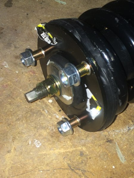

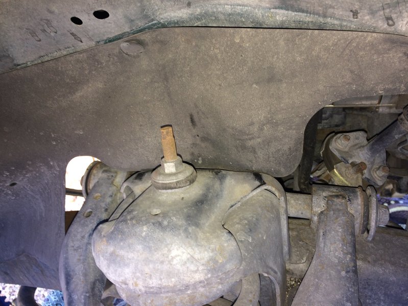

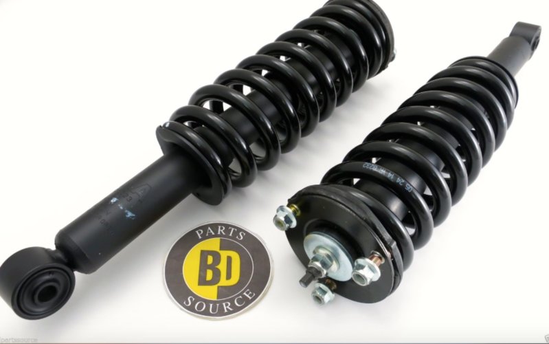

    I purchased these front shocks and coils for my 1999 base tacoma, making sure to select the right year and model. (See first photo.) The shocks I received have three smaller bolts on the upper boot. My tacoma doesn't have holes for the three bolts; only one hole where the main shock pokes through. (See photo of my top shock mount.) Are these the right shocks? If so, do the 3 bolts sit under the top boot mount?
    shocks new.jpg New shocks purchased
    IMG_2181.jpg Top of new shocks
    IMG_2171.jpg My top boot mount - only one hole for main shock bolt

    Looks like you have a 5-lug 2WD Tacoma, and the shocks you bought are for 6-lug 4x4 models.

    You're absolutely right. I'll exchange them for a 2wd set. Thanks.

    Remember theres a 2wd 6 lug model aswell so read carefully.

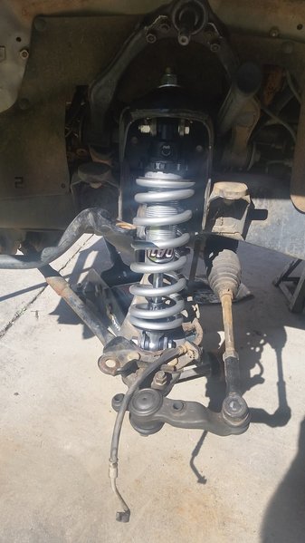

    98 rwd tacoma
    I couldnt find anything or any mechanic that could help so i did this
