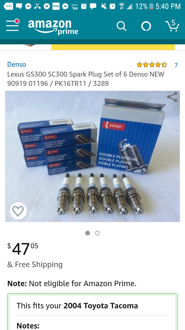

    Are these the right spark plugs
    Screenshot_20190905-174039.jpg I'm trying to find the best and also is the price okay

    Is the 3.4 an interference motor? The P in denso plugs stands for a projected electrode meaning that the sparky part sticks out of the threads... otherwise they're the same plug

    I will certainly defer to your first-hand knowledge. Found this cool cross-reference site, and those P plugs are definitely NOT the same:
    https://www.sparkplug-crossreference.com/convert/DENSO_PN/K16TR11

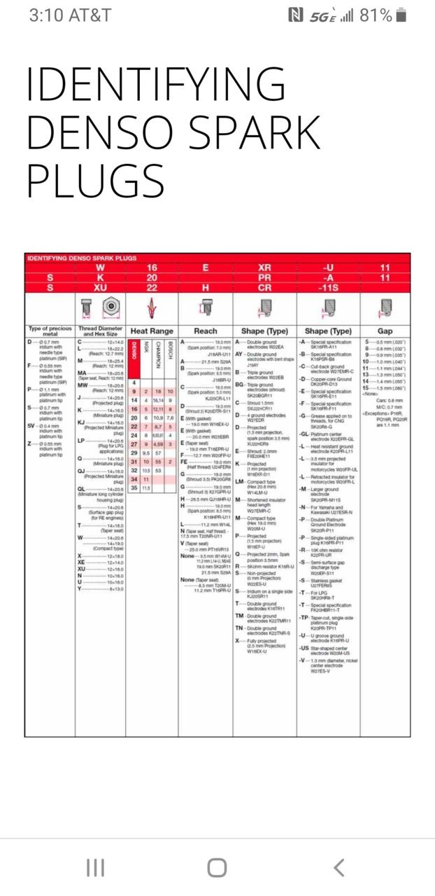

    I would like to eat a full serving of crow and admit I was wrong before anyone blasts me. You were correct, if the P is at the beginning of a denso part number it means platinum... but if it has a P in the middle it means projected.

    Just found this chart to correct myself
