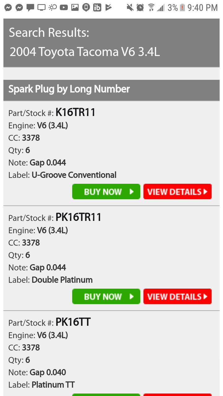

    I look on denso web site and got this

    Well, there you go, they should probably work fine. I'm partial to the NGK plugs, not really sure why.

    I looked into the breakdown of those plugs further last night.. they are a cross even though that sparkplugcrossreference website said they aren't. The actual dimensions on the threads and the plug reach/seating config are the same, the only difference is the material they're made of

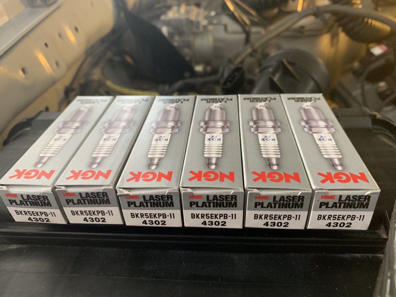

    I second the NGK recommendation. I have used them in all my Asian vehicles for many years. Never had an issue. Got some stupid nice ones for the Tacoma.
