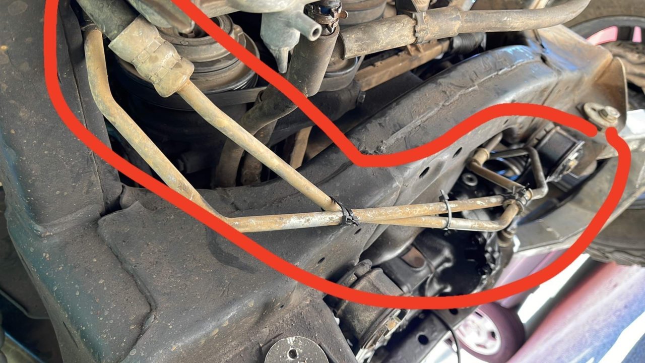

    Have a 01 Tacoma, these lines are rubbing on the cross member and I need to figure out the exact part number to order so I can replace. Guy before bent the lines and won’t go back into its proper place. Please help out

    They may be power steering. Have you traced them back to where they go?

    No.
    Those are power steering lines.

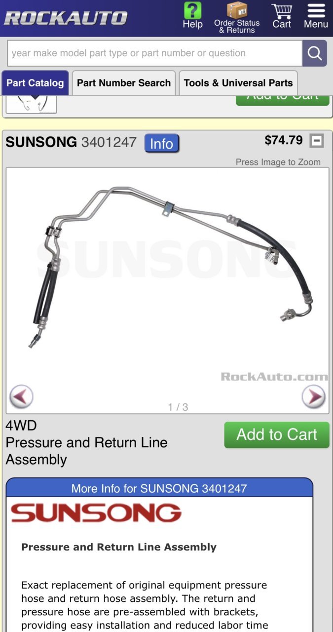

    Rock auto has what you need. They come with new brackets also but, you’ll have to reuse or replace your bolts. You’ll need new copper crush washers where the lines mount to the power steering pump.

    Well I’ve been using this one with no problems although the center bracket was installed backwards just had to flip it around.
    A buddy of mine used this same one couple years now no problems.

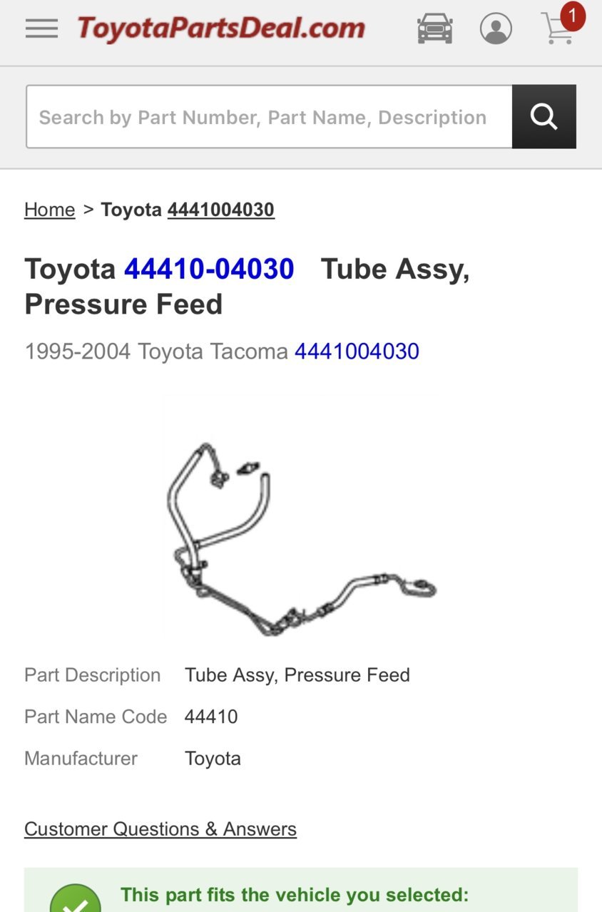

    Here’s the Toyota one it’s over $400
