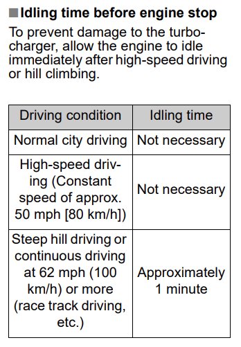

    So water is circulated to cool it even after the truck is off, at lest for a few minutes? But you still need to idle for a few minutes to cool the oil right?

    Owners manual says one minute if you've been continuously driving at high speed or steep hill driving, otherwise not necessary. So chill a minute at that interstate rest stop or scenic view pull off at the top of a mountain, otherwise the low speed driving between the highway and your stop should let things cool sufficient.
