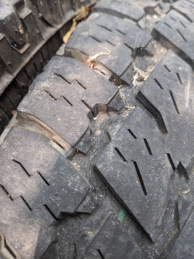

    Found a set of almost new tires but it seems they are a little bit Cracked/rotten, but I might be wrong and its regular Normal wear and tear. They are not rotten/cracked on the sides, just between the thread.
    Picture attached!

    My theory is if you can mention cracked and rotten in the same paragraph as good deal, it’s probably not.
    might be good for some spares though

    Well, I'm not sure if that's actually cracked or rotten... I see some wear but not sure if that's normal... But thank you.

    If my tires had that cracking between the treads I would be saving for a new set ... I would never buy them like that no matter the price

    To more directly answer your question, yes that wear is "normal" for 5+ year old tires that have lost all of their rubber's grip and are on a ticking countdown towards becoming a blowout hazard.

    Check the date codes on the tires.
    Anything older than 2015 should be avoided.
    Also check the date codes on the new rubber. You want these as young as possible. If about 1 year old, ask for a more recent date code on a set.
