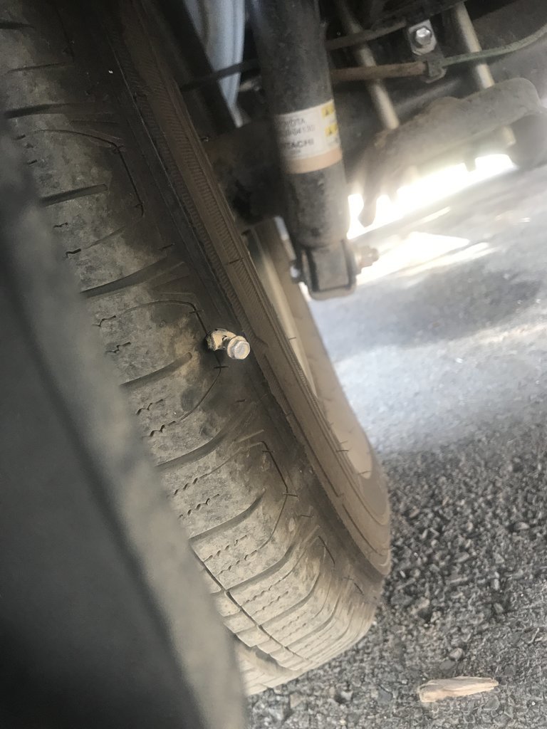

    x2 for switching in the spare. Also talk with the guys at the tire shop and they'll let you know if its repairable. You could even mention that it'll be a dedicated spare after the swap.

    This. Would you really feel right about claiming a warranty issue due to a screw in your tire?

    If they repair it, it'll definitely hold air. I think the worry/liability is the repaired tire blowing out while driving down the road. Sidewalls on a radial typically don't have as many "plys" as under the tread and don't take a plug/patch as well. At least in my experience.

    I got you. "They" is normally me when it comes to plugging a tire. I don't always do as good of a job. They probably take off rim and patch the inside too.

    Yeah I think they use some type of Hybrid Plug/Patch that goes on from the inside,

    jeez guys I understand it's not the factory's fault but I heard of people getting their tires replaced under "warranty" at the dealer it just wasn't factory warranty and that's where the confusion was at. Lol

    At very most I would make that a spare. Put spare on ground.

    Too close to the side wall to be repairable. Reputable tire shops won't repair that for good reason but I'm sure you can find some shady shops on the south side, or whatever the shitty side of town is in your city, that will.

    They might give you a new tire at a pro rated cost.
    I know the big tire shops here always have that as a warranty option, if its damaged beyond repair they just give you a new tire at a reduced price.

    I really hope you're not advocating plugging a tire in that location. That is the flex zone, definitely not safe and certainly not a permanent fix.

    This is the best reply. I would use the spare tire for sure.
