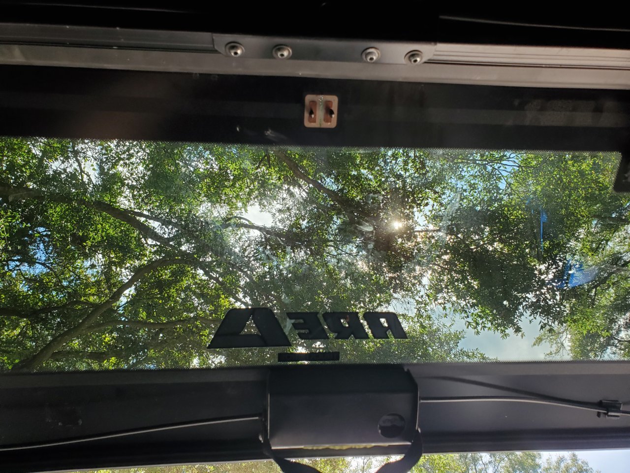

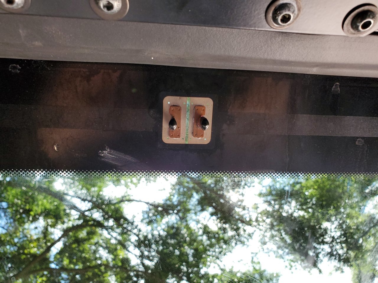

    I just got a factory seconds topperthe other day,, and I am trying to get some stuff together to wire it up.
    While crawling around in it when I got home I noticed two tabs on on back glass. Can anyone confirm my suspicions if these two prongs on my 2nd hand topper is a defroster?
    If it is, how would I connect it to the mirror defroster button?

    That's interesting and looks factory. I can see the shadow of what looks like conductive traces going to the side under the black area. Where do they go to? If you have a multi-meter, is there continuity between the two tabs?

    The area just goes around the whole window. Looks like a big circle that goes around the edge of the window.
    When I get home tomorrow I will check with a multi meter.
    Do you think I could find the relay that is stock on the truck and tap into that? That way the switch could still be used?

    Yeah, I have no idea why there would be potentially conductive ring that goes around the window. If it is a defroster grid from ARE it should be easy to wire up. They're not going to want their dealers to need to do anything complicated.
    Would love to know what it's for if you figure it out.

    My ARE has those as well, figured it was for a defroster. Throw some power to it and see what happens!

    Well there isn't continuity in the two tabs. I'm wondering if they are using each tab for a positive and a negative. This model is possible to come with a power lock and unlock. They may use that instead of wires being ran across the window?

    Well dug around some more today and there is two identical tabs behind the locking mechanism. So I went to an ARE dealer and figured out it was for the remote lock. I'm guessing so there isn't wires running along the window. The dealer wants 500 for the locking mechanism.... I think I will either live without it or find an aftermarket lock.
