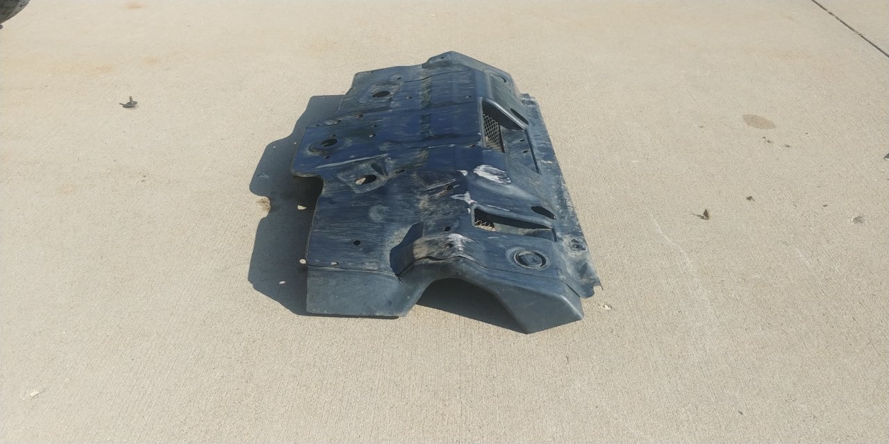

    I was at the dealership today picking up some seals, and noticed how bad these welds are. Are they all like this??

    Correct you are sir. Butt ugly welds for sure. Mine isn't quite that bad, but it's still nasty.
    I will say that welding aluminum ain't like welding steel. That shit is runny AF

    That ones abnormally bad.. but yea they’re uglier welds

    Might be just a defect on display, that one is much worse than others.

    Hahahah! Thats pure ass. Mine looks nothing like that. Maybe machines DONT weld those. Your welder must have been hung over the day they made it.

    Don't make excuses for Toyota . You can stack dimes on aluminum just like anything else. Toyota can do better. :D:D

    Agree it is possible. I'm going to bet Toyota went cheap and probably hired a "welder" in China who's day job is snapping together iPhones. Not exactly AWS 1.2 certified if you know what I mean

    Nothing that a grinder and some paint can't fix.
