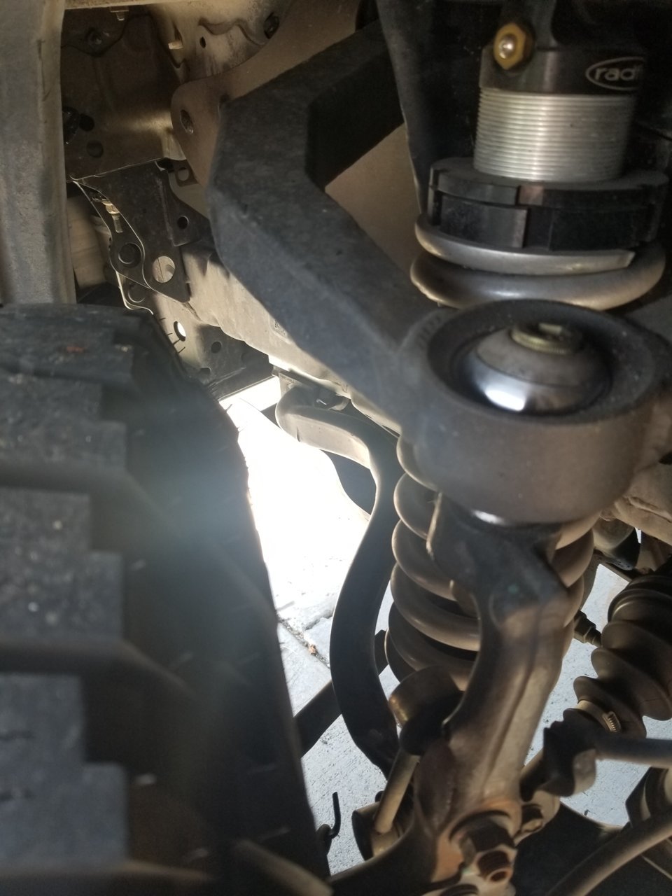

    Total chaos would be nice, but I'm a fan of boxed. These wheels have a good offset already they definitely go past the fenders, so maybe they are the -12. And I'm 4x4 so lift spindles wont work here.

    Possibly adjusting the caster could tilt the wheel forward about 1/4".

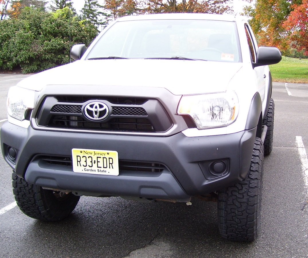

    Looks like you have the 0 offset wheels which is too much backspacing, especially with those UCA's.. Your best bet is to get the -12 offset wheels which will push them out about a 1/2" more which isn't too big of a deal. If they offer 8 or 8.5" wheels they would work better with the 285 tires. I'm running 305's on 8.5 wheels with -10 offset and those 17x9 with -12 would be about the same poke.

    Installed 1.25 spidertrax spacers. I have plenty of clearance now
    Thanks for advice everyone
