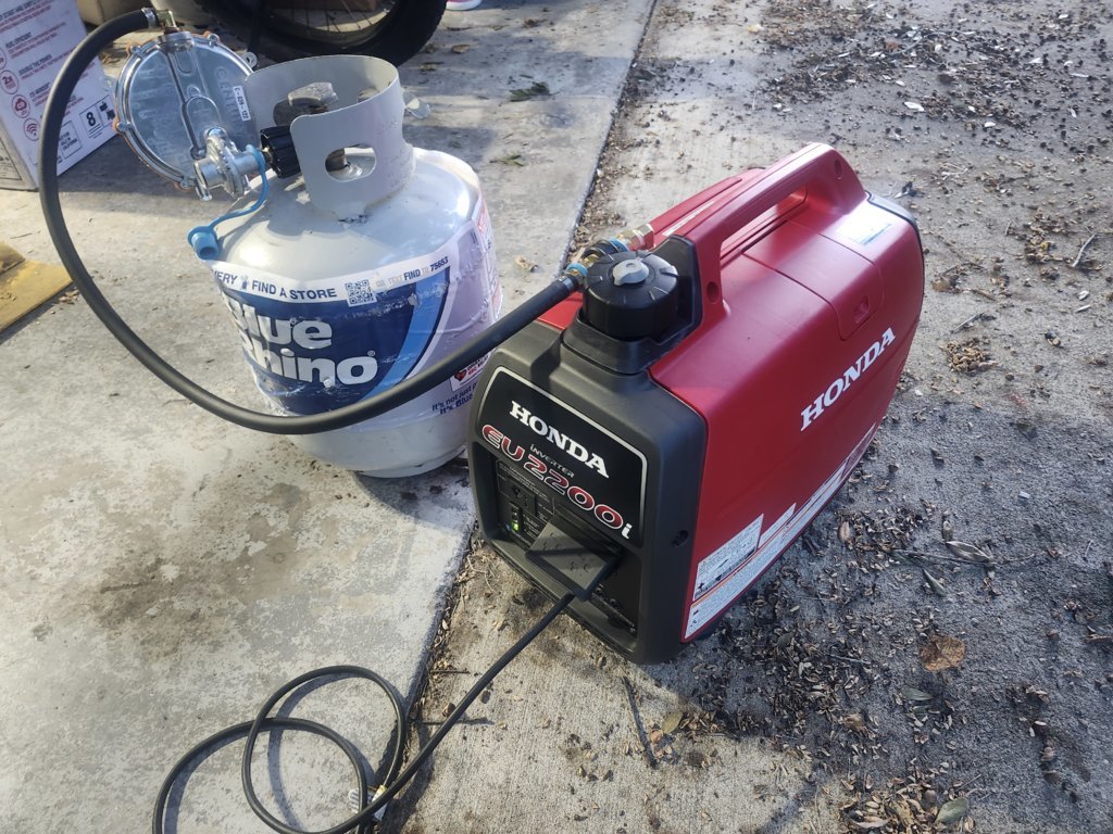

    From another site, I saw a three generator system recommended (a little more advanced, but nice).
    Large generator fired up occasionally for big loads like water heater, well pump, whole house stuff.
    Small inverter generator for fridge and freezers at night.
    Battery power station for small stuff around house (probably recharges it off the large generator when needed).
    I have the Honda 2200 watt inverter generator, but I have thought about grabbing a Jackery 1500 or 2000 for running the fridge more conveniently (especially for the shorter outages we normally get here).

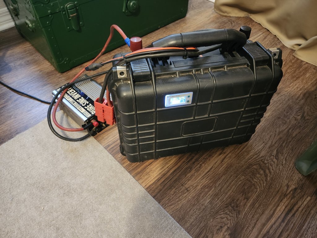

    Exactly. The home made 100ah battery runs my entertainment system for at least 8 hours.
