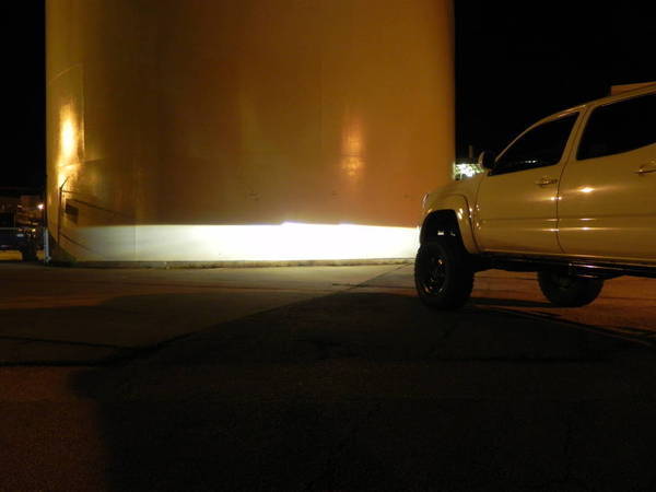

    This is why you retrofit.
    Not the best of pics but better than nothing. They are FX-R projectors with Phillips 85122+ bulbs I have since upgraded to Osram CBI bulbs and highly recommend them.

    You got those perfectly level!!!! Bolts or epoxy?
    Could you take some more output pictures? I am interested to see the gap between the truck and the bottom of the lighted area without the foglights on

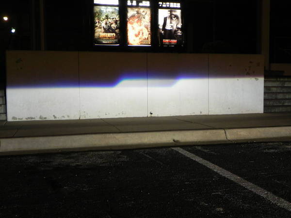

    H1's with upgraded XB35 bulbs. Looks super sweet to me and for the GB price, it was a no brainer.
    Pics
    The projector
    Low Beam
    High Beam

    Awesome! I had the minis in my focus that my girlfriend now has.
    How big is the gap before the light from the mini and fxr guys? I am worrying with a headlight 38 inches from the ground there is a huge gap

    Here are some crappie phone pics I don't think you need to worry about not having enough fore ground light. The middle of my head lights are at 43" tall and I don't have any problems. All pics were taken with the fog lights off but I did take some with them on for comparison if you would like me to post them.
    Side shot
    Drivers seat
    On the road
