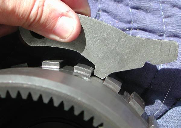

    Just for education this is all that Park amounts to inside the transmission.. If you ever put your truck in park before its completely stopped you'll hear a ratcheting sound.. It's the parking pawl jumping over the gear teeth. If you want your truck to be in the same spot when you come back you should use it.
    2nd argument the parking brake helps keep the rear brakes adjusted correctly.

    It’s not paranoia. A parking pawl is about the size of a pencil eraser. That’s all that’s stopping a vehicle from rolling when people don’t use their parking brake.

    That puts the pressure on the pin and teeth in the tranny. Putting the parking break first puts pressure on the rear drums before the cars weight rests on the pin.
