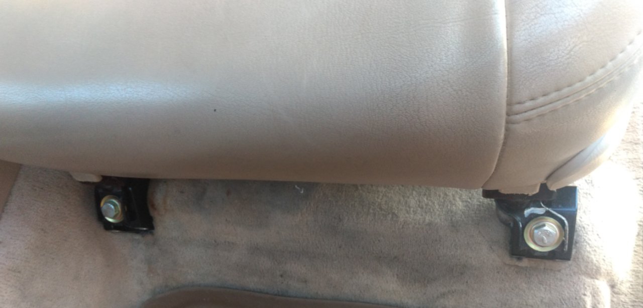

    Installed the Seat Jackers on some original bucket seats. It was an easy installation. Good instructions. No issues. My son and I agree it makes the seat more comfortable. So I'm keeping them.

    ordered set last week! install fairly easy, what a difference!! sure does improve seating position, milled aluminum brackets, no regrets but $79.99 ouch!

    Recently installed a set. A nice improvement.
