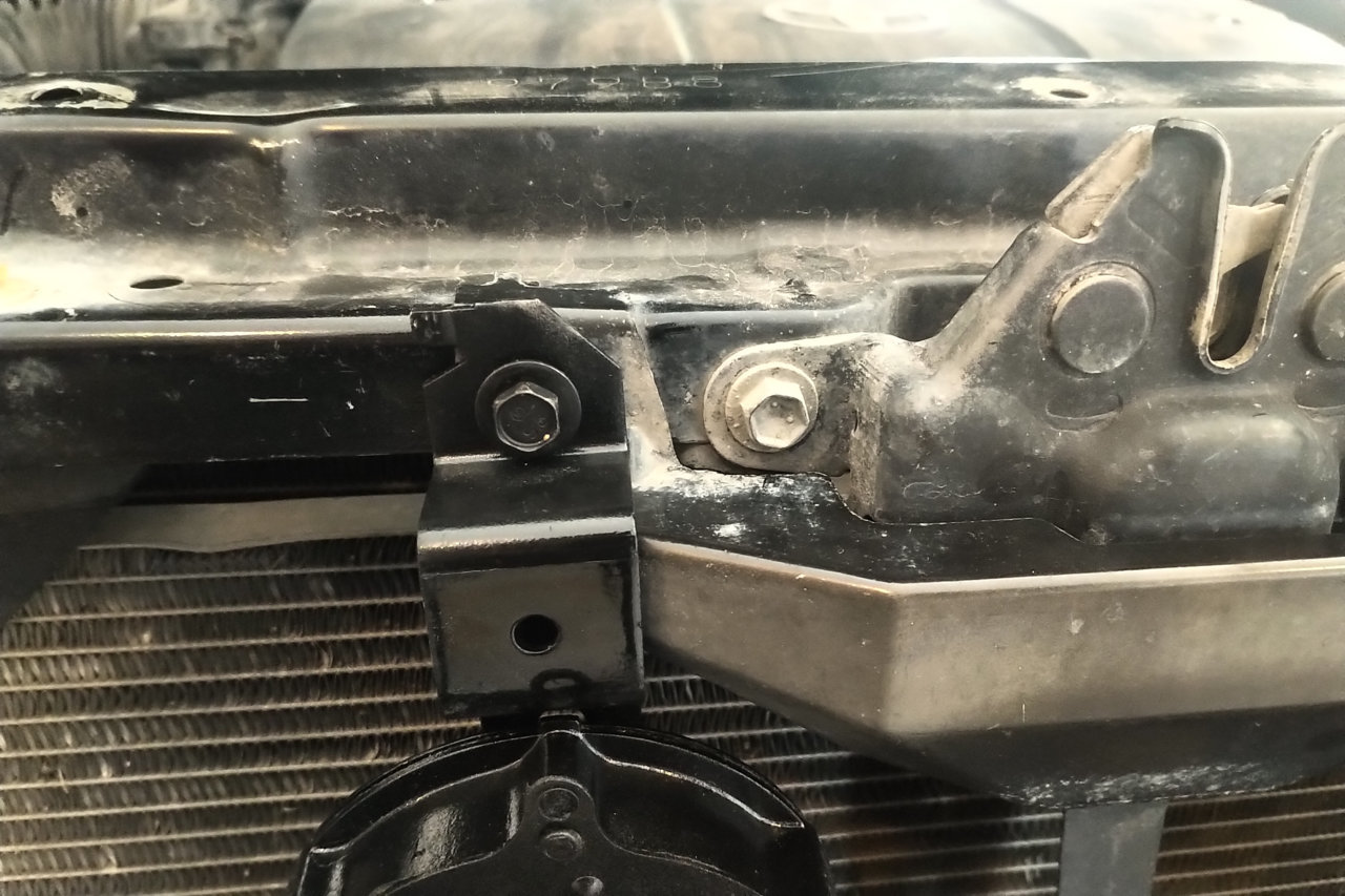

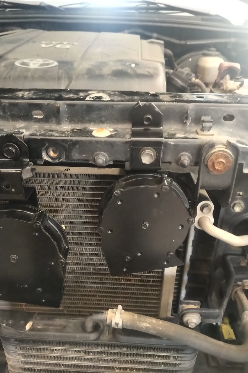

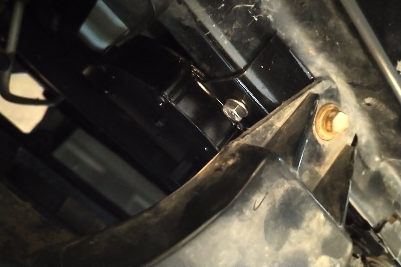

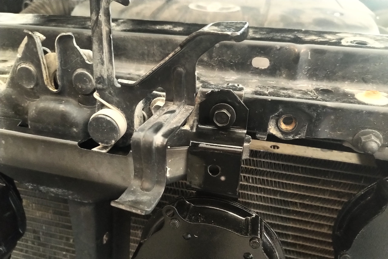

    OK - for those looking for 2nd Gen mounting options (other than #1714 page 86)- my photos are below. This is Setup #3. No brackets from Tyler. From right to left facing the engine, #1 horn is mounted where one of the original horns was. #2 horn is mounted on the right side of the hood clasp shroud, using the existing hole. Upgraded the M6 bolt to something abit longer. #3 Horn is the same as #2 but on the left side of this shroud. Again - using a new longer M6 bolt. #4 horn needed a new mounting hole drilled in the radiator sub-frame (?), and the top of the bracket cut off in order not to interfere with the grill when re-installing the grill. Needed to remove some bracket paint here and there, of the brackets to good grounding, and painted some areas where Tyler had prepped them for grounding. Now just wire clean up time. They sound great! IMG_20191103_0921222.jpg

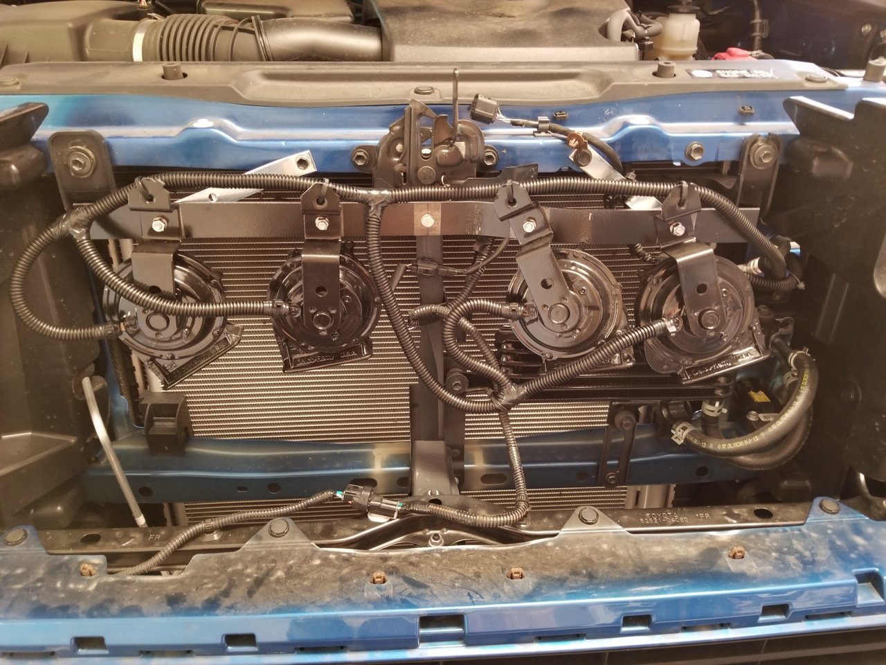

    Finally finished and the horns are Awesome!!!
    I ended up bending the drive side horns towards the front and that cleared the transmission cooler so all is good!
    I didn’t need to remove the front grille entirely. After undoing the screws and the two plastic retaining things, I just pulled it out enough to get a bit more room to work.

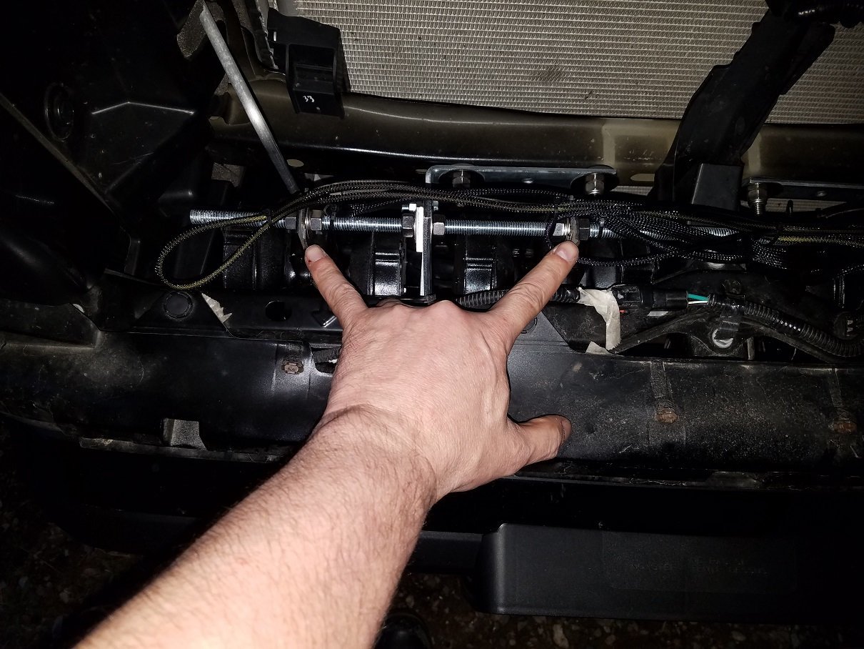

    OV Tuned, S&B Intake, MBRP Dual black Cat-back, accumulator delete, URD SS, 2LM, SSO Hybrid bumper/Warn 10kSynthetic, Custom Car Grille, MESO Ultimate Turn Signal in KTJO Power Folding Mirrors, Genesis Dual Battery, BHLM with LED upgrade, Fog delete, Geko Bed & Underhood lighting, Rear camera anytime, Nav Block Override, 400W anytime w/ interior outlets, USB charging stations, DE-badged, TVD blackout kit, HiLux interior door handles, Hybrid SS/Delrin Shift Knob, Cali-Raised bed Stiffeners, Ultimate Tailgate Seal, "El Dorado" Dual-quad horns, Diamondback HD cover, Mobtown engine/trans skid plates, RCI control arm skids, JLT oil catch can, Meso overhead Hex rack.

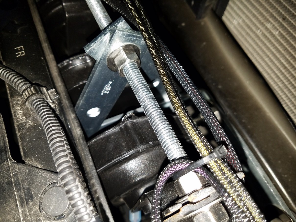

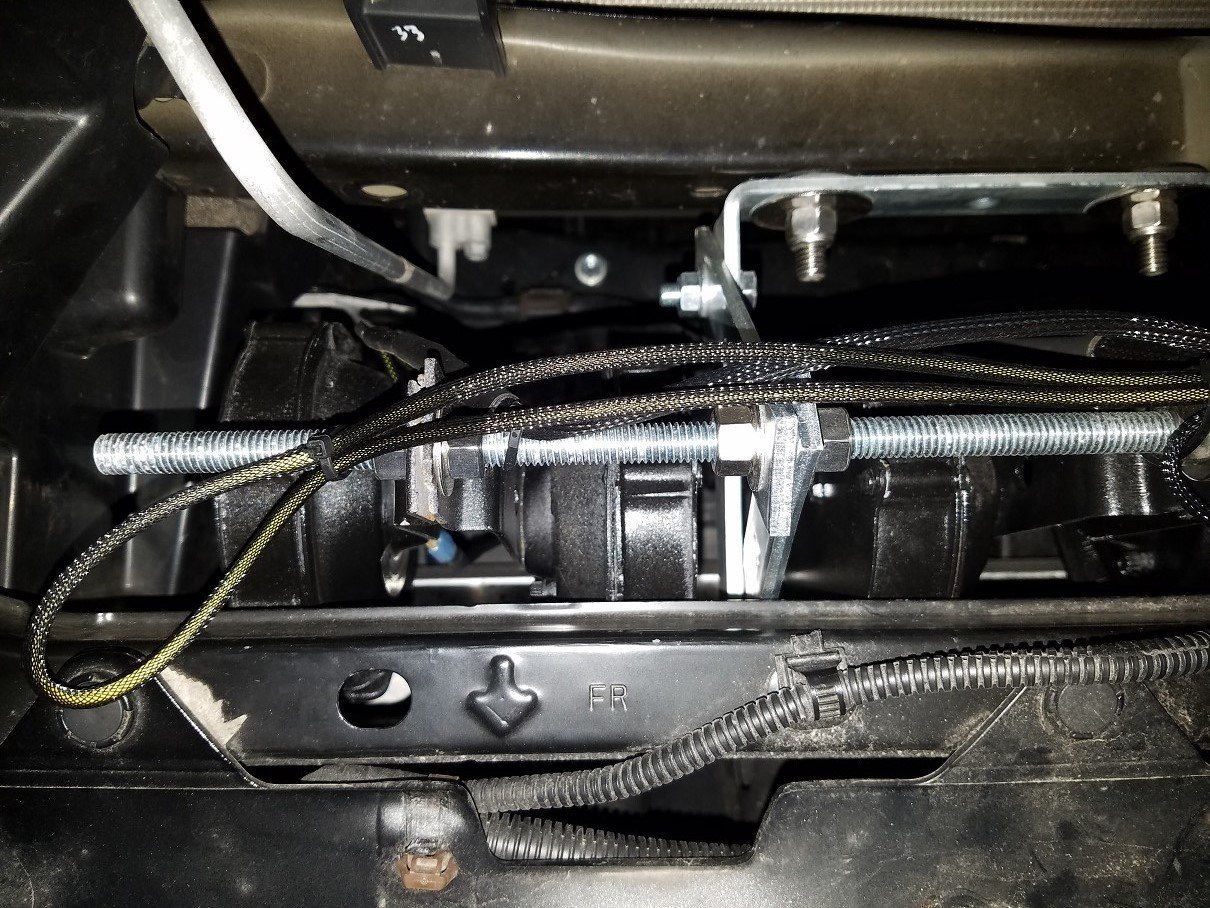

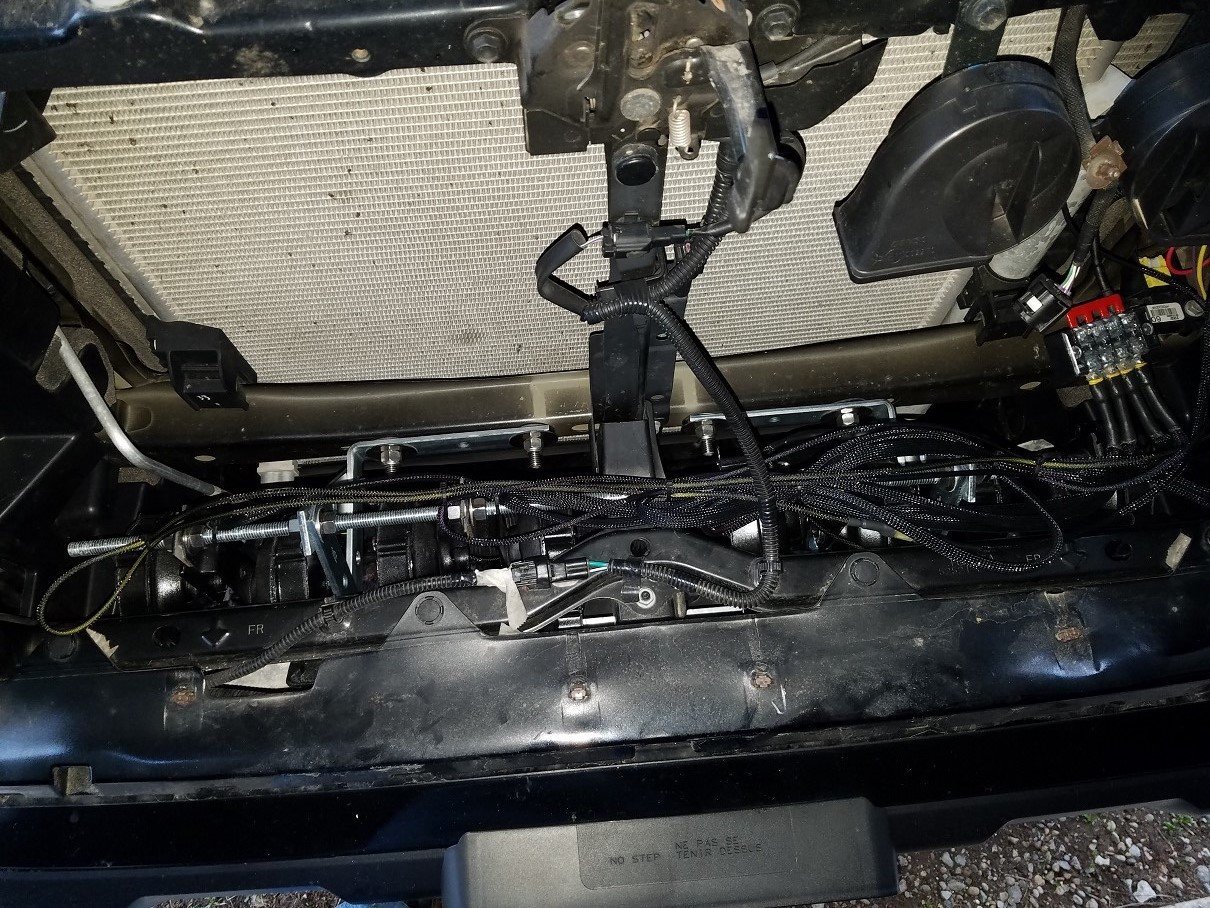

    I think I used 1/4 and 3/8". Here are some pics of my set-up. I will check my spools when get home to confirm.
