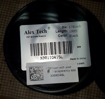

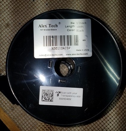

    So, I checked out the open spools, and it seems I only used the 1/4" and 1/2" braided sleeve.

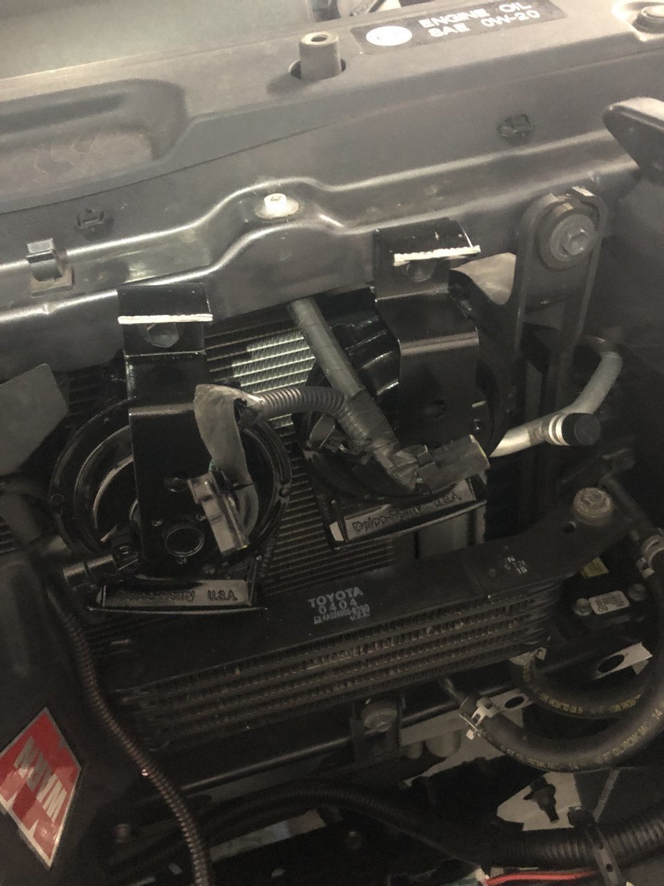

    Agree. Kinda disappointing to be honest. Still sounds cool, but I expected them to be much louder. In fact, I think my stock horns are louder.

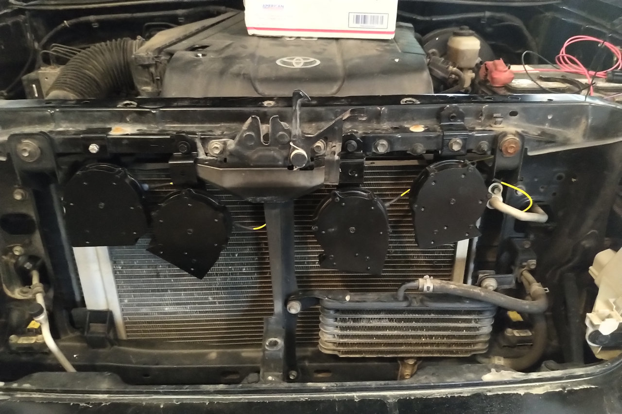

    Additionally, Option 1 bar does not fit a 2016 OR. I used the two factory holes for the drivers side and ended up drilling two new holes and using rivet nuts and 10-24 bolts.

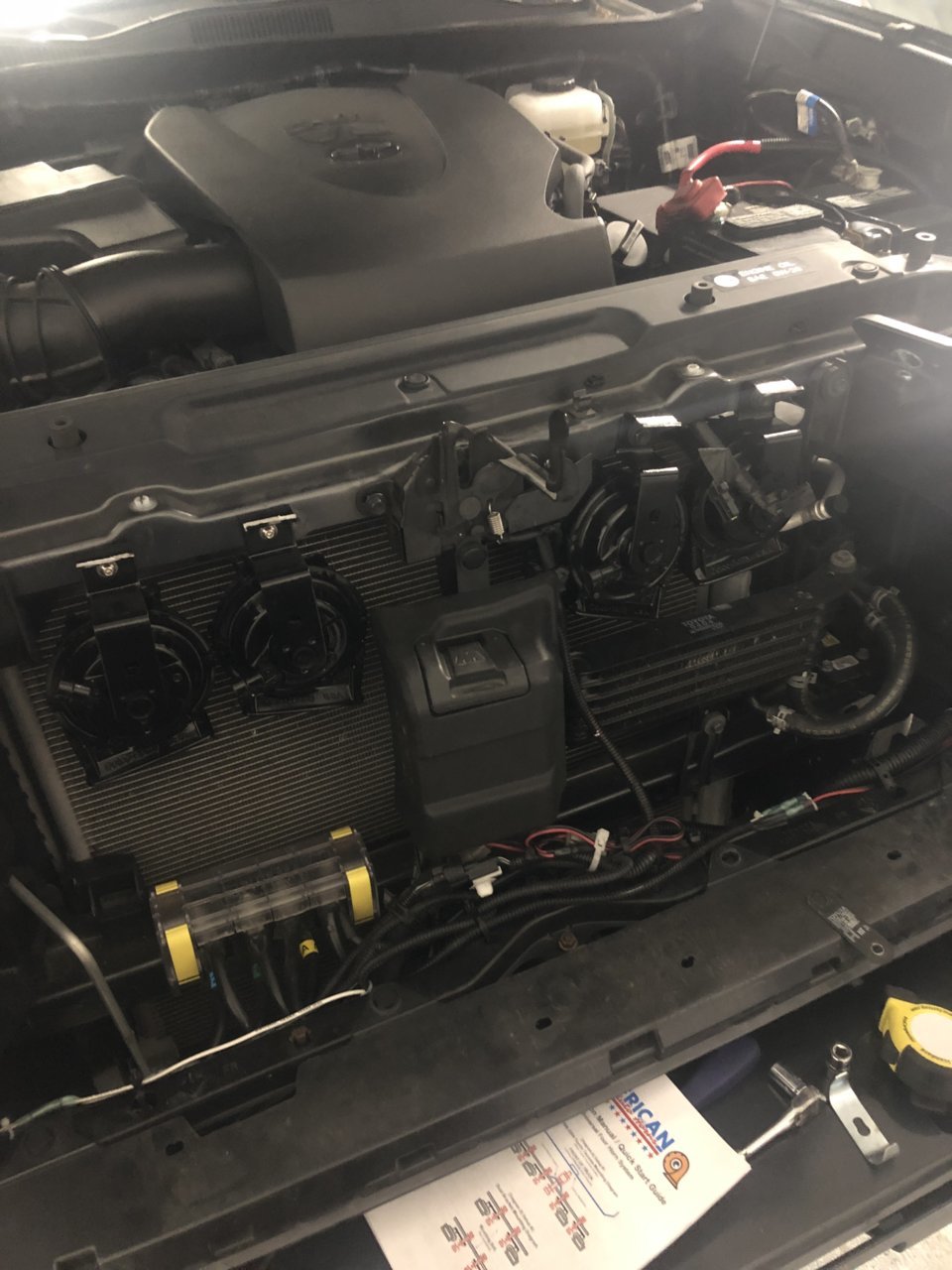

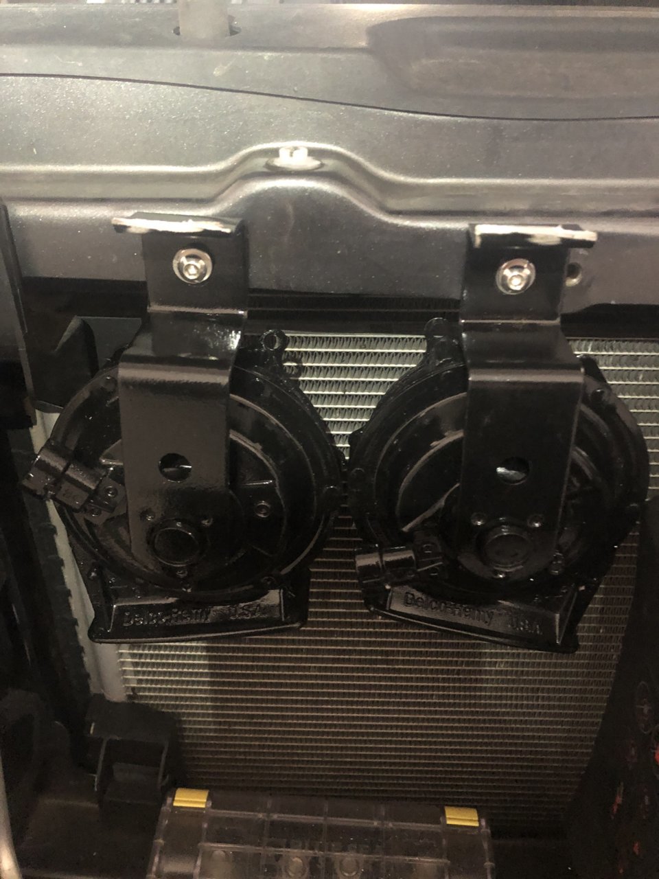

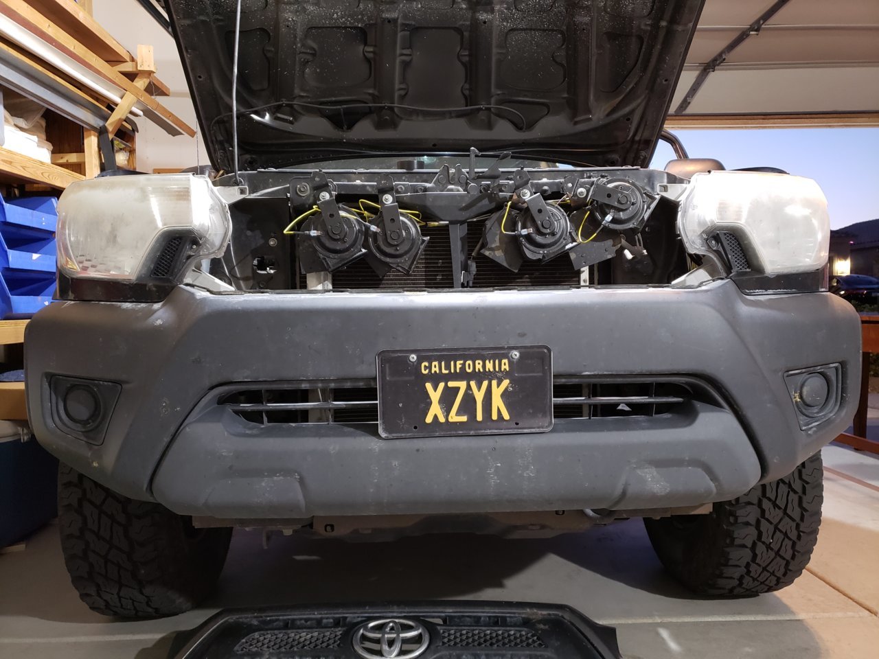

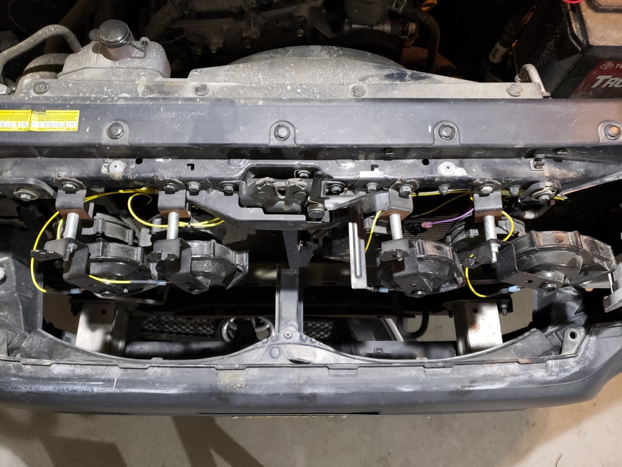

    I've finally gotten to the installation of the new harness! Please don't mind the filth. Haha!
    For the undecided: Sound Clip
    Sound clip just gives you an idea of the tones. For volume, you'll need to hear it in person to feel its true glory.
    Again, thank you for all that you do for us, Tyler!
    The. Best. Customer. Service. Bar. None.
    PS: Apologies for not remembering who I stole the "spacer" idea from.

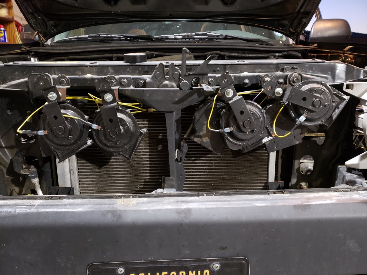

    Yes, I’m very happy too with the new sound. I ordered Setup #1 for my 3rd gen 2016 and opted to attach two horns to the OEM spots after removing originals. Then, on the passenger side of bay drilled holes and attached the remaining two. Used a metal strip as additional support on the back side.
    Very stable and sounds great.
