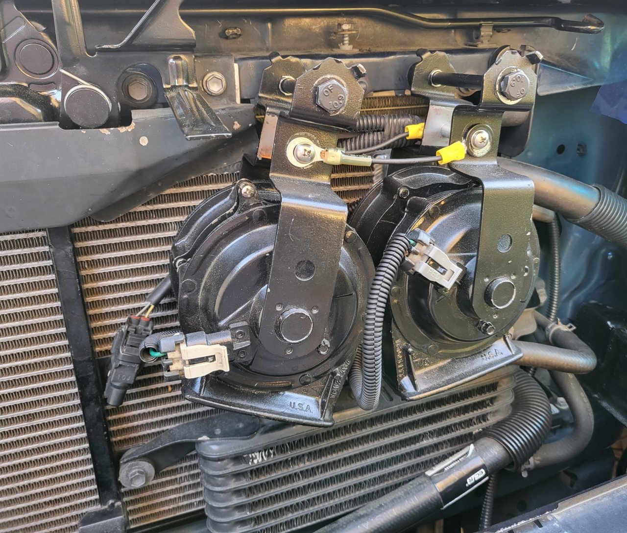

    Looks like a Gen2.5 TRD Sport, but really an '08 TRD OffRoad
    TRD Supercharged / OTT Tuned
    And it fits!

    Very clean installation!

    Does the stock relay get replaced with the one included on this kit?
    I’m a little confused by the diagram showing two relays. Wouldn’t the stock relay limit what these horns are capable of?

    The new horns get power directly from the battery via the kit relay. Stock horn wire goes to the new relay as the trigger. No stock wiring/fuses/relays are removed.
