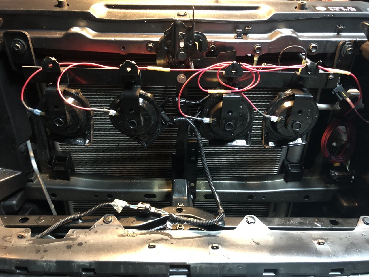

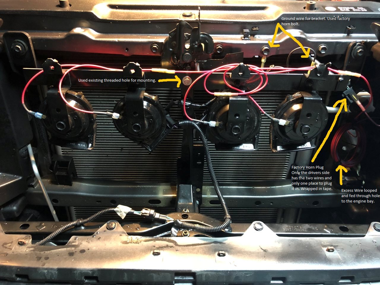

    Ok guys. Here is the scoop. I filled-in some explanations on my pic. It is pouring rain outside so you will have to wait for the engine bay pics. I ended up running the wires through the lower hole you see in the picture to the relay box provided in the kit. I mounted the relay on the far right radiator support bolt close to the battery. (I checked and it was cool to the touch on a hot engine) This location is easily accessible if the fuse ever needs to be changed as it is right in front of the battery. Using the picture above as a reference, it's location is about even with the oil sticker in the top right corner. I then ran the ground line with the factory wiring harness attached to the front drivers quarter panel and up to the factory battery ground bolt (easily located next to the battery). The positive line was routed the same way but continued between the battery and the fuse box then connected into the positive terminal bolt. That should be about everything you'd need to know in addition to the arrows and descriptions in the pic above and what has been posted earlier. I will add a few engine compartment pics tomorrow or Friday when the rain stops so you will have them for a possible weekend install. Let me know if you have questions..

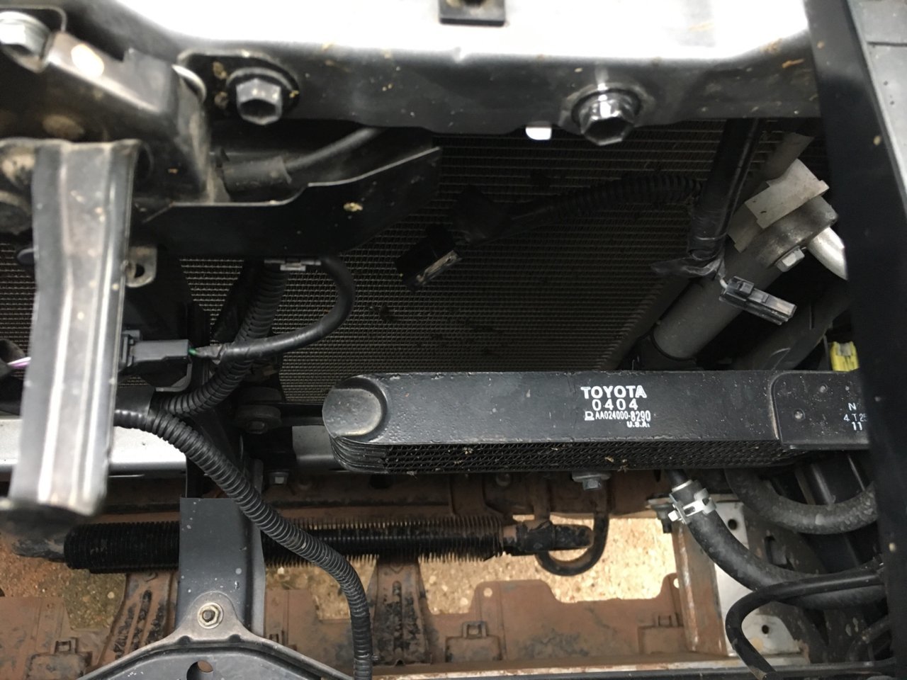

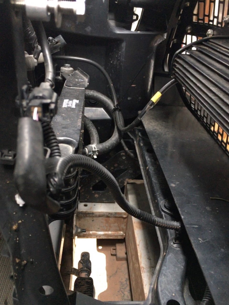

    Just want to bring this attention to 3rd gen auto transmission with owners (I have the tow package FYI). I had a spare hour before work this morning and noticed any which way I tried with my new 4 horn’s and it’s bracket that this small automatic transmission cooler gets in the way of properly installing this. See pictures for reference.
    I know I’ll get these to work but I need to reverse engineer the install and adapt it to my set up which possibly some others have also. I’m gonna take my time on it to install and get it right the first time. This might take me a little bit of time and if I figure out a solution I’ll post it up here in this thread for this set-up.
    Can’t wait to hear these horns bark.

    So it won’t bolt to that hole everyone it uses? That’s a shame. What light bar mount is that?

    I have the RI Grille with a RI double row led bar and another RI single row led bar below the grille and above the bumper.

    I was actually planning on making end brackets and drilling an additional hole on each end of the included bracket to make it more stable. (just in case I'm Bo Duking down the road)
    Never even noticed that we were both 6MT owners who installed this. I will say that there are plenty of bolts behind the grille for mounting these horns. Thanks for catching this! For me, I wasn't worried at all about physically mounting the horns but more concerned with the wiring into the factory switch etc.
