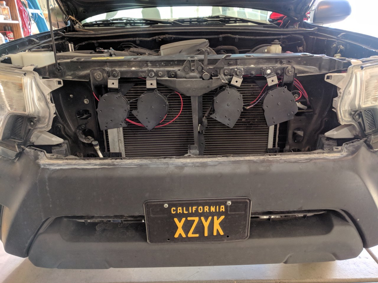

    @BartMaster1234
    Do the connectors on the horns need wrapping to protect from water splashes?
    Big difference in sound between stock and ACDF on these videos, but like Tyler said, the true sound can't be justified by digital files. One needs to hear these in person to truly appreciate how awsome they sound!

    @BartMaster1234, I tested each horn individually to make sure everything is working. Is it normal to have varying loudness among all horns? I noticed that two notes were significantly softer. Did not do further investigation 'cause the letters were already facing the engine bay.

    Yes, each horn does not produce the same decibel level. They each produce a certain frequency to achieve the ACDF notes respectively. If you noticed, 'D' is the lowest, and 'F' is the highest.
    You do not need to seal the connectors, but you could if you really wanted to. I would paint the bare metal rear brackets since you mounted them differently, those will surface rust overnight from moisture in the air. Those aren't painted since they are meant to act as a chassis ground.
