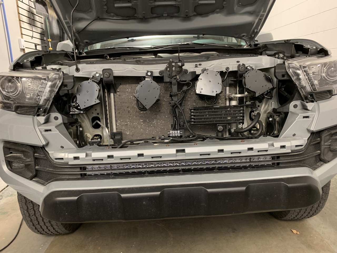

  17. Oct 21, 2018 at 9:11 PM
    #1137
    treimche
    treimche Well-Known Member
    Dec 2, 2016
    #203883
    789
    Fargo, ND
    Finito! I’ll add more pics and video soon.
