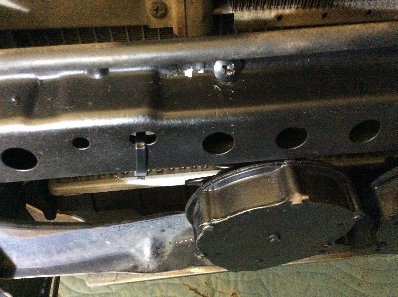

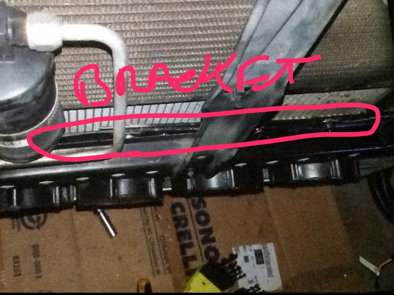

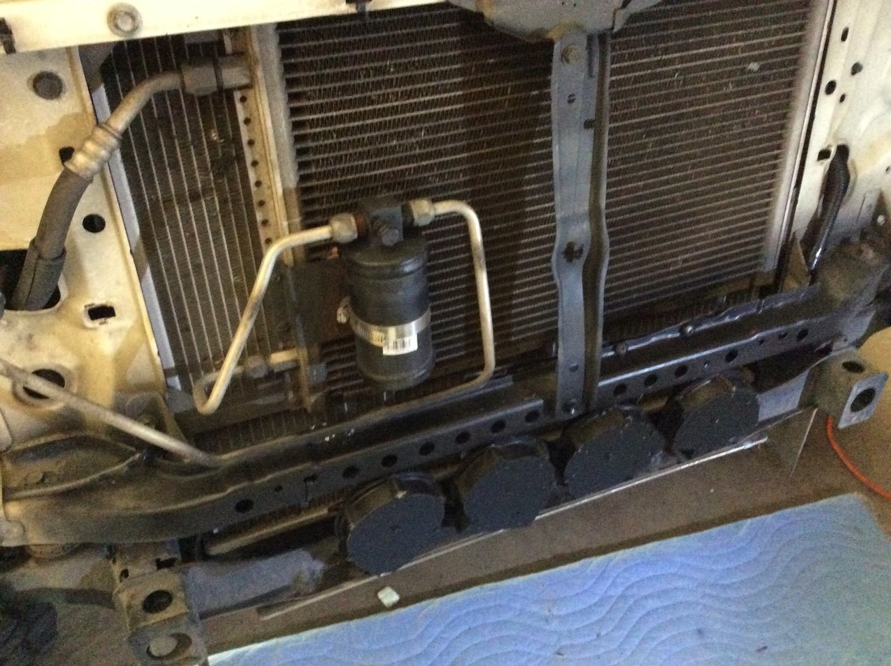

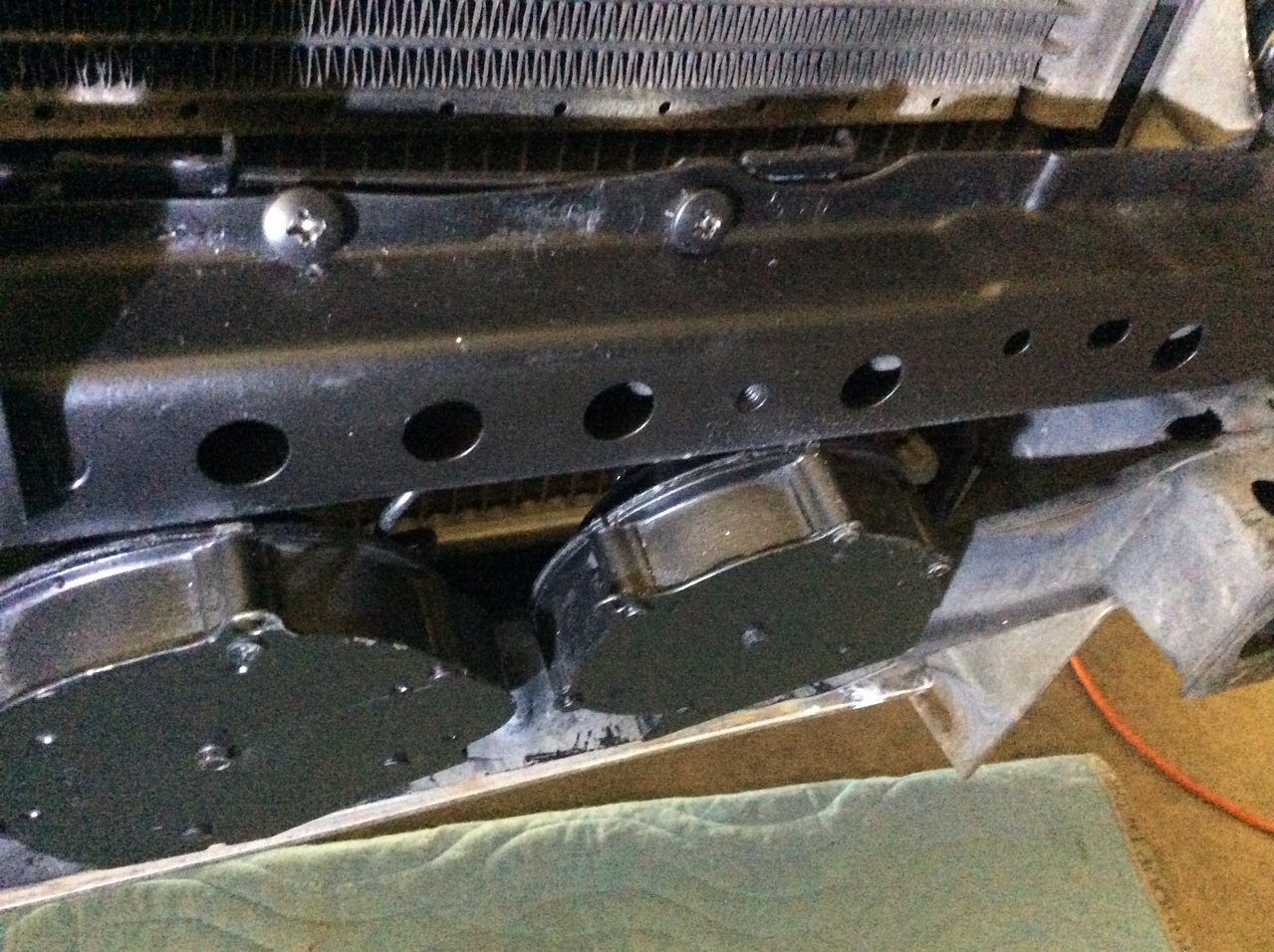

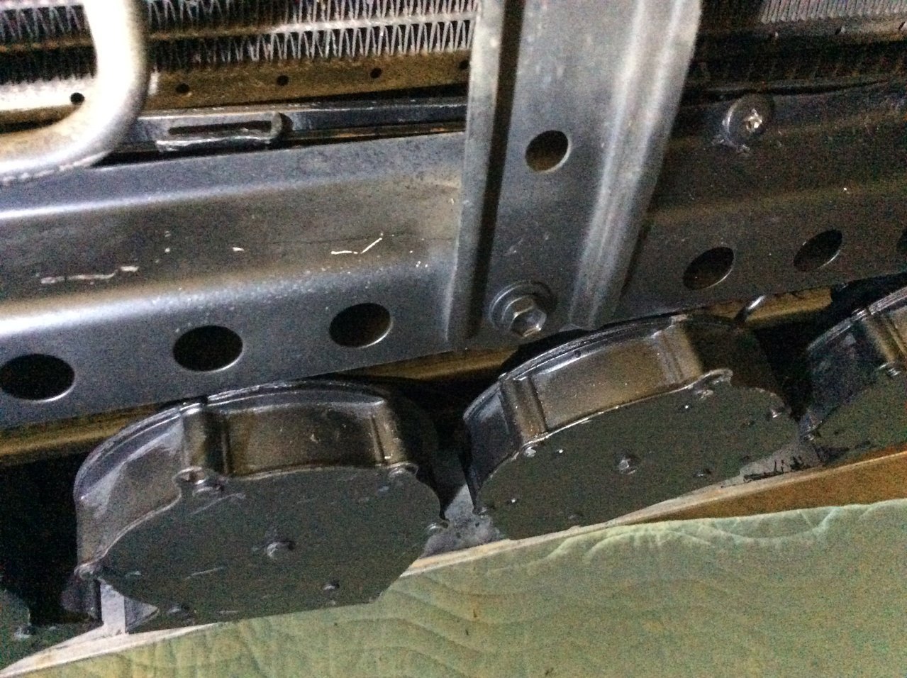

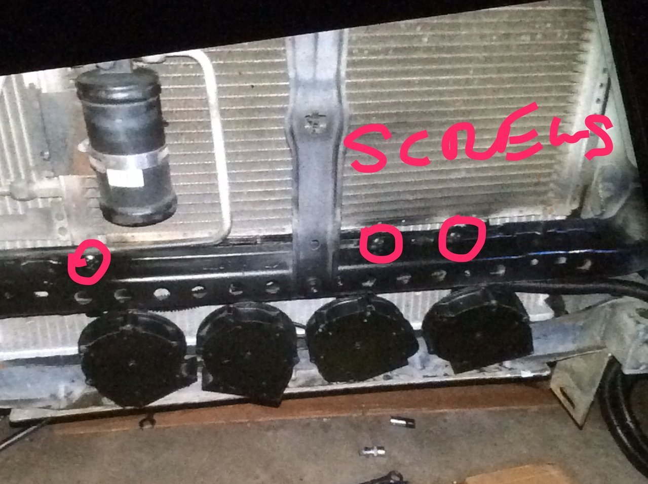

    Ok guys got my setup as I ordered mine 3 weeks ago before group buy and this guy has done a great job putting the package together with
    welding ,wires and relay, all you need,
    BUT if you have a 1995-1997 Tacoma with the square headlights the regular setup WILL NOT WORK,
    The location that the 1998 and up Tacoma s have is not there for the 1995-1997.
    On the 95-97 years the valance pushes right against the radiator bolt and can not be attached that way.
    Good news is if you cut the bar and trim the horns they will fit between the skid plate
    support and the cross support as shown. It's a very very tight fit, but will fit, have to make sure the skidplate bolts don't hit the horns, then screw from the cross support to hold the bracket and horns in place, bracket is on the back side of the cross support now.
    So if you have a replaced front bumper or off road bumpers this location Probably will work regardless.
    Looks like it will work, might have to trim the lower valance an inch or so between the skidplate
    underneath, not sure yet. But looks like it will work and will be nice and clean out of sight,
    Bumper and grill have to come off

    Got it all done, radiator support and skid plate upper support is the place to put them as the sound is outside and not trapped
    in the engine area,
    Didn't have to cut the valance, just super tight fit, you can see horns are behind and to the left and right
    of the license plate
