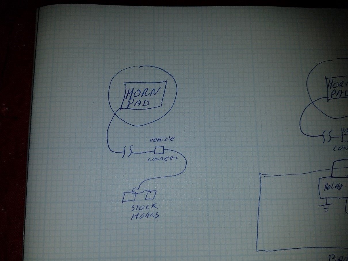

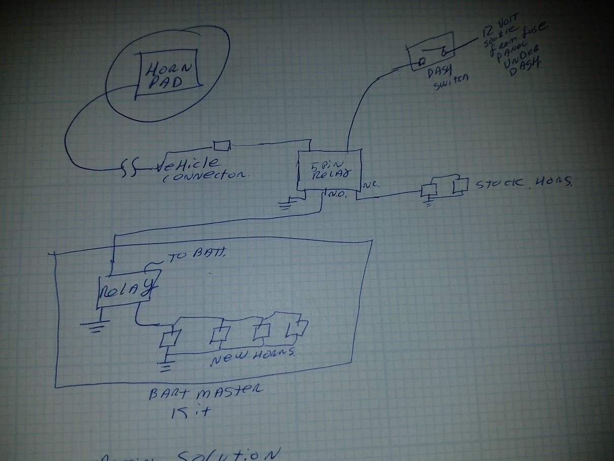

    So as we wait, I'll ask a dumb question:
    Has anyone considered running an alternating switch allowing you to use the Caddy horns OR the Meeper horn?
    Years ago I installed air horns on my Miata. Not being 100% sure of the legality at the time, I ran a toggle switch to the dash allowing me to switch back to the meeper in case the local constabulary questions where that noise came from.

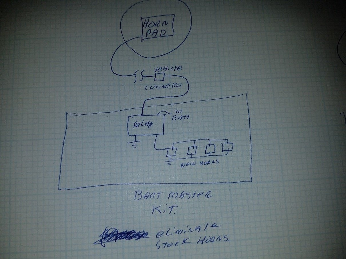

    I actually have laid out that very idea. Another member had the same question and I worked up a layout that would allow it. Attached are 3 pictures that show stock setup, American auto horns set-up, and a hybrid set-up.

    And now that I have it laid out, I must admit, I probably wont every hook it up like this. I left the stock horns in place and I can just move the wire back over to the stock horns if I ever think I need to return to that configuration.

    Adding a switch to the equation may allow more than just "returning to stock".
    The added switch and relay would allow you to choose between a polite "meep meep" to for example urge an old woman that forgot green meant go, as well as the ability to switch to the "GET THE #@$#$%$^#$ OUTTA MY #@$#@$#@% WAY" horn setup.

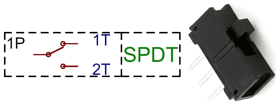

    Id have to sit down and figure out exactly where youd put it, but a SPDT switch would work perfectly for this scenario. 517edaface395f581d000001.jpg

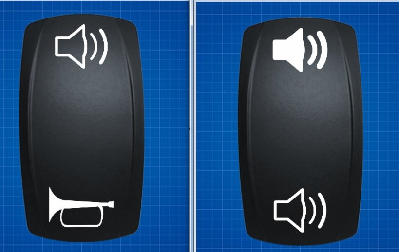

    You could get a custom rocker and put it on the left side in a cubby replacement panel.
