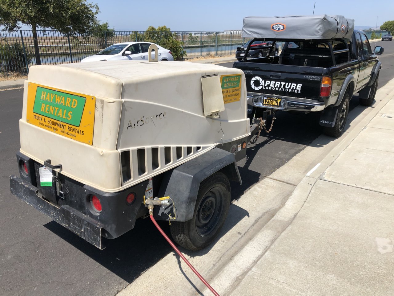

  4. Aug 24, 2019 at 1:13 PM
    #1844
    BartMaster1234
    BartMaster1234 [OP] Well-Known Member
    Aug 21, 2016
    #195197
    45,854
    Tyler
    Pittsburgh, Pennsylvania
    Flux Capacitor
    We don’t joke around with sandblasting, we rent an industrial construction air compressor to run our cabinet.
    This 2007 Ingersoll-Rand compressor with 185 CFM of paint busting pressure stands no chance against these horns.
    Dor, pop.tremuloides, mlr69 and 3 others like this.

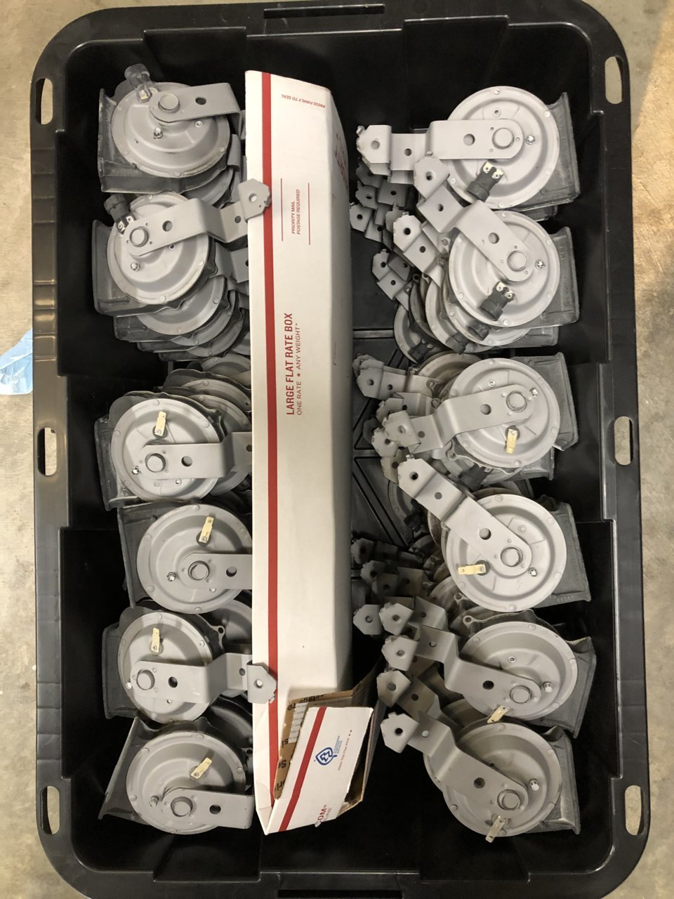

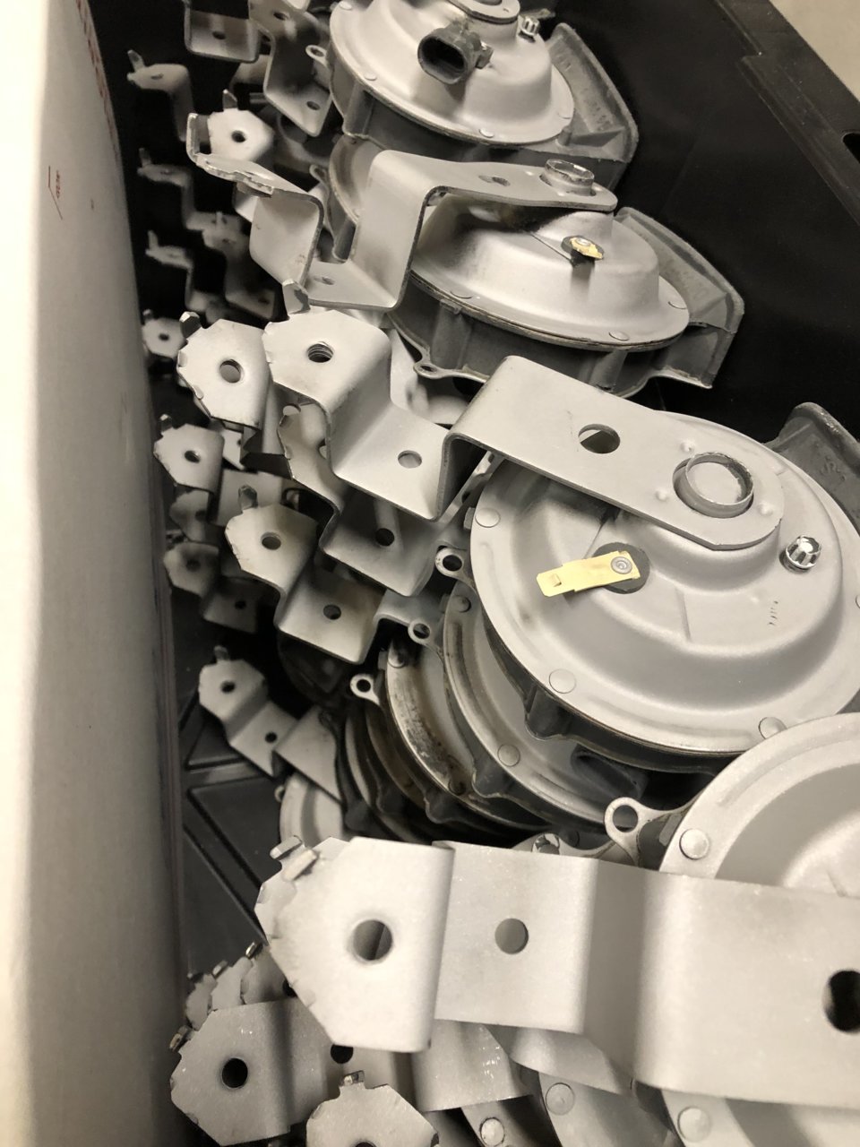

  8. Aug 25, 2019 at 9:55 PM
    #1848
    BartMaster1234
    Aug 21, 2016
    #195197
    45,854
    Tyler
    Flux Capacitor
    Sneak peak! These horns have been sandblasted with Aluminum Oxide/Glass Bead media.
    Every horn comes freshly primed and painted.
    F351C328-F76E-4794-8F4C-4085121B6F8A.jpg 33441D67-D4CE-4999-BEA0-FCF1B2F9246A.jpg

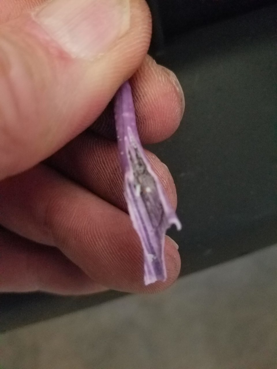

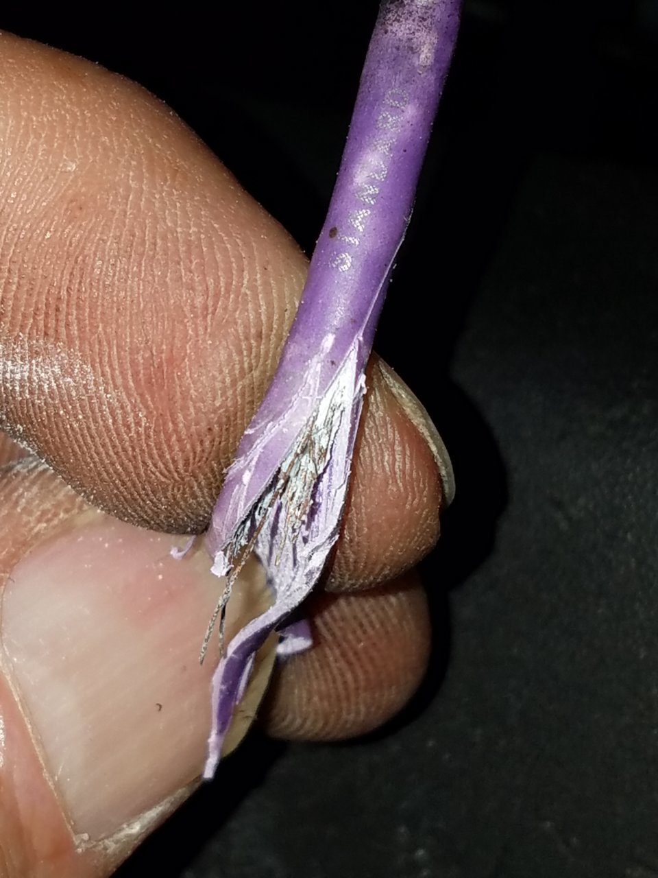

  10. Aug 30, 2019 at 11:21 AM
    #1850
    1997tacomav6
    1997tacomav6 V6 5sp,RegCab,TVS1320 Supercharger,Haltech, 800k
    Oct 5, 2013
    #113940
    10,376
    John
    Denver
    97 reg cab, v6 5sp 300hp supercharged, Methonal Injection, 800,001 plus miles, Original Owner
    V6 5sp,RegCab,TVS1320 Supercharger, 56mm pulley, methanol injected Haltech ECU, AC Tvs1320 supercharger,(MUST DO) every 125,000- 150,000 needs rebuild Projector headlights HID 5 speed manual Amsoil for all drive train Smaller 56mm custom pulley, (MUST DO) 2004 DESNO fuel injectors, zero ping ping, 2004 side door mirrors Dick Cepek Rims, Michelin tires LTX, ATM Pathfinders Dynopro ATM ( that last 100,000 miles) Now running Dynopro ATM mud and snow tires KN cold air intake Cat back dual exhaust with ss exhaust tip, Raised exhaust tail pipe to 2" below body line Optima*dry cell battery,red top Alpine sirius radio, 200 watt amp, focal is165 split door pod speakers Focal door speakers Subwoffer behind seat Viper alarm, Electric Locks Dark tinted windows, bucket seats corbeau lg1 Tacoma Rubber floor mats TRD fender extenders, Bilstien shocks, King shocks JBA UCA trailer iv hitch, electric brake control, Drilled slotted brakes, High carbon steel (MUST DO) EBS green stuff 7000 series pads(MUST DO) TRD engine oil cap TRD stick shift, Marlin crawl shift kit. Rear sliding window 2002 4Runner functional hood scoop cut into Tacoma hood, 4Runner dual overhead map light Gentex Auto dim + Compass + Temp, garage,rearview mirror Snow Methonal kit stage 2 Custom 3 core aluminum radiator Linex bed liner Haltech stand alone ECU, Intake supercharger gauge. Stainless steel brake lines, Custom leather wrapped steering wheel, Haltech stand-alone ECU,
    I was one of the 1st buyers of these horns over a year ago.
    Had to use it today and nothing happened.
    It was working just fine.
    Looked at the fuse and it was popped
    Ok So I got another fuse and put it in and nothing happened.
    Had to take the grill and bumper off GRRRR to inspect things more.
    The purple wire had broken in half (weird)
    So I went to splice the wire and there was literally white dust and the remnants of a few wires in the plastic cover.
    Looks like the purple wire burnt it’s self up from the inside out.
    WTF
    looks like I have to pull everything apart and needs to be rewired with higher grade wires.
    Definitely not happy here.
    Anyone have this issue yet?
    Running Board Man likes this.
  11. Aug 30, 2019 at 11:24 AM
    #1851
    perkj
    perkj Well-Known Member
    Aug 31, 2016
    #196051
    972
    I'd suspect a rat ate thru the wire vs it burning itself from the inside out.
  12. Aug 30, 2019 at 11:26 AM
    #1852
    1997tacomav6
    Oct 5, 2013
    #113940
    10,376
    John
    Denver
    No, all the wires were covered with in a wire loom and no rats where I live to speak of
  13. Aug 30, 2019 at 11:27 AM
    #1853
    perkj
    Aug 31, 2016
    #196051
    972
    Then agreed, very odd. @BartMaster1234 any thoughts?
  14. Aug 30, 2019 at 11:28 AM
    #1854
    1997tacomav6
    Oct 5, 2013
    #113940
    10,376
    John
    Denver
    Maybe it just shorted out but everything was wrap super well, doesn’t make sense
  15. Aug 30, 2019 at 11:31 AM
    #1855
    1997tacomav6
    Oct 5, 2013
    #113940
    10,376
    John
    Denver
    The purple wire which connects to the factory horn wire is the one that failed but the factory horn wire was just fine that connects. So the wire failed after the connection going to the purple wire, NOT the OEM wires.
    Just the purple wire is faulty? Wrong wire gauge? Or relay?
    I’m thinking it’s the purple wire that not rated at high enough gauge because the
    connected OEM wire is fine.
    Maybe @BartMaster1234 can let me know what’s going on with this kit I got from him.
    Mmm

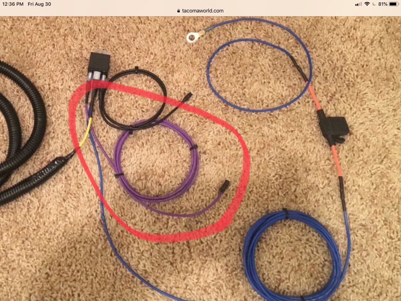

  16. Aug 30, 2019 at 12:01 PM
    #1856
    1997tacomav6
    Oct 5, 2013
    #113940
    10,376
    John
    Denver
    I think I figured it out, I just found an old email that he sent me for a free upgrade for a new wiring harness that’s 100 percent copper, mines not 100 percent copper.
    I see this purple wire is not copper or very little copper so I bought my horn set before the updated wiring harness.
    I will email him for the free updated wiring harness.
  17. Aug 30, 2019 at 12:37 PM
    #1857
    BartMaster1234
    Aug 21, 2016
    #195197
    45,854
    Tyler
    Flux Capacitor
    John, the harness I sent you was a very very early prototype. You have the first system I ever sold which was a working prototype model. I have since improved the harness drastically, which now have loomed wires and I now use 100% Copper GXL wire as opposed to the Copper Clad Aluminum I used for your set.
    I will be sending you a new harness ASAP.
  18. Aug 30, 2019 at 12:39 PM
    #1858
    BartMaster1234
    Aug 21, 2016
    #195197
    45,854
    Tyler
    Flux Capacitor
    I should add that the wire is properly rated for that amount of current and voltage, what happened there appears to be chafing against a metal object which wore away at the wire jacket causing it to short.
    Running Board Man and perkj like this.
  19. Aug 30, 2019 at 1:17 PM
    #1859
    1997tacomav6
    Oct 5, 2013
    #113940
    10,376
    John
    Denver
    No, thats what it looks like when I torn the plastic opens, all the wires are in a wirloom
    with no metal to touch.
    Anyways thanks for the upgrade to come
  20. Aug 30, 2019 at 1:24 PM
    #1860
    BartMaster1234
    Aug 21, 2016
    #195197
    45,854
    Tyler
    Flux Capacitor
    Strange. Definitely looking at it would help a lot. PM me your address and what connector your horns have.
