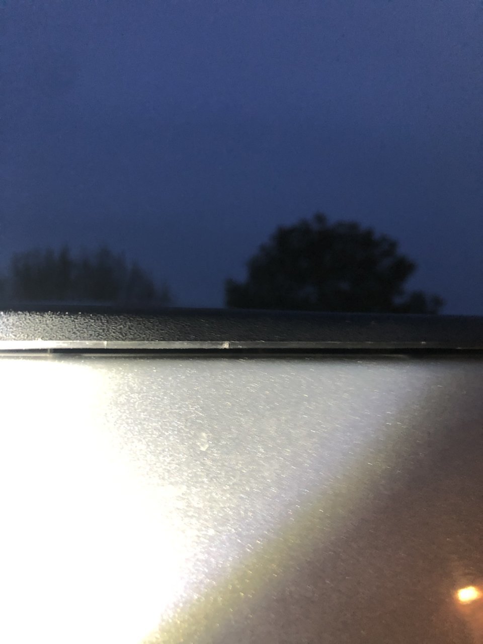

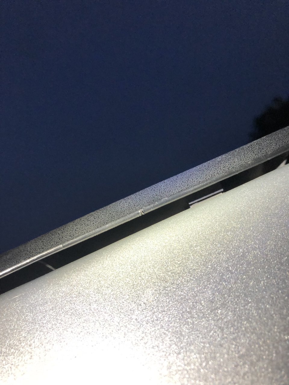

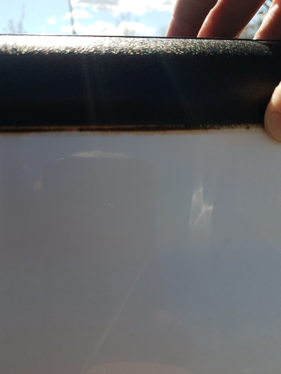

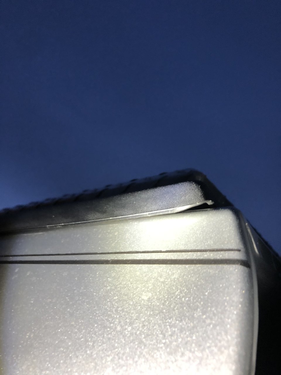

    I discovered these when I was doing an early spring detail and clean-up over the weekend. Check these areas out when you can for rust formation: Bed side cover/cap rear on both sides and the front edge of the passenger side fender under the plastic edge of the headlamp. (This area on the drivers headlight side is fine.) When I determine how the fender caps come off, I'll light sand and prime and then apply white plastic electrical tape as a buffer to protect to protect and seal the areas from the edges of the bedrail caps.
    Same for the area at the headlamp edge except it's the clear plastic edge that is causing it. You can't see the bed fender areas until you ease the molding up just a bit as shown; so the repair shouldn't be visible either: No hint of if otherwise. I spotted it when the sponge I was using moved the cap up a bit. Looks like I can pull it up just enough to get a thin piece of white cloth first-aid tape under the edge of the head lamp. Granted, it did take eight years to get to this point but it looks like another salty winter will transition this issue from surface rust to bubbles which are hard to stop once it starts.

    hah! Thanks! Already done last fall: Did my own "Felix Unger" inspection last fall before I took it to the dealer for the Toyota campaign inspection. It was coated, plugged last fall and passed as "good/no trouble found". (I inspected their work afterwards too, then used two cans of Fluid Film on it before it got cold. I'm good until 2026 (I hope)
