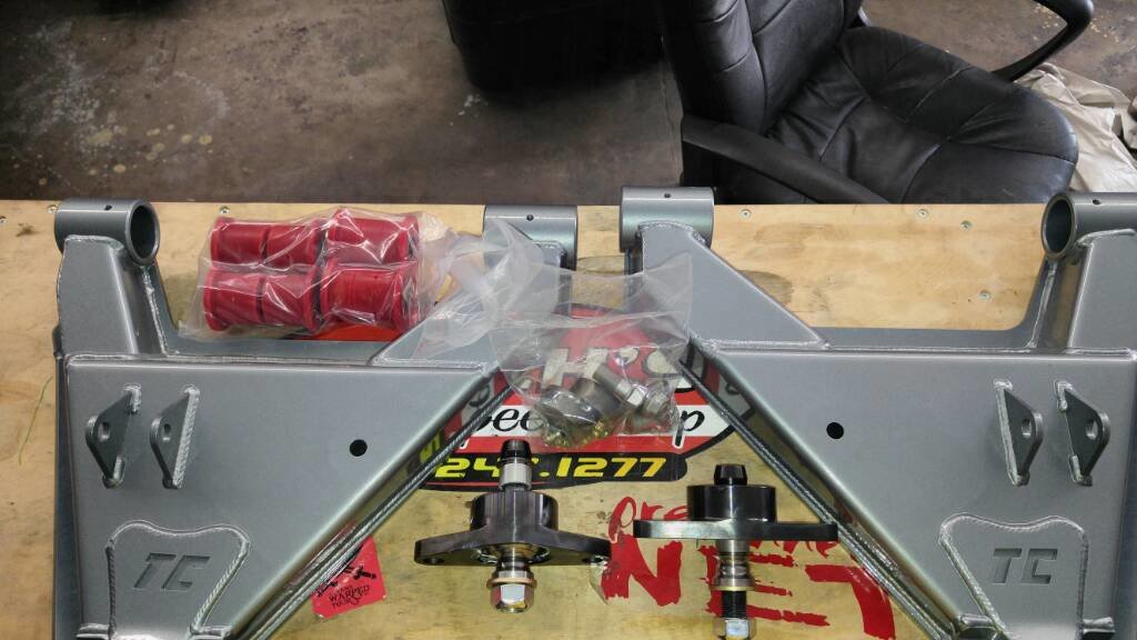

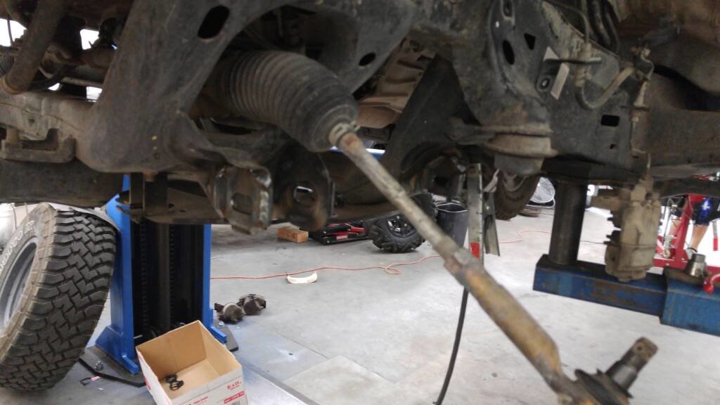

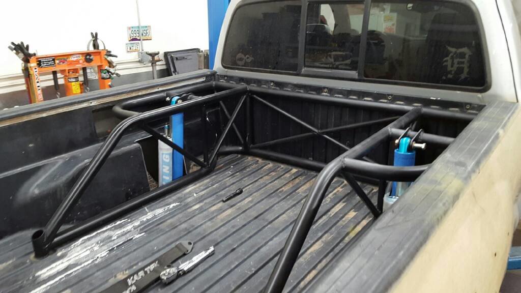

    Matts truck installed a Camburg long travel kit with Total Chaos spindle, cam tab, coil bucket gussets and secondary shock hoop. More to come.....

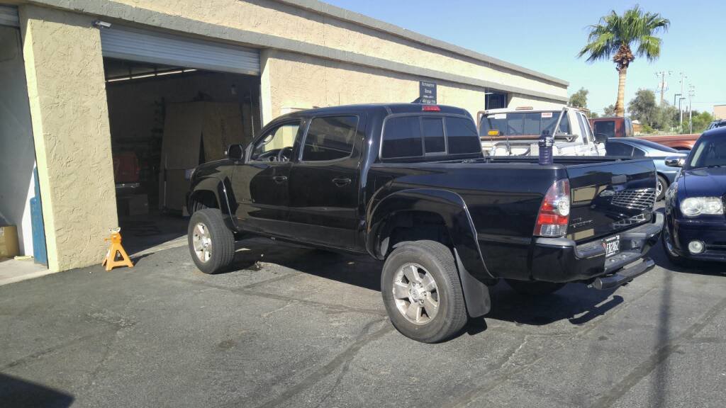

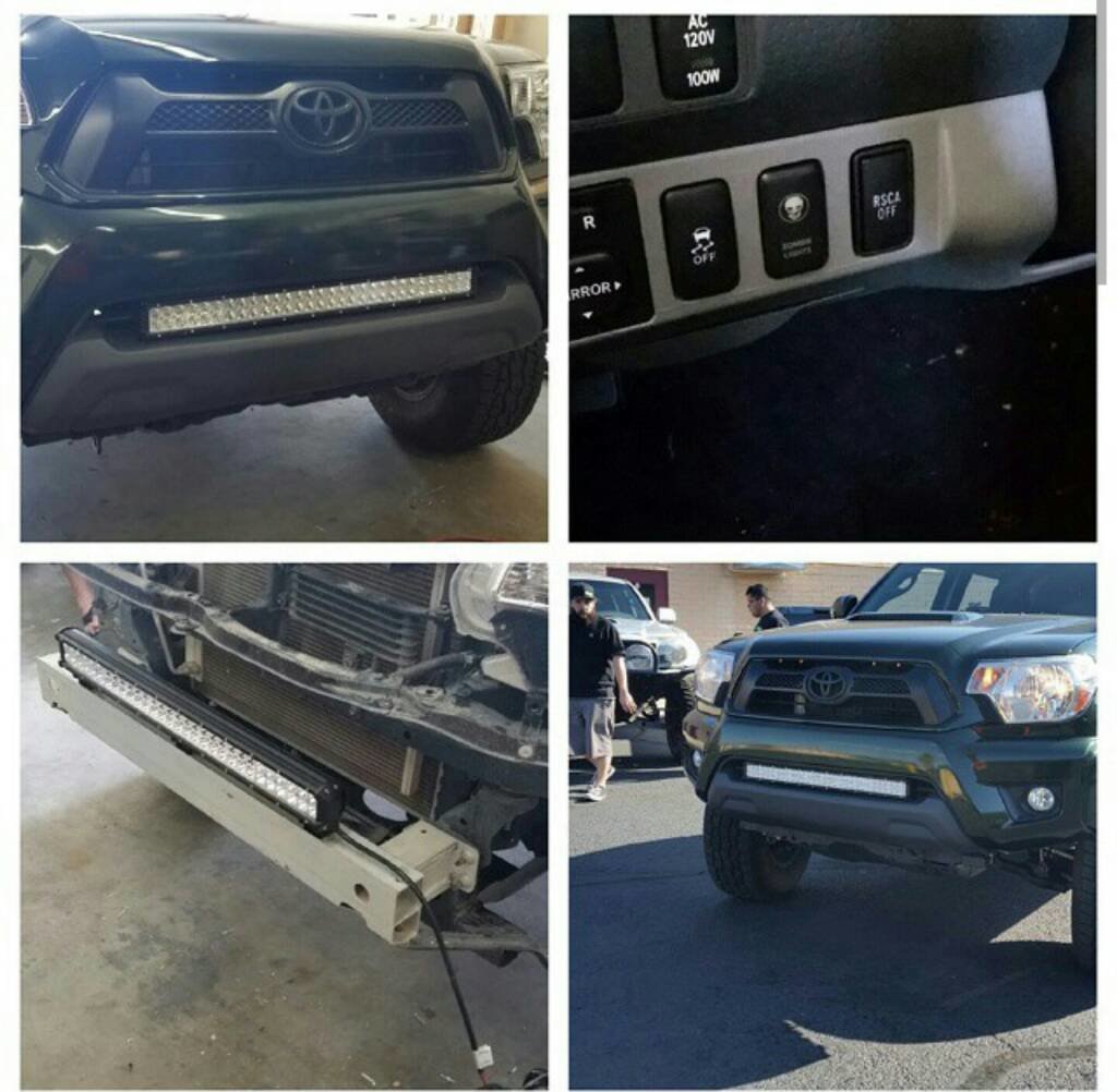

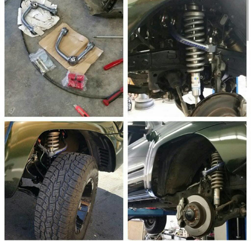

    @05TacoRunner
    @Harders1's truck.
    Changed height on 5100s, installed Total Chaos upper unibal control arms, and 30" light bar in the bumper.
    5f8928beaab1980553c1e11ddec6631e_dec7533d000da269d5acbbf63224d450f249d5f5.jpgb4d58d4069afdc09bf2b719a1f1211f1_9c97330eb6ccffb4cb878043204cf0fcfae4e202.jpg

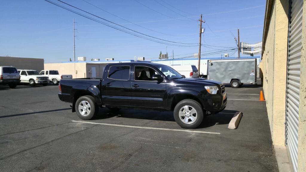

    @jaddels
    Max trac 4" spindles, bilstein 5100s at stock height setting, Dakar leaf packs and extended brake lines. Wheels and tires coming soon....
    b302ffcc9d439074d8fbdacfb8117141_752161a958a8994bffb257a4e4cef97faaf2e0e0.jpgcd2295f643bde6adf74065e543d4dc56_e192603628a60e41cce6b93b416d136fe76e50ca.jpge42d89120453166e06952a6a146a4327_269b451a4735b64cc153a6896558defc6a9c3c70.jpg

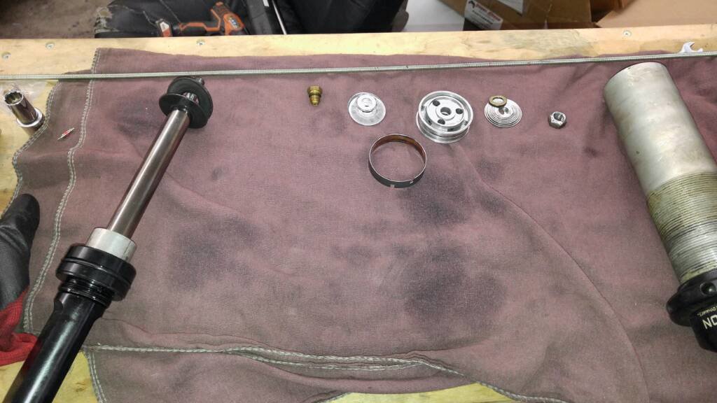

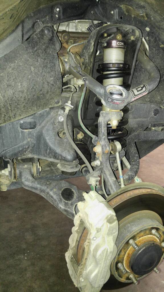

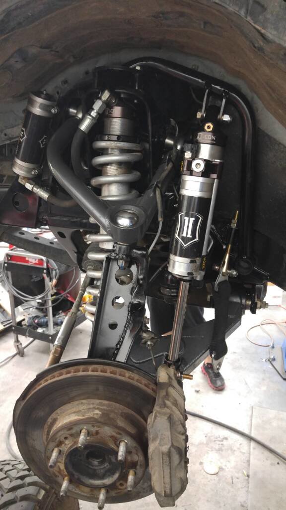

    @Dessert Drifter
    Out with the old....
    Pulled Icon coilovers and revalved with 15% stiffer valving, fresh rebuild.
    Installed new Total Chaos stock length lowers and removed the sway bar.
    Added a tiny bit more preload to level the truck out.

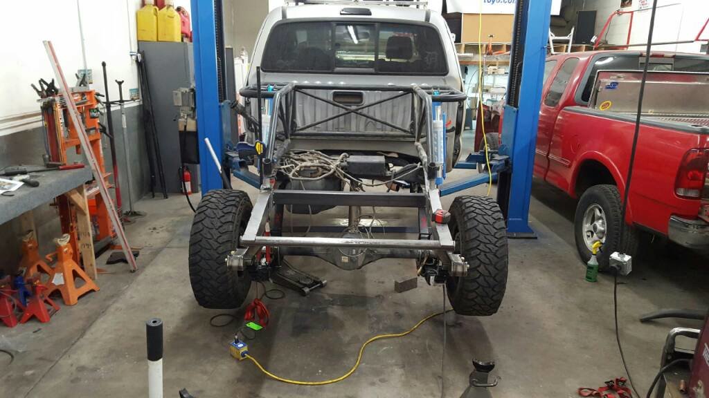

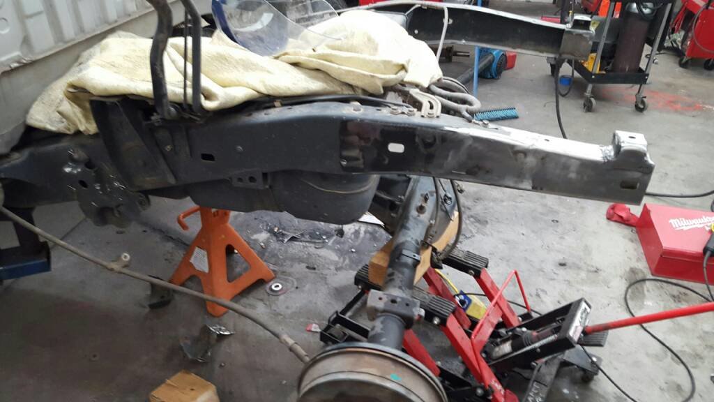

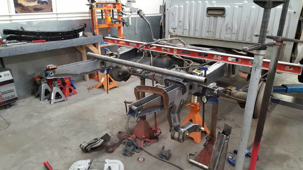

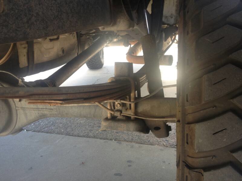

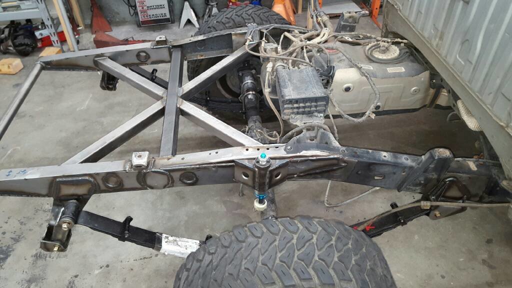

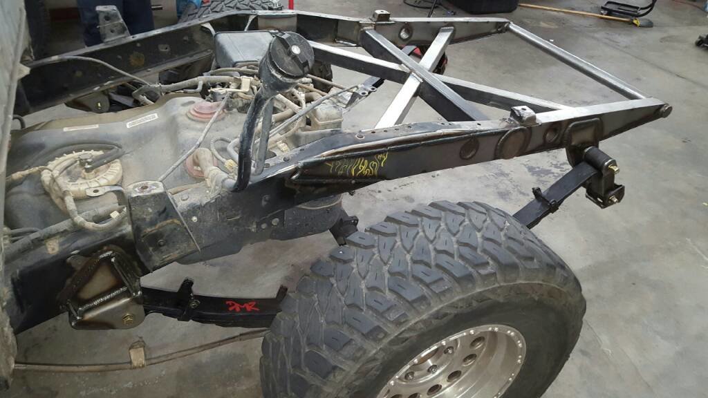

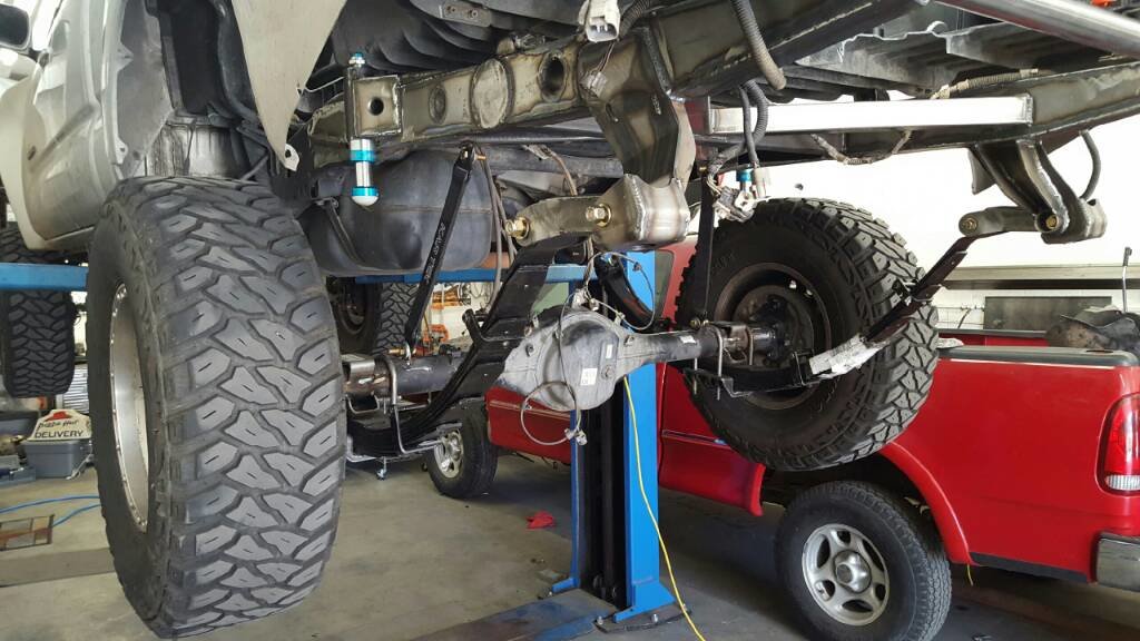

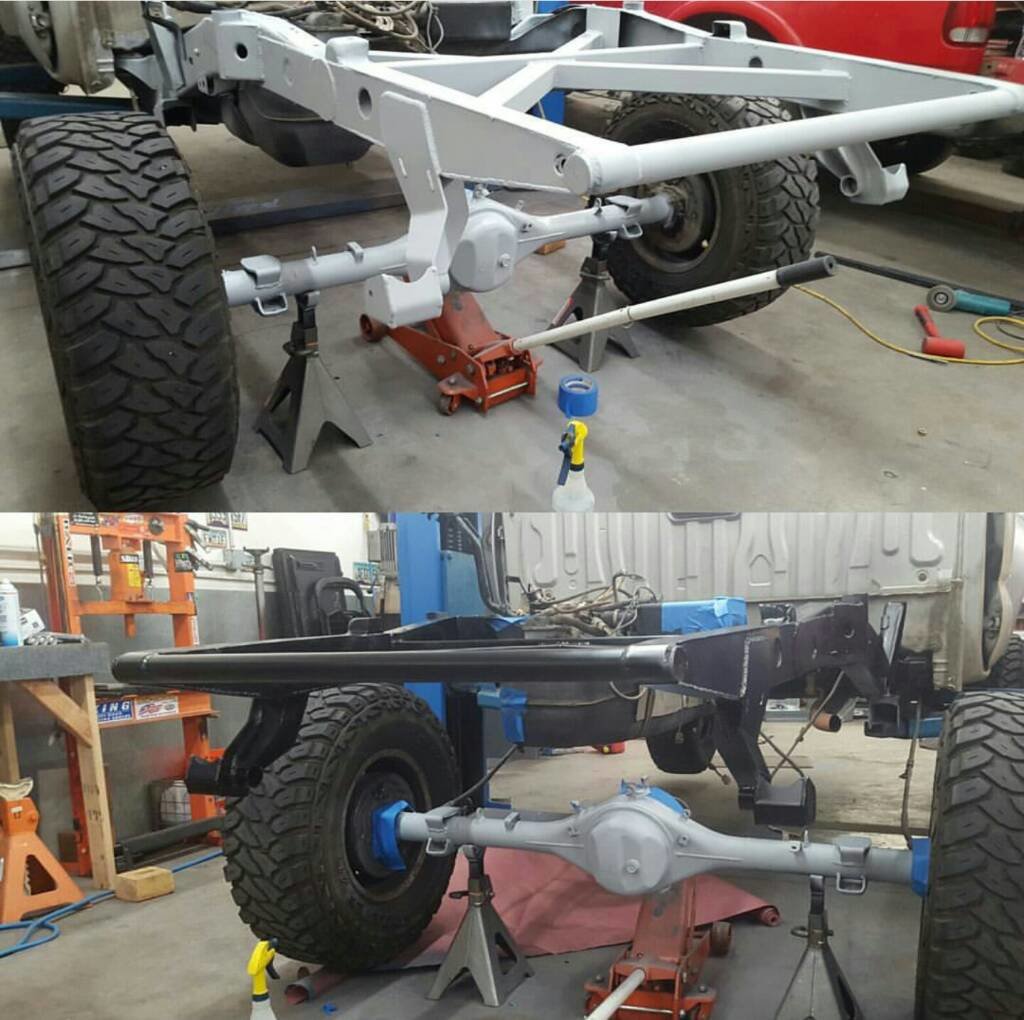

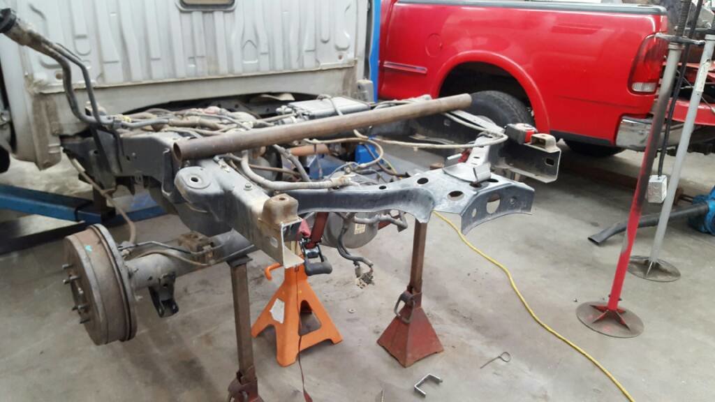

    Just finished up a DMZ spring under kit install on a new customers truck. 16 inch double bypass kings and king bumps.......
    Before....
    During......

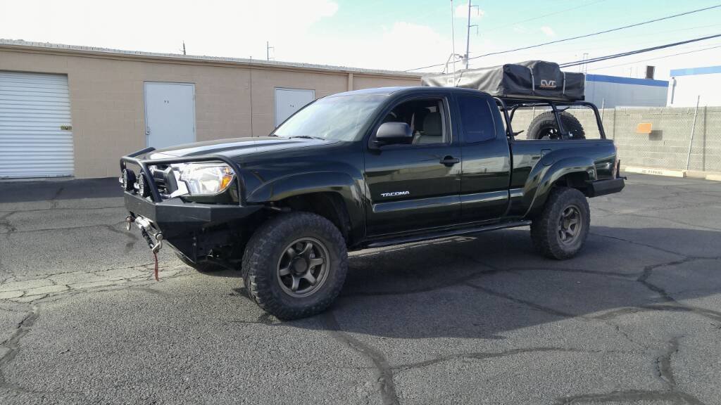

    And one more for the hell of it......

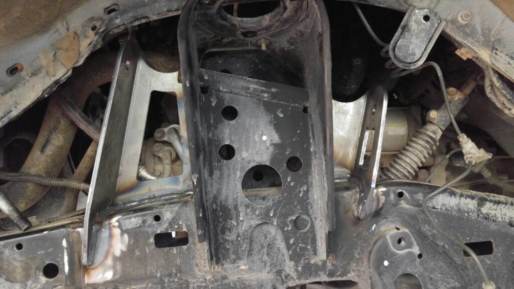

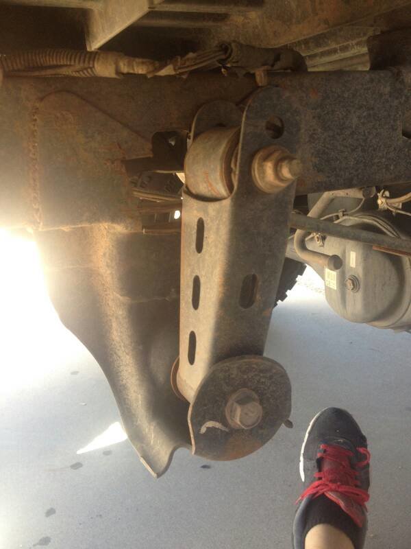

    I Thought I tweaked my shock tower so we added some gussetts in there.
    After I cracked my LCA mounts he installed the TC gussett.
