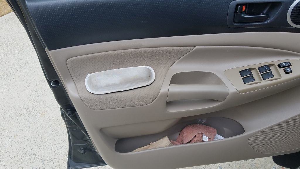

    So both the armrests on my new/old '06 Tacoma are totally broken. No ripped fabric but definitely busted plastic underneath.
    It feels like pretty much the whole pattern is broken like a perforated waffle. It's amazing that I haven't driven my whole arm into the inside of the door which, I'm sure, would be painful and likely dangerous especially on the road.
    I'm going to likely pull my doors panels off and put some JB PlasticWeld and maybe make some armatures out of heavy wire or something.
    Until I can see how bad it is I won't know the extent of the damage but I can tell it's not too good.
    Should be a fun couple hours of swearing and being annoyed at poor forethought on the part of the 'Yota engineers!

    I did the broken arm rest repair, and it turned out crappy. If you plan on repairing using plastic weld, be sure you have 2 people working, so one can keep proper pressure from the fabric side. I did mine alone and it does not line up very well. It is too late to redo it, because I fiberglassed over it. I will search for a used door panel in great shape.

    go buy a small fiberglass repair kit. I used a couple fiberglass sheets and its so strong I can put my whole weight on armrest and its sold as a rock. good luck

    I used jb weld on mine and somehow it didn’t hold after a few months

    The plastic needs to be roughed up before the JB Weld will hold, and after it sets overnight, you really need to reinforce it with fiberglass mat. There is now a ready to use fiberglass repair that does not need to be mixed. It is called FiberFix Ridged Patch. It was a SharkTank promoted product.
