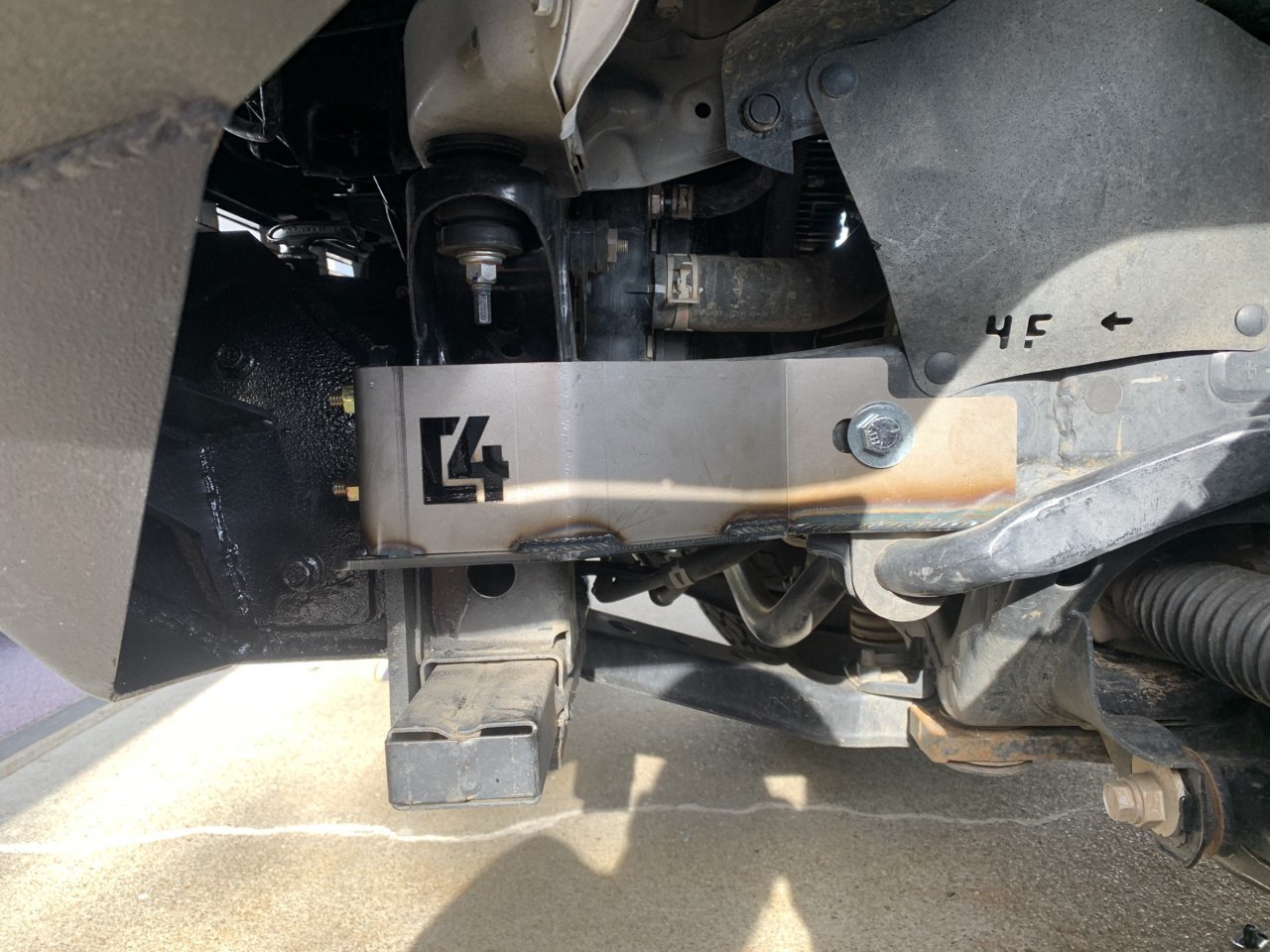

    Another tip for these bumpers. If you want to strengthen the mounting and get extra support brackets, C4 Fab brackets fit pretty easy. I had to grind one corner about 1/4”. And You’ll also need to replace the factory mounting studs, and install longer bolts with washers. The fit is great. And adds support.

    We DO NOT recommend the brace from c4 fabrication. That was a band aid they had to come up with after people started complaining of their bumper pulling away form the frame horns. We took this into consideration when we first designed the bumper going on 4 years ago, so NO ADDITIONAL bracing is required or recommended. About the only thing this is accomplishing is to remove your crumple zones, which you'll want, if you are in an accident.
