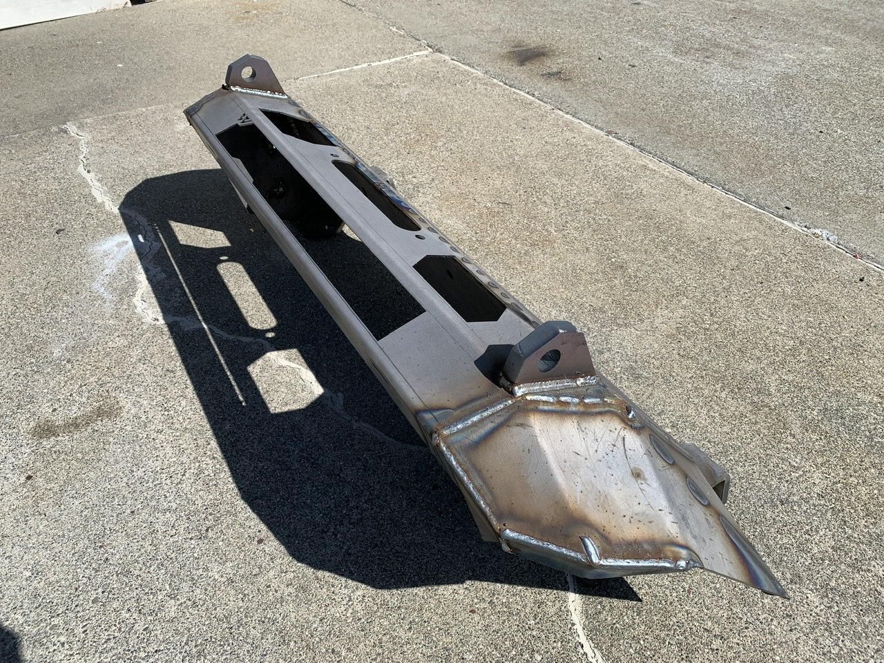

    For those that will be doing this:
    the difficulty I had was not having a welding table. My work space was my driveway. Lining up the brackets to be welded without a table require me to get a little creative. I used two 2x4s. The straightest ones I had. I sandwiched the bumper bracket tabs between the two 2x4s and screwed the 2x4s together. This held the brackets in place and hopefully straight.. i did check with a straightedge aswell.
    WrecklessAbandon likes this.

    Complete for now.. until the stage two gets here..
    whatstcp, bodean and WrecklessAbandon like this.

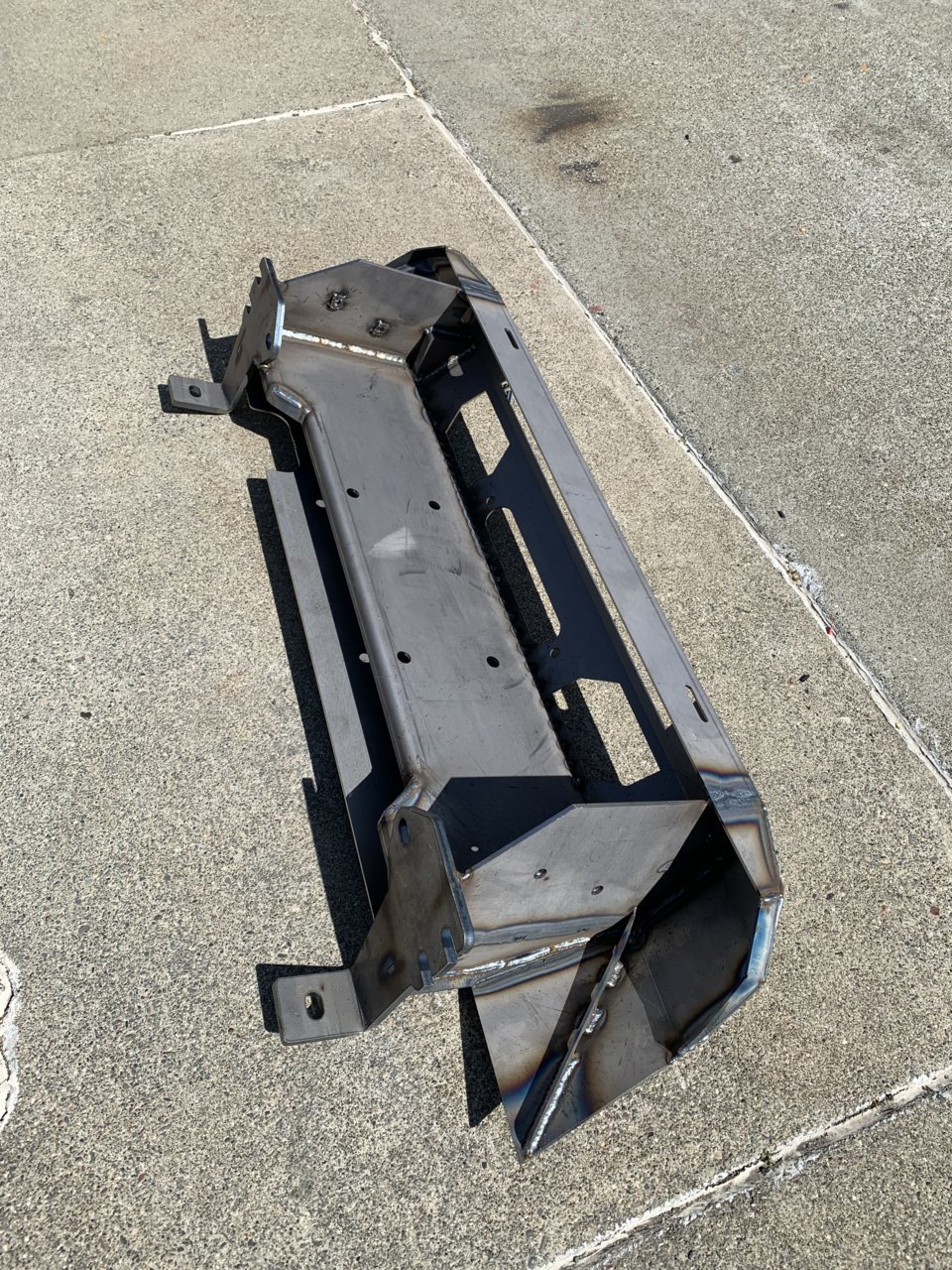

    Another pic

    Did you tac then test fit to ensure everything was squared up or just weld?

    I did not. My truck is still in one price at the moment. I went through th
    I followed the SSO Armageddon video. And everything kinda only fits together one way. It seems that as long as the tabs are straight with each other, the distance between is set by the winch plate. I don’t expect to have any issues. I’ll keep you guys posted.

    You planning to finish it off and grind the welds down?

    haha yeah, gonna wait for the stage2 to come in so I can weld that on it aswell then clean it all up. My welds aren’t pretty enough to display. Ha

    Well Chit... wasn’t paying attention I guess. Didn’t notice the rivets and believed that it was square, so I welded away. I stepped back and thought that don’t look right haha. Will grind my welds off tomorrow I suppose and make sure it’s “square”. Ya Live and ya learn I suppose. Ps: gotta love flux core.

    Fwiw, those same mounts that bolt to the underside of the frame, on my "OEM" unit, aren't perfectly square either. Test fit it, see how it looks
