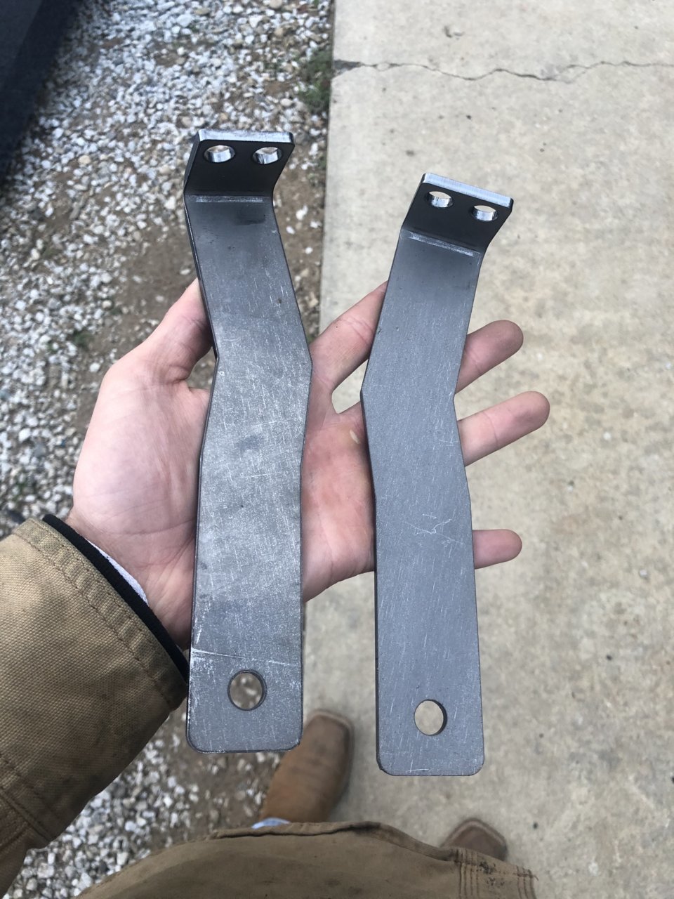

    Where do these go ?

    Working on those next! Well, maybe after a roof rack we've already started.
    Those are to attached to your OEM plastics to keep it all sturdy after removing the center section
    Skydvrr and calebc like this.

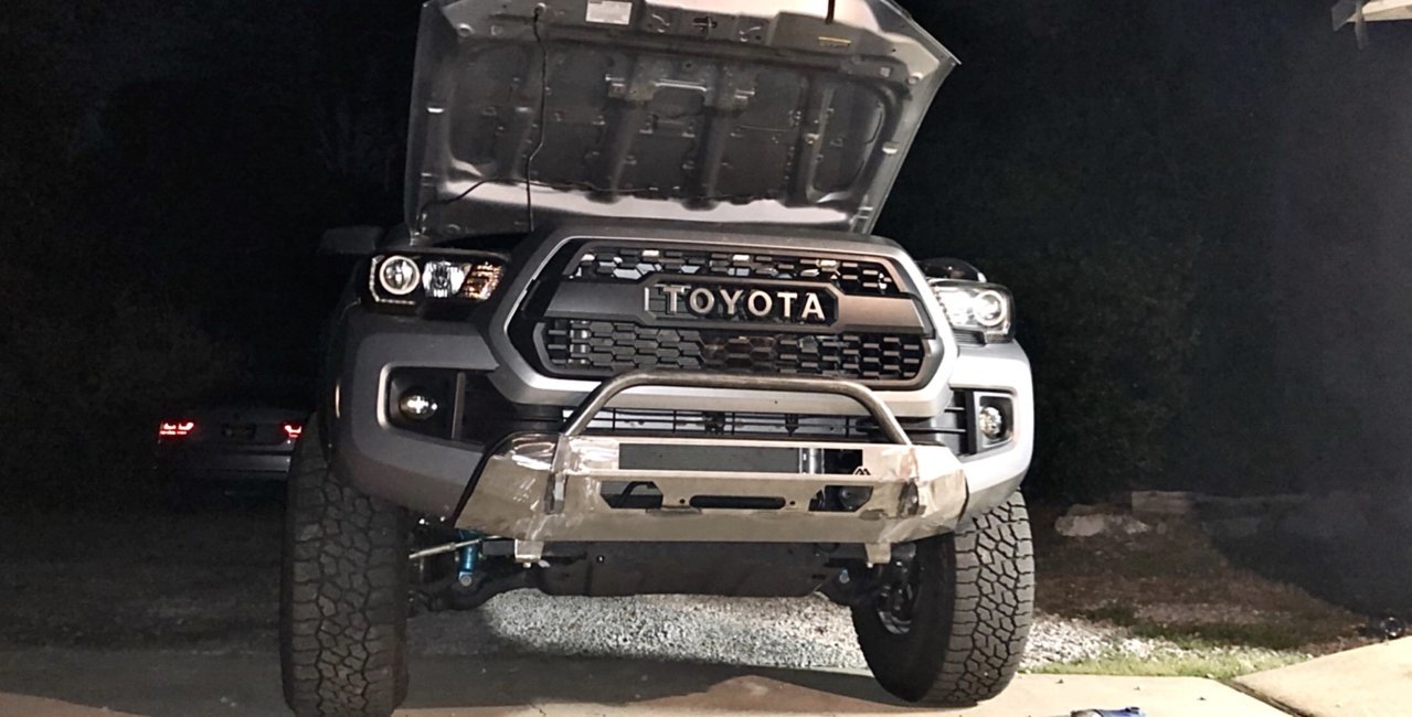

    Still need to sand and grind everything a bit more but “done” also need to clean up all this flux core splatter. Anyone have an argon tank for sale :spy:

    Fully welded up to the point where the wings are added on.
    I'm going to pickup an argon tank for that, don't want spatter and slag all over the place.
    My welds look pretty decent tho.
    Hardest part so far was dealing with the gap between the winch tray and the outer cover. It's no much, but it's difficult to fill. I'm going to have to do 2 passes to get good fill on my stitch welds there.

    I didn’t know where they went either so they got tossed. Haven’t had any issue without them yet with bumper and wings installed.

    Yep, I'd go for the C25 gas (75/25 Ar/CO2) to get less splatter than straight CO2 but get a better weld than straight Ar (for mild steel).

    Yea I know it's a blend, it's just a habit to say "argon" when really it's a 2 or 3 part blend.

    Depending on what size welder u have, u might be better off w flux cored wire. The polarity is different and u get better penetration than solid wire. Might be a moot point but something to consider.

    I'm using a Hobart 140, and yes I would need to flip the polarity around.
    Shouldn't have an issue welding anything on the front face of the bumper, except the 1/4 shackle blocks. Those will get flux-cored.
    I just don't want to spray antispatter all over the face of the bumper, and then have to clean it all off. I guess it doesn't matter because the whole thing will get sanded so.... Moot point all around.
    I just love the puddles you can make with gas. Harder to see with fluxcore.
