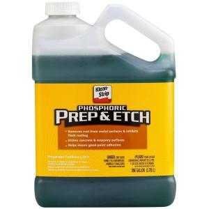

    I suppose ARB (and others, like Slee) disagrees. Powdercoat is fine but it's like any finish - all about prep and quality. I had my rear bumper powdercoated with an epoxy zinc-bearing primer under a typical satin black polyester top coat and it's been holding up fine in a relatively less aggressive state for rust.
    The only step I didn't do like ARB and Slee is a professional phosphate dip. I had the bumper sand blasted and then just did a wash with phosphoric acid myself with the stuff you get at the hardware store.
    I have done sliders with a cheap one-layer powdercoat job and it predictably chipped, rusted and flaked off. I don't disagree with you that rattle can jobs in comparison are cheap, easy and quick. But all finishes can be done right and wrong. The benefit to doing spray paint is you can do a pretty good job yourself and it's not difficult to clean and redo yourself periodically.
