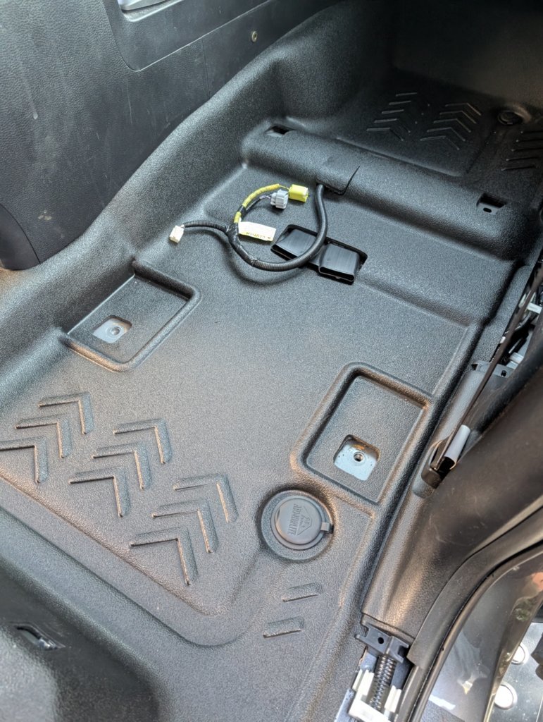

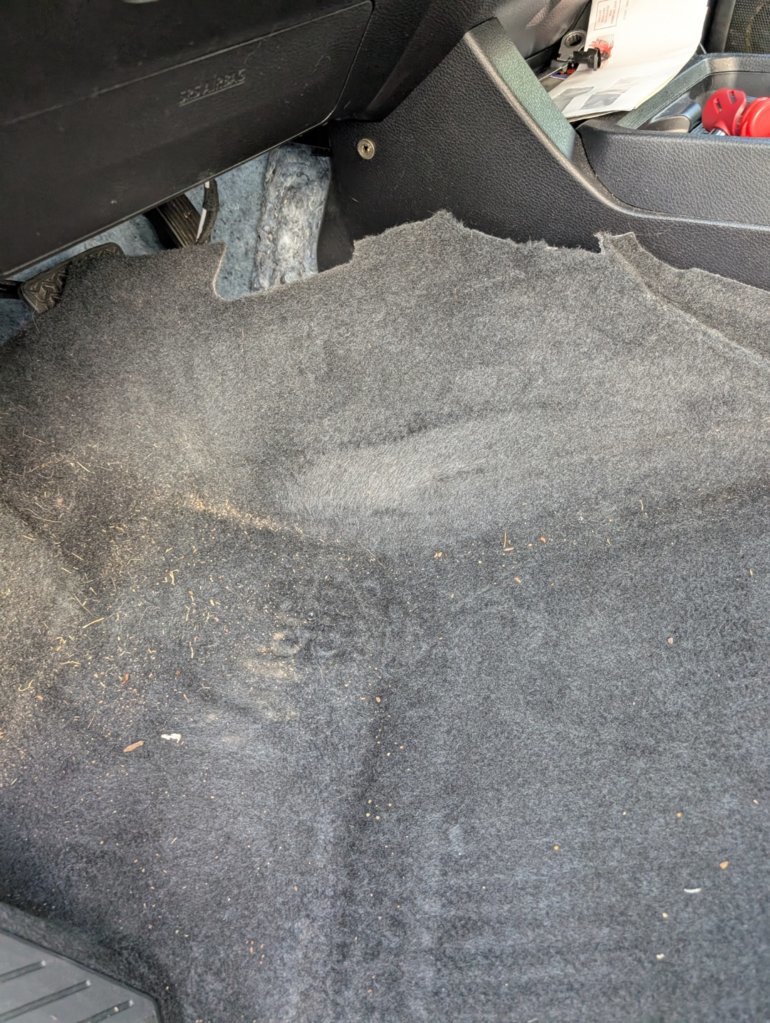

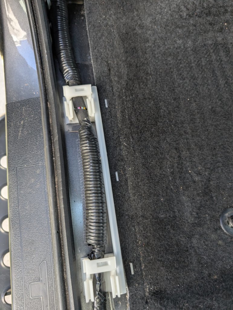

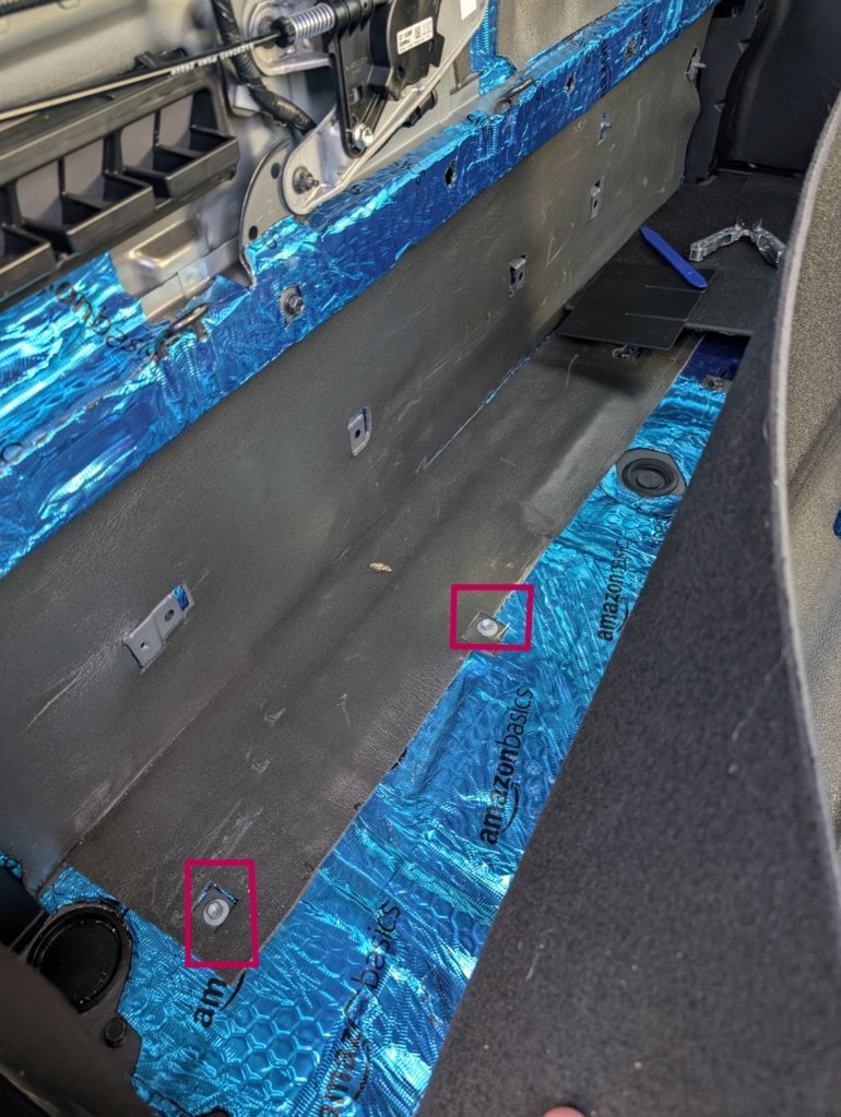

    So, I couldn't wait and did the install at 5 on Friday. I did follow their instructions, which were provided online here.
    I think the noise level is nearly identical if not somewhat more quiet than the OEM carpet (also havent put the rear seat delete back in yet).
    My installation time might vary as I did not have rear seats (had a rear seat delete and only had to remove two bolts):
    • I believe it was around 3.5 hours (kept having to stop due to the heat)
    The following is what went wrong during my install (some them are no fault of
    armorlite):
    • I was too rough on the driver & passenger side kick panels and ended up breaking one of the clip retainers in my effort to remove them
    • I accidentally unplugged extra cables removing the driver seat
    • Some of the pictures & instructions didn't quite line up with my model year and trim (2021 DC AT TRD Sport)
    • I accidentally destroyed some of the threads on one of my driver seat bolts (tap & die set FTW)

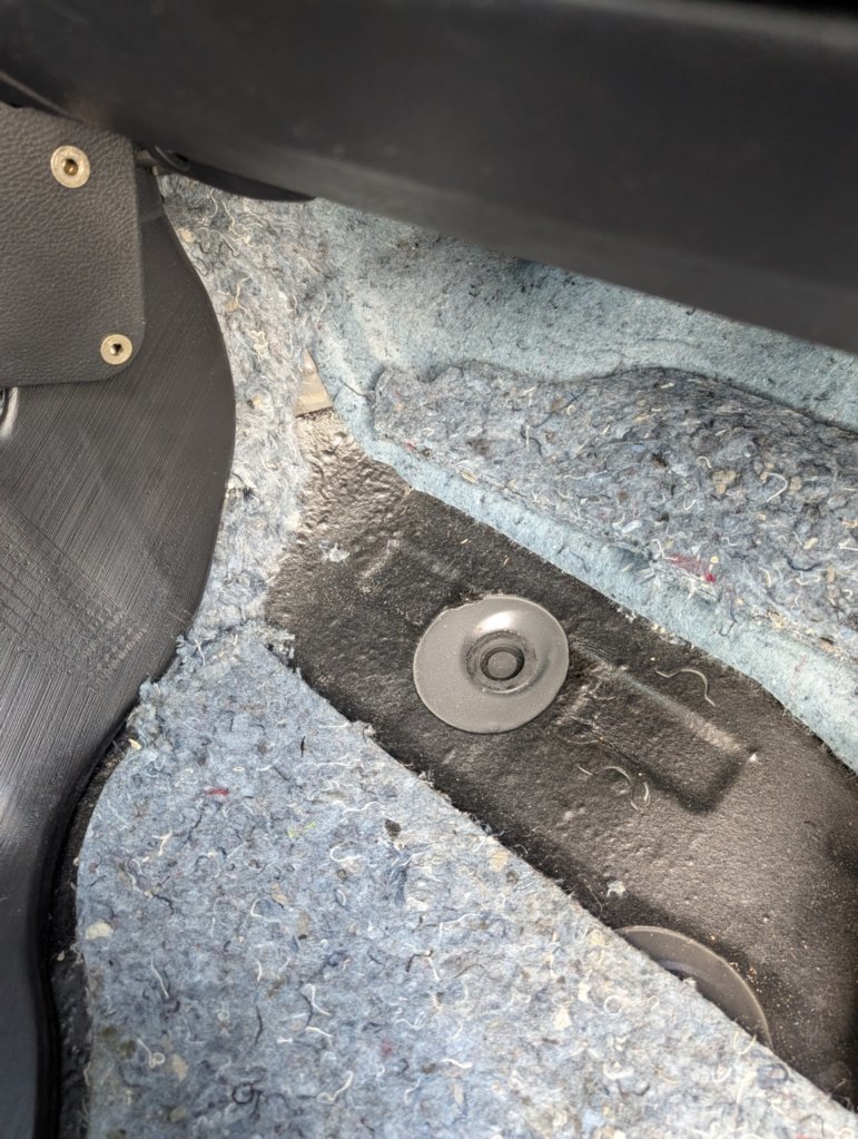

    • Some bolts are covered near the back wall (the OEM carpet stopped before these bolts)
      • I'm not exactly sure what these bolts are for

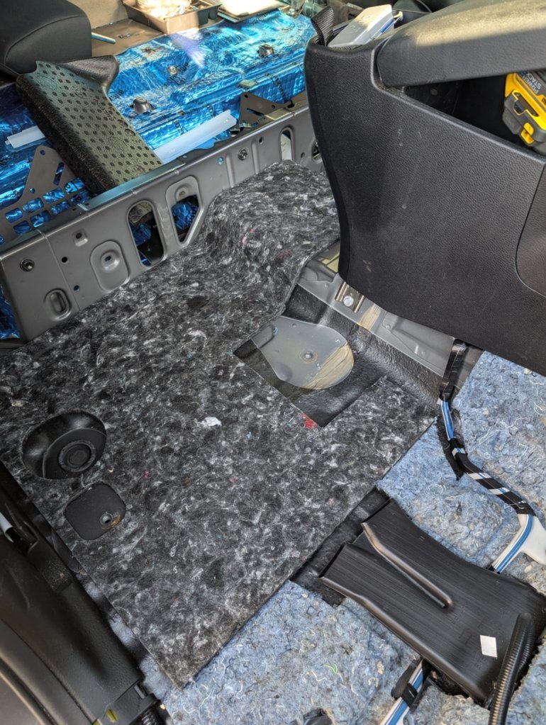

    • Accidentally cut too much insulation on the passenger side (behind the seat mounting bolts

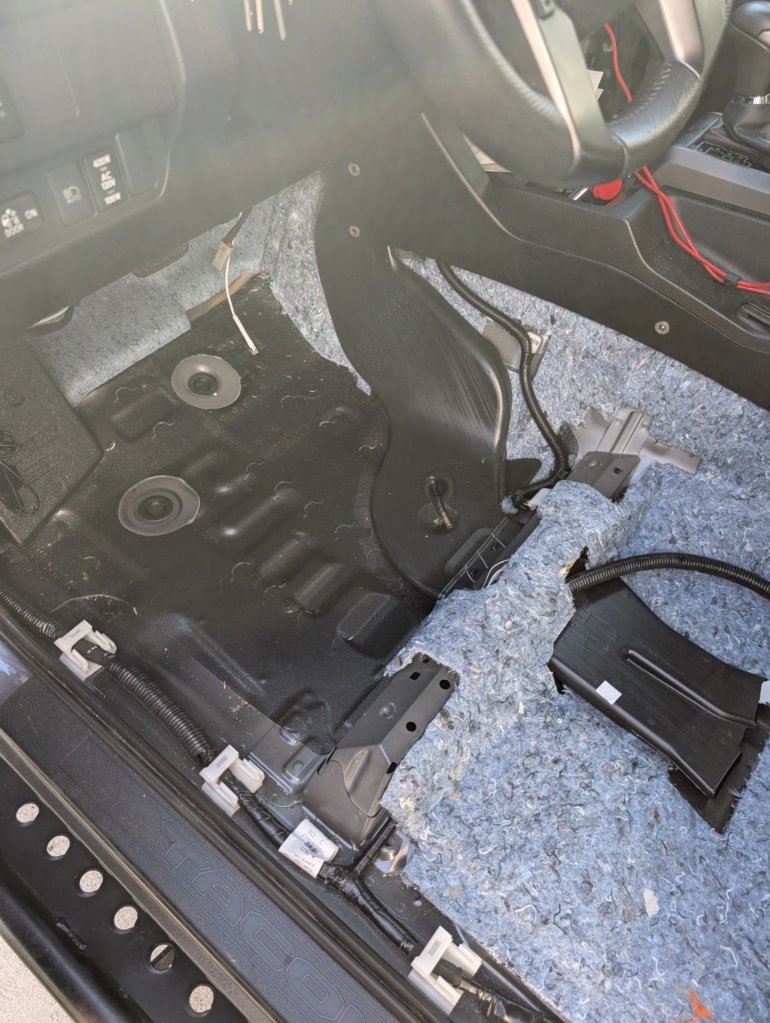

    Tips for installing the floor:
    • Use a box cutter or a razor blade knife for cutting the insulation
    • Use a pair of scissors to cut the carpet that goes above the transmission tunnel
    • Remove the plastic pieces attached to the OEM carpet in the door sills (its stapled in and makes removing the carpet easier)
    • Remove the bolts in the center console so you can lift up on it

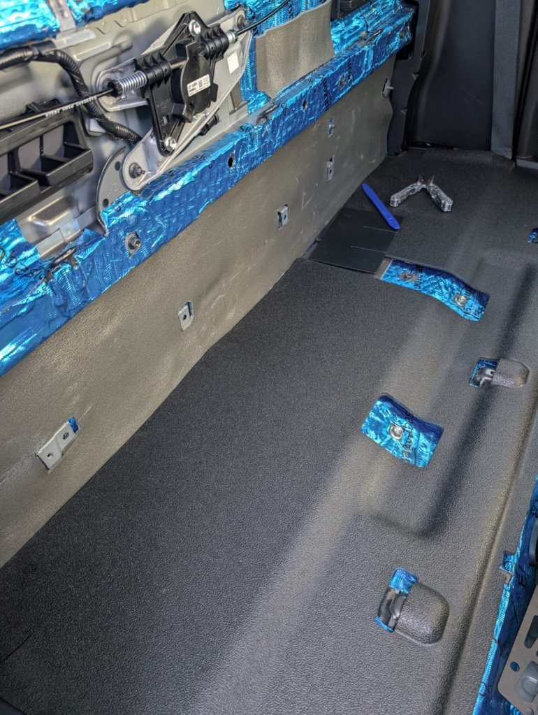

    Full floor installation pics (without seats):
    tacoma_floor_rear_armorlite.jpgtacoma_floor_pass_armorlite.jpgtacoma_floor_driver_armorlite.jpg

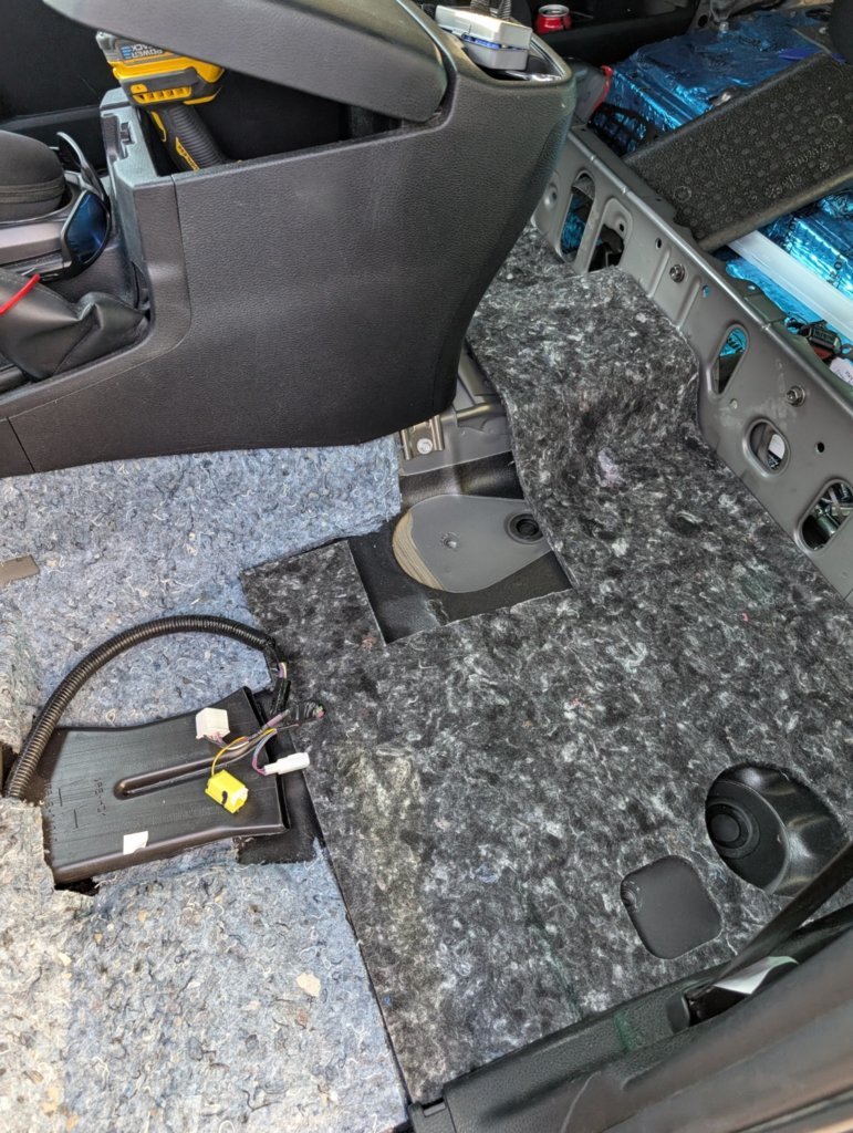

    Pictures of how I cut the insulation (tried to be as close to possible with the instructions):
    Driver Side:
    Passenger Side:

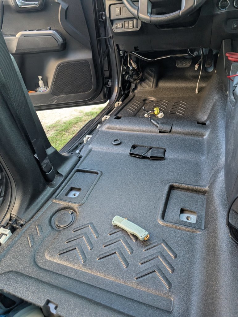

    Just got mine done yesterday, no more dog hairs infiltrating every dang carpet fiber there is. Stoked on the new look and ease of clean up in the future.
