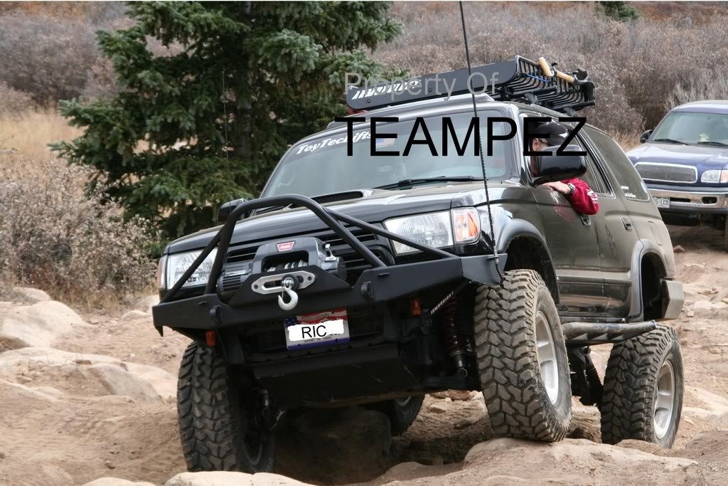

    you know my opinion,lol "you get what you pay for" Ive seen (in person) what a TJM will do when it makes contact with a rock, NOT pretty, lol
    and your correct, they will make what "you" want, it will built to your rig, there is NO play at all, he ads a few mounting points, they are ROCK SOLID.
    Im very happy I live close enough to them.
    heres a few pix of mine on my 99
    http://www.tundraheadquarters.com/blog/2007/06/28/one-bad-1999-toyota-4runner/
    Mine has pushes rocks, dropped on rocks, even "tried" to move boulders, lol didnt move the boulder, but didnt hurt, bend or even move the bumper, lol when I say they are ROCK solid, I mean they are ROCK solid, lol
    Ive had experianced welders, ask me who made my bumper, they said its the best they have seen, the welds are perfect, the design was great, being that Im not a welder, this comeing from welders I dont know, I take it as a big compliment, some have even called it "artwork" lol Im saving now for both front and rear bumpers :cool:

    well Ive seen for myself, that a TJM will move and bend, they will bend into the sheetmetal, headlights and grill.. they are not as thick and have as many mounting points as a custom bumper.
    Im going to gues that your talking about frame flex, but You are correct about frame flex, all frames will flex (move) when the rig is flexed out, which will make it seem like the cab is moving, TJM, ARB and most other bumpers like Shrockworks ect. do not allow for frame flex, most are built with very little room or tolerence to the fenders and headlights.
    I know that Armorology bumpers, DO allow for frame flex, remember this guy not only builds bumpers, but he builds compt. buggies, lol he went to school for design, fab work, lol.
    The mounting holes on most bumpers are drilled bigger than the mounting bolt itself, to allow for the differences in rigs, if the bolt is say a 1/2" in dia. most mounting holes are drilled/made 3/4" for this, and when on a trail, if the bumper taps a rock or tree, it WILL move, not matter how tight you get that bolt, Ive seen it. With Armorology, if the mounting bolt is 1/2" in dia. the mounting hole, is a 1/2" dia.
    I know I cant explain as well as a true custom builder, but what I do know is, if other custom fab guys are saying the Armorology`s stuff, is the BEST they have seen, I take that as a pretty big compliment, I personally know of 3 companies, trying to duplicate his work, There competition has even said that his is the best, the strongest, the most attention to detail, the best welds they have seen.
    No I dont work for them, I LOVE there work, and thats where my money is going. :cool:

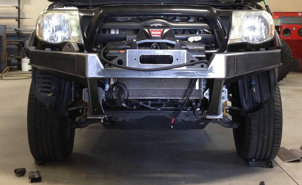

    finally got my truck in for a front bumper setup. just as you've read in other threads, armorology does custom work and has a waitlist out at least a year or two depending on the size of the work. i don't need my truck now so jed has it until mid-july. for locals this is fine; however, i looked at his schedule and he also has several vehicles coming in from out of state. if you can afford some cash and some time, you'll get a pretty awesome custom setup.
    i'll update this as i get photos from jed. we're doing a bumper with one large hoop, some bash plates with a cutout for a 20" vision x reflex bar, and a warn zeon 8s.
    *****UPDATE 17JUL13*****

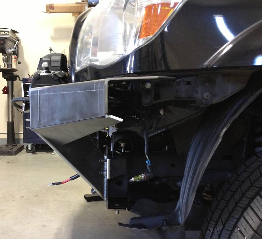

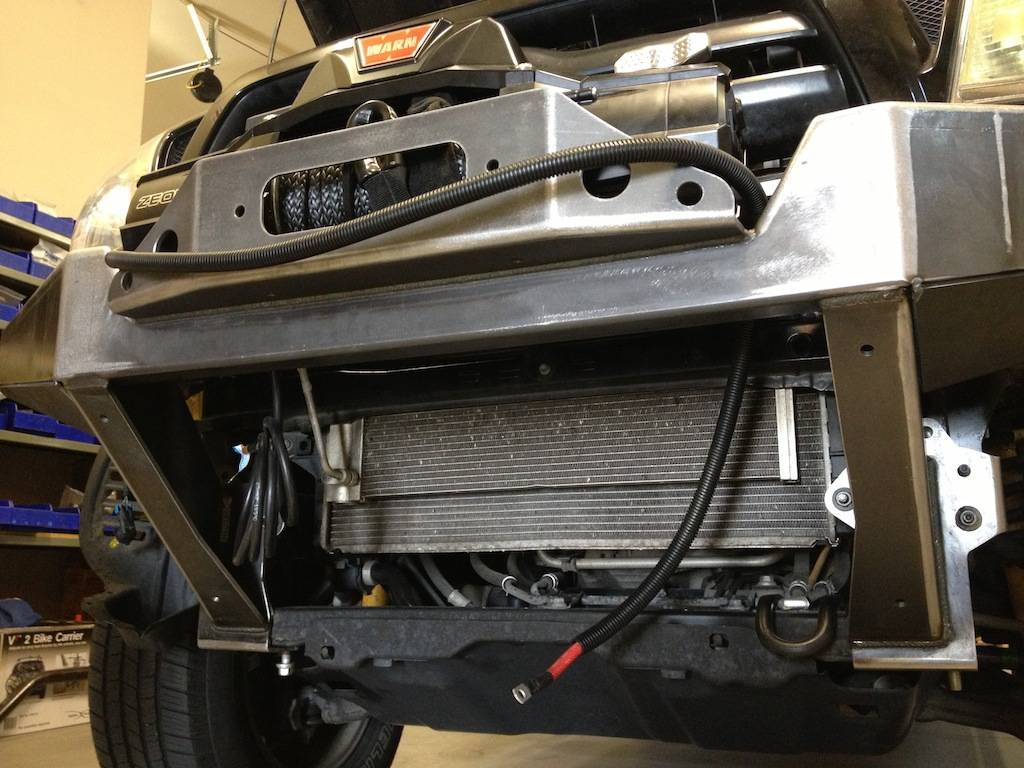

    i went in to discuss the build so far and see if we needed to change anything. i'm really happy with the way it's going. just as other people have stated the tolerances are extremely tight on the build.
    he's building the bash plate on the front and will final weld the wings under the headlights. will probably get around to adding the hoop and the recovery points later today and tomorrow. i have a 20" vision x reflex, 6 spots in middle and 2 floods on each side, going in right beneath the winch and he'll build the plate around that.
    here's the front. any way to black out the warn logo? i hate how it covers up the toyota badge. maybe i can just use a sharpie and scribble it out? hahaha.
    the bolts sticking out are temporary as he needs the bumper in place to do the final welds and adds the wings coming up to the fender. oem fog light wiring will plug into the light bar.

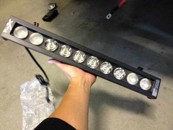

    sorry for the blurry photo. vision x 20" reflex, 6 10-deg spots and 2 35-deg floods on each side. vision x ships light bars with the 10-deg spots or 35-deg floods. if you want a hybrid, they basically build it for you and send it out to their lab to get dunk tested. then it's sent to you so shipping time and price is increased.
    i'll post more photos when it's close to finished or when i pick it up from jed. he's an awesome guy to work with, very mellow, knows his stuff, and i do my best to support local vendors the best i can. he also built my sliders a few years ago and i'm thinking about getting a bumper from him as well.
