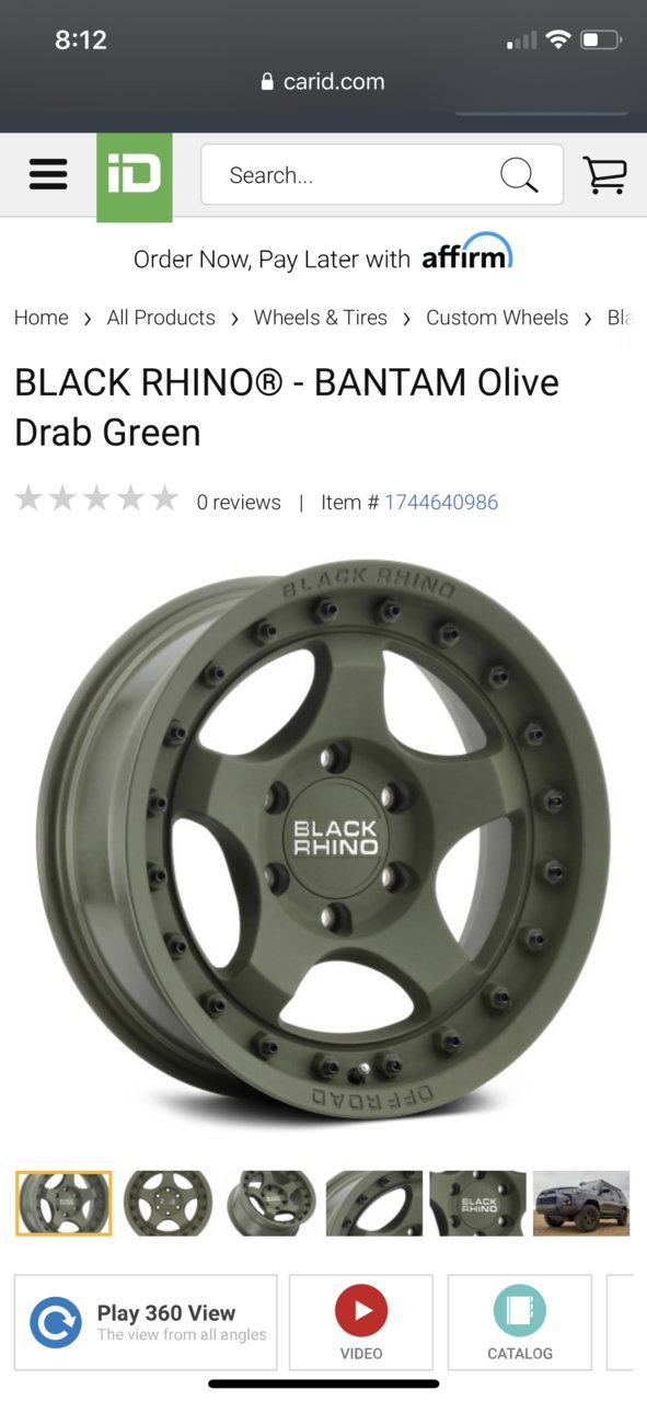

    All the AG Tacomas are insane! They look so sick. What you guys think about these wheels? Anyone rocking them? Too much green for one truck? I like em. 3C0CCCC9-BFD4-462C-9765-631334758F8D.jpg

    They look nice. I figure I paid too much money for the Trd pro package to replace anything at the moment. Haha. I just want to keep adding new components for now

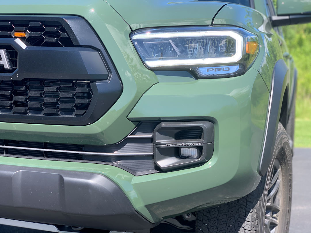

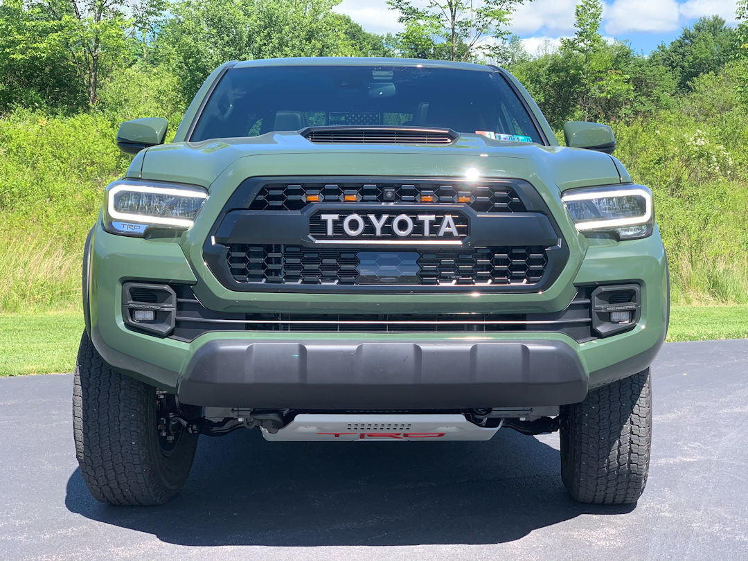

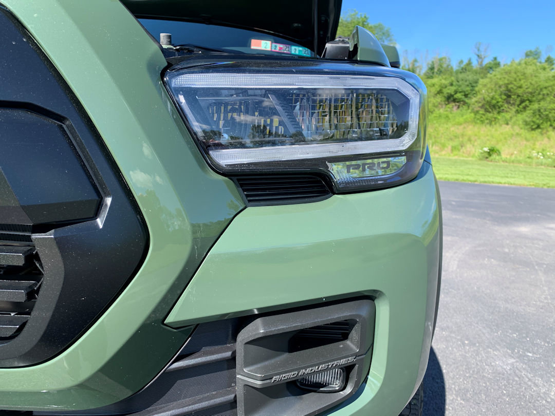

    Hey @Devious6 these trim plates look great. It's about time I install mine. Is all you need to do is remove the grill, then replace the plates? I remember something about some clips that tend to break. Also, was there a YouTube video you followed to help with the install? Thanks!

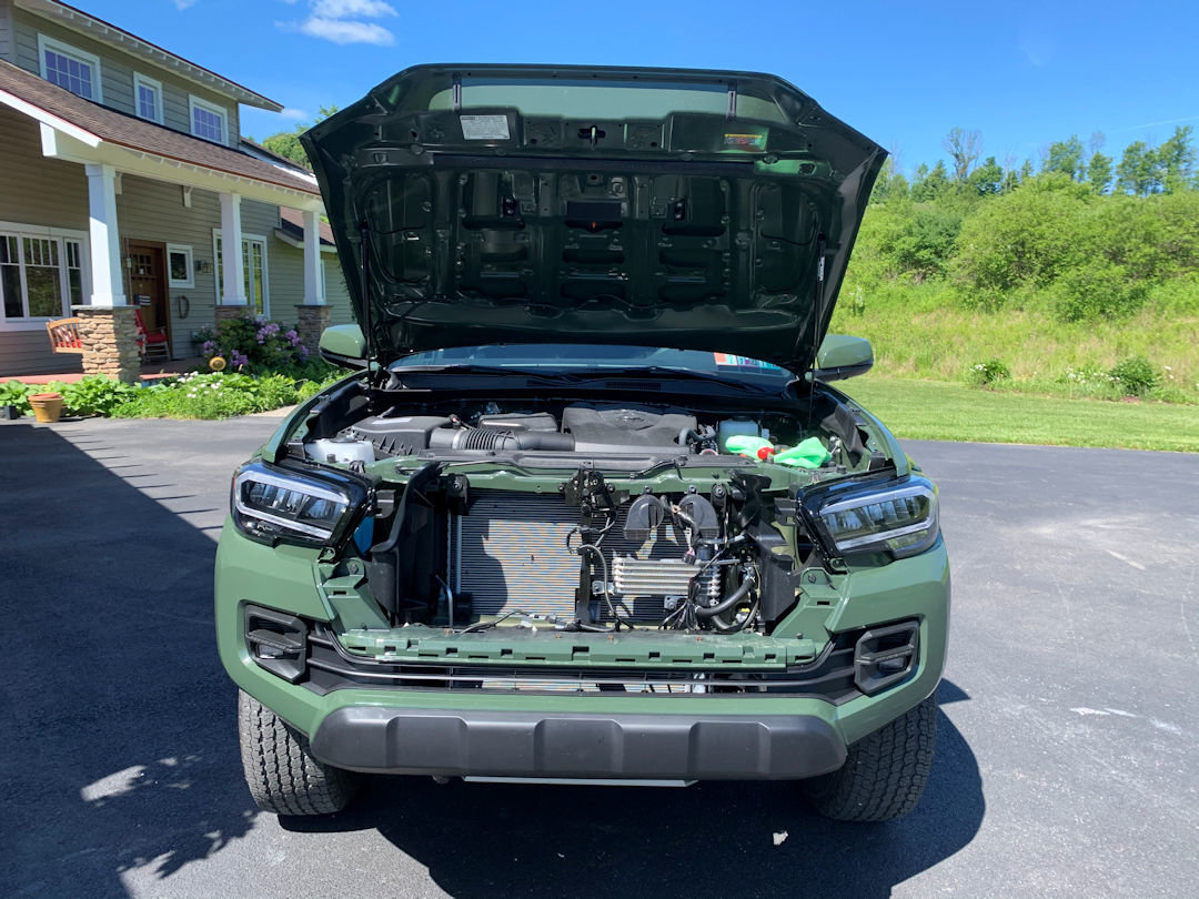

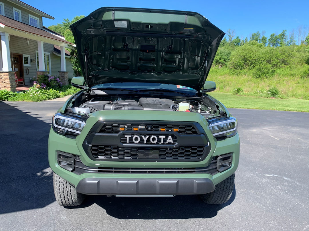

    To get at the lower screw you have to fully expose the headlights - so you've got to remove the grill, loosen the bumper cover and also loosen the over-fenders to pull the bumper cover away from the headlights. To loosen the over-fender you push out the two lower clips and pull the over-fender outward. The 3rd clip up is the "infamous" blue clip that often breaks. I was able to replace my plates without fully disengaging the bumper cover at the sides - got them down enough to get a small screwdriver on the lower screw. I didn't break the blue clip..but have two on hand just in case.
    Look at this video to see how to get at the headlights - you just need to get far enough along to get at the plate screws, not remove the lights. It's easier than it sounds. Post #7 I think : https://www.tacomaworld.com/threads/headlight-trim-plates.579829/
