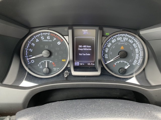

    Hi gang I think I posted this on another thread that I may have started. Not sure but wanted to reach out here.
    I just finished install of Meso 4x4 blackout ring and now my switch doesn't seem to work. Quite certain I put it back together properly but obviously missed something. She won't engage 4X4 and this is the display im getting.

    I did post this on an obscure thread and went back and was able to move it to 3rd gen. But if anyone happens to have run into this before ;)

    Most likely you put something back in the wrong way. Take it all apart again and double-check by watching his video and then try again. Luckily he's pretty quick to respond if its something more serious than that.

    Solved thanks to @MESO. Pulled the contact wires out a bit and she's good as new!
