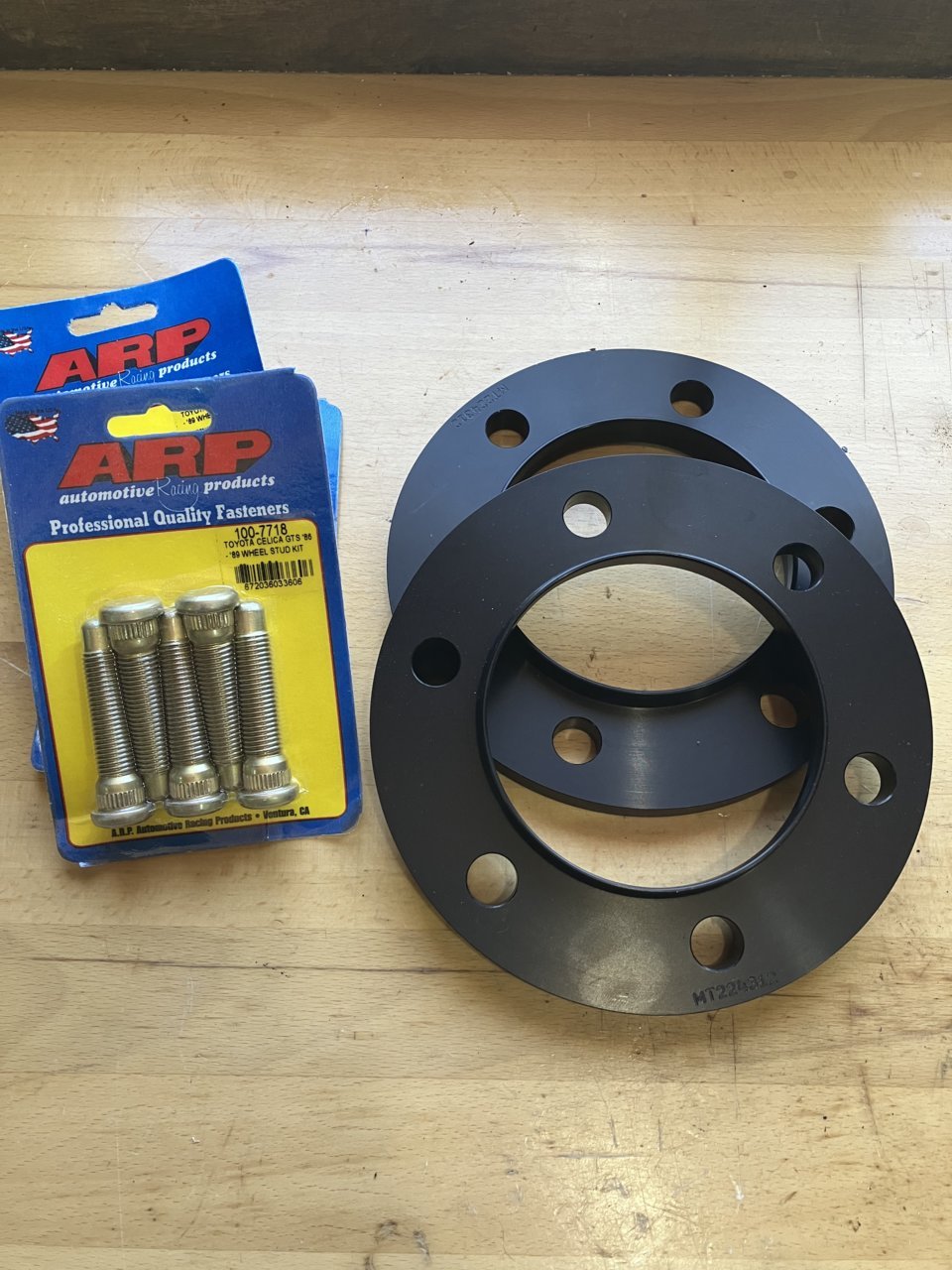

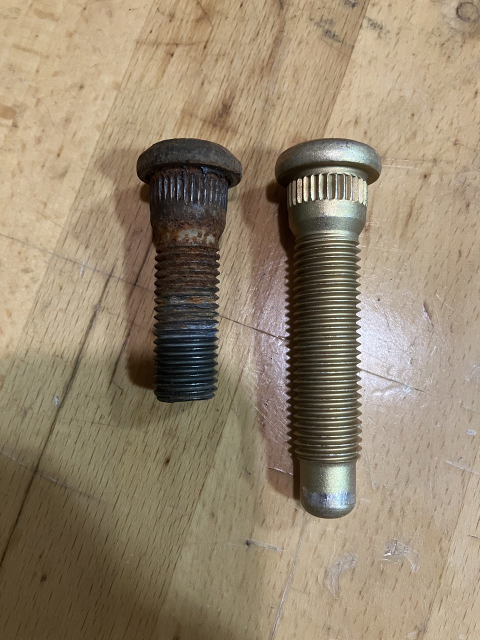

    Here are the perfect size ARP studs for .5” wheel spacers. A lot of the forums I saw said to use the Lexus studs and cut them to length but these ones don’t require any cutting.82820E32-28DD-494F-801F-495960D983DC.jpg 3AB46E5A-C828-4452-BCC7-300AEE78A8EC.jpg
