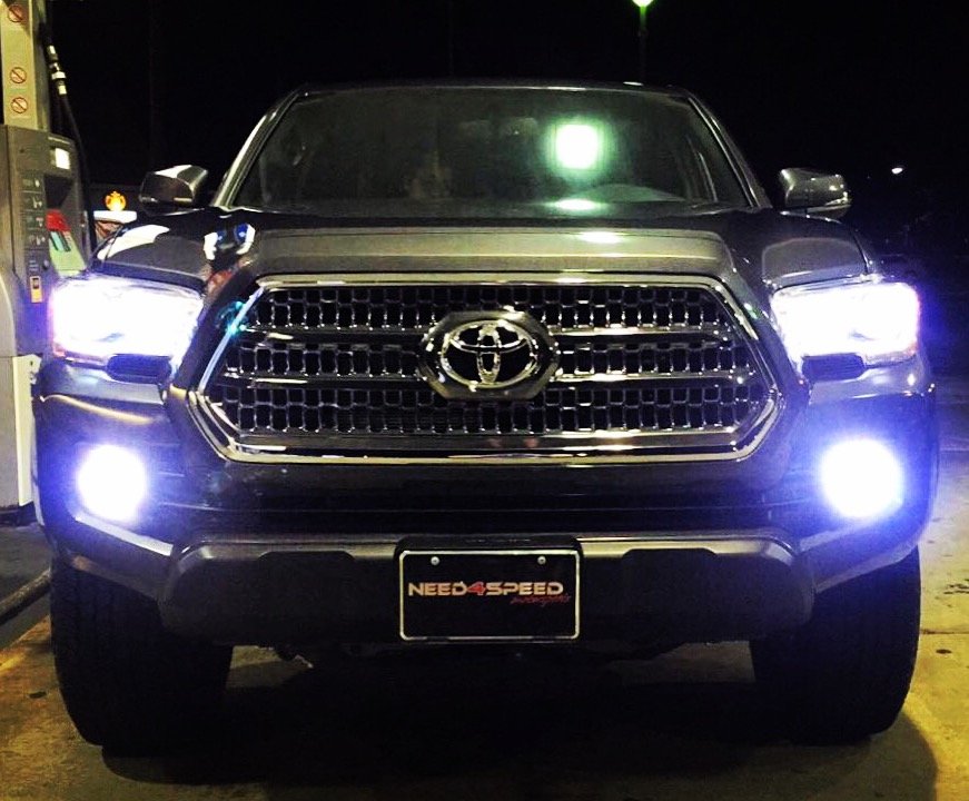

    HID Headlights, LED Fogs

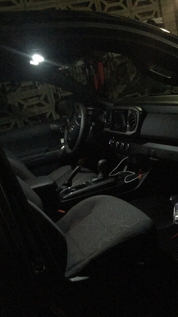

    LED Map lights and Dome Light

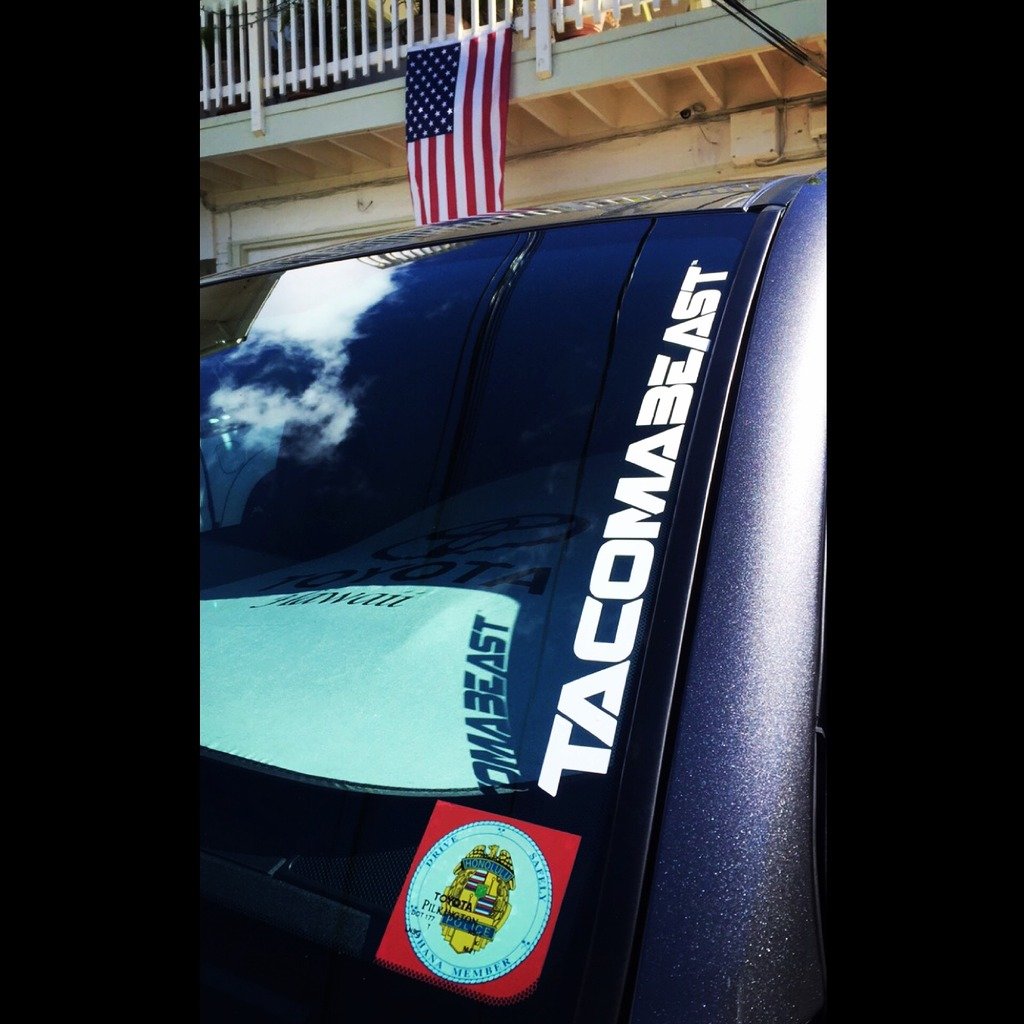

    Tinted the windows. 5% back and 35% fronts

    You know the higher past 5000K you go in HID's like that, the lower light output you get?

    Hi DJSPEC,
    Did you put HIDs in the Low and High Beams?
    Thanks
    Nice Job!

    Yes,
    Yes Matt I am aware. 6000k was my first choice but didn't want to wait so I got 8000k instead
    Thanks! HIDs heads, LED fogs

    VLEDS LED Low Beam Headlights, VLEDS High Beam LED Headlights, VLEDS LED Fog Lights, VLEDS LED Triton Turn Signals and Brake Lights, VLEDS LED Interior Lights, Reverse, Licence Plate Lights, Stainless Steel OEM Exhaust Tip, Leer XL Canopy, Bed Rug, Diablo Grill Logo, mattgecko Engine Compartment Lights and Bed Lights.
    How do the HIDs do as High Beams? It takes them a few seconds to warm up doesn't it?
    Cheers

    luckily, the 2016 3rd gens have separate low beams and high beams now. so my high beams are still halogen. and yes, the HIDS do take time to warm up, so they're not recommended for high beam usage

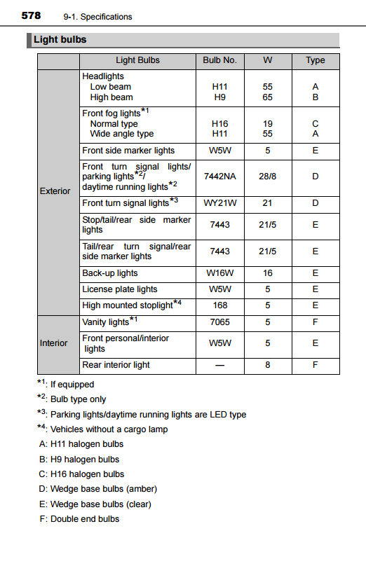

    I found the bulb size listings per the online 2016 owners manual: http://www.toyota.com/t3Portal/document/om-s/OM04005U/pdf/OM04005U.pdf
    the Fogs and low beams are both H11 bulbs! thank you toyota for making it super easy!! It's also very easy to change both fogs and low beam bulbs. they can be accessed right from the top of the engine compartment without unbolting anything.
