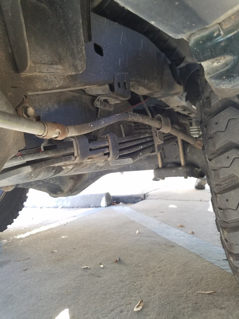

    Hey guys hope everyone had a good Christmas! Been awhile since I posted on here; I got some bad news so I loading my truck up with stuff I noticed my leaf springs were bending the other way. :confused: So I have no choice but to get new leaf springs.The camper shell by itself weighs about 200ish. Anyone know which leaf springs should I get? I probably haul about 1700-2000lbs every weekend for work.

    Well you have choices. You could do the Dakar OME heavy duty pack, All Pro expedition pack, or even a progressive 3 leaf AAL but that may or may not last. Any of these will mean you'll need new shocks as well. With the Dakars or All Pro's Bilstein B110's. With the 3 leaf AAL Bilstein 5125's

    I think Deaver and some other companies will custom make springs as well

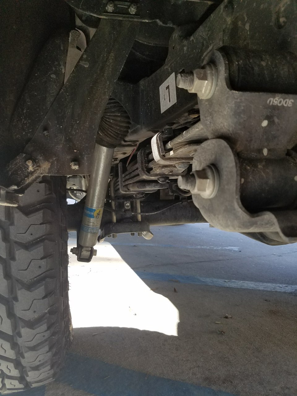

    I already installed the extended Bilstein 5100s back in March. Would they work? Are there any other parts I need in order to do this?

    If you order Dakars I believe you'll have to order the bushings and Ubolts as well. Honestly wait until after new year when headstrong opens back up and see what they offer. They usually will put kits together with everything you need. You could go ahead and Email All Pro or call and see what they suggest and/or offer. The shocks i'm not so sure about I believe they're not long enugh. You can clean them up and sell them to recoup some of your exspense

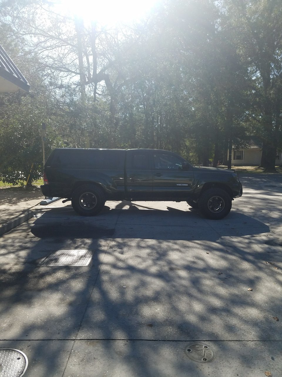

    Yeah so just get the medium duty springs? How bad is the rake when you first installed them? I only have the front lifted 2 inches.
