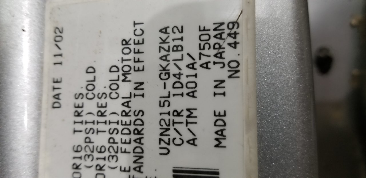

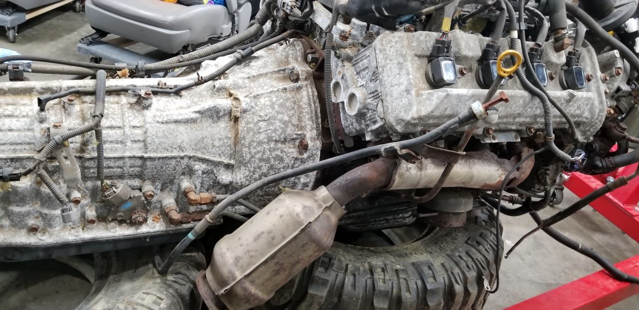

    Not sure about all of them but this one is from an 03 Limited T4r, the only one I have owned. Its definitely an A750F :cheers:

    Japan will slide shit in like that and then take it away and hope no one noticed. :D

    Fancy!! Wonder if the electronics are compatible with newer versions of the A750. I wouldn’t mind a dipstick on mine. The procedure we have to follow sucks!

    Holy shit, I was just looking closer at that engine/trans combo, toyota still put the starter in the back of the valley on the 2uz also!? :bananadead:

    Nice way to turn a 2 hour job into....4-5? I don't know.
    I'm going to have to start paying attention to sheet like this when ppl ask me to check out cars with them.

    Yeah my ls400 with the 1uz has the starter way back there too. Major pita. Gotta pull the whole intake and I ended up with some custom bent wrenches just to get the starter unbolted without pulling a motor or trans mount to gain more clearance. I decided since I was that balls deep in it, to tear the front end off and do the tbelt and water pump at the same time. Took a whole weekend, Friday afternoon into Sunday night.:bananadead:

    I had the wiring pinouts three phones ago, will be re-doing the research sooon. I have the whole donor 4runner and will probably use all the electronics from there.
