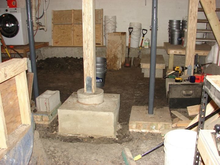

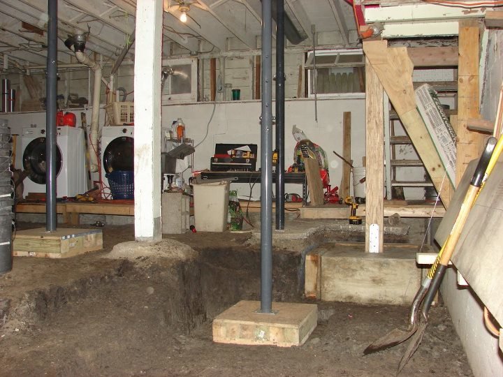

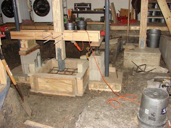

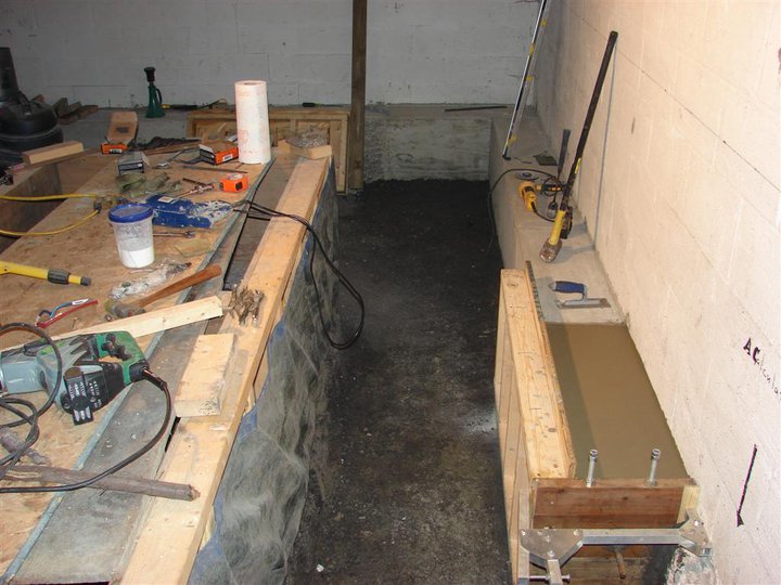

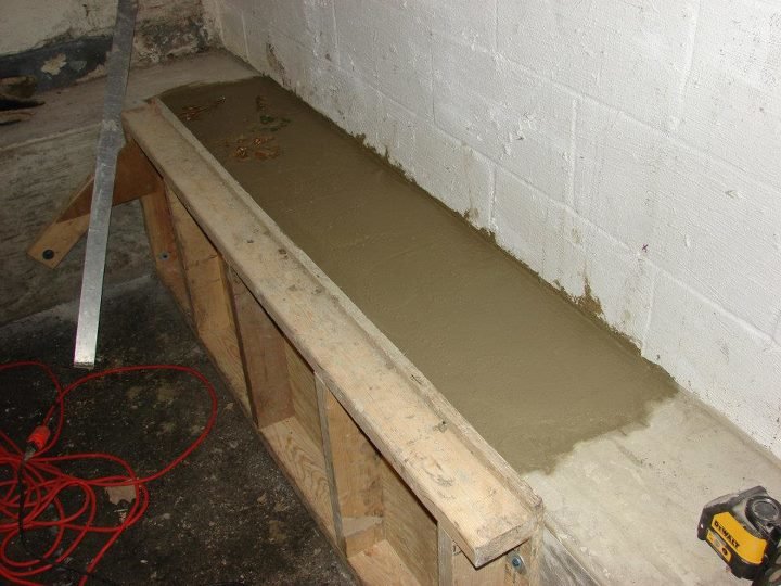

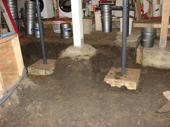

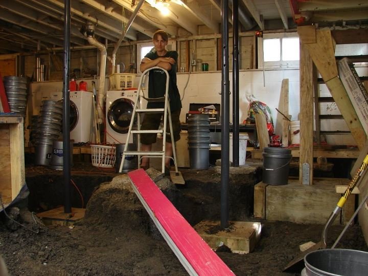

    I mentioned earlier I've just completed underpinning my foundation. I did this to increase my footing area, and to allow me to drop my basement floor about 8". I also have to put in new support columns and footers (2 of 4) are finished. So regressing, once the new dhw system is in, I'll remove my 1950's era furnace followed by knocking down my chimney, replacing the two remaining columns. Then install drainage, gravel, slab and perimeter insulation, radiant tubing then finally 6" concrete. I may be to ambitious for my own good, but it keeps me out of the bars......

    WOW! I've done some foundation work myself over the years, looks good, like the over-engineered footings

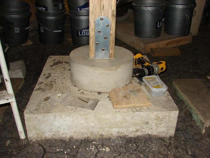

    Yeah I tend to over engineer most things, but hey concrete and rebar is cheap ;) Specially when you make it yourself. I settled up with my aggregate supplier recently for the rock and sand I used, don't remember the number of pounds, but I ended up with almost 13 cubic yards poured, and the bill for rock and sand was just shy of $300.....

    Thanks, I made the column footings 13" thick with rebar in the middle, the surface area is about twice what successfully held the house up for the last 90 years. So figured I should be good. The basement is 30' long, with three wood columns holding up the upper level. I plan to make the middle footing larger, probably at least 3' x 3' x 13" thick with lots of rebar. Then if I live long enough, I may come back in and put in an engineered beam to allow removal of the two outside columns to open up the floor space.
